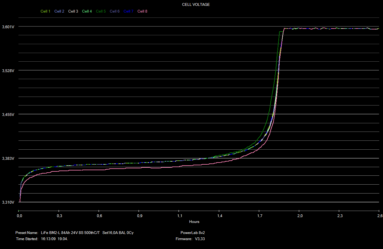

Postby Burgerman » 18 Apr 2017, 21:40
Cell 8 group, looks like theres a cable or cell or bolt problem somewhere. Why is discharge in 3 parts?
And on charge it looks inconsistent. Are you sure all the bolts are tight? The green line looks like you get with long cables or bad connections, thin charge wires. Or a pack split in two with extra connections.
Do another discharge/charge and watch. Lines should all be together or extremely close.
Posts: 70439
Postby Andrey » 19 Apr 2017, 07:41
Burgerman wrote:Cell 8 group, looks like theres a cable or cell or bolt problem somewhere. Why is discharge in 3 parts?
In 3 parts because I had to move the chair (also it is my only wheelchair for the moment), I was sure that all bolts are tight, but... now to be sure I have to check, for sure. Will do in next few weeks I hope.
Balance cables are 20AWG, could be too long, but not much, I will measure later exact length. Pack is single but there is extra connection, I use MPA charger board to connect the pack to the charger because I made XH-connector (maybe I will cut it off later to change for cellpro).

Postby Burgerman » 19 Apr 2017, 09:29
What about main charge cables? Balance start should be set to 3.500v not lower or set to balance at CV only.. Balance while discharge should be off.
Posts: 70439
Postby Andrey » 19 Apr 2017, 09:49
Burgerman wrote:What about main charge cables? Balance start should be set to 3.500v not lower or set to balance at CV only.. Balance while discharge should be off.
Main charge cables are 12Awg, I use your setup attached above (start at 3.50V), balance while discharge is off.
Andrey
Posts: 81
Joined: 17 Aug 2010, 17:50
Location: Latvia, Riga
Postby Burgerman » 19 Apr 2017, 09:50
Well theres something odd...

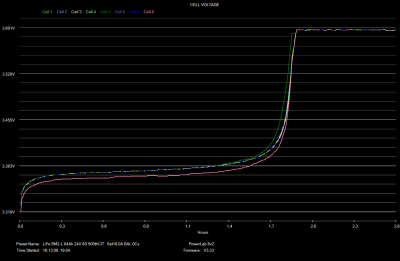

Postby Andrey » 19 Apr 2017, 19:38
And again, my today's discharge and charge (about 22Ah).
I understand that it is not good. But is it safe for cells if I use no more than 30-50Ah from 84Ah pack with such behavior?
It will take some time for me to disassemble it and try to find what could be wrong.
p.s. didn't attached graph file because it has overlimit size.

Postby expresso » 19 Apr 2017, 20:07
Hi Andrey - - i am going thru a similar situation and from that graph - it looks like you need to check the cells on group 8 - i had a BAD Cell in my group 1 - my graphs looked a bit better than yours and it turns out it was a BAD Cell for me -
at least so far as i can tell -
your taking a chance if you keep using it this way - it will work but can take the other cells down with it if thats your problem also - Wait for what BM suggests - i am always in the learning stage here
Postby Burgerman » 20 Apr 2017, 07:32
Are you building a new pack?
Did you test all cells and charge before assembly? Because you would have found a bad cell before this point?
Are you sure its not a long thin CHARGE cable issue?
If not then you either have a bad connection like a bolt that you have missed and that is not tight, or a bad cell, or something.
A bad cell or bad connection / loose bolt will show in a full discharge test, as group 8 will discharge and drop off earlier than all the others. So do a discharge test. Set to 2.9V, and balance off. It will take a long time. Or undo all the bolts and connectors on one end of the cells in group 8. And test those alone, and test with a volt meter for obvious failure.
And before any of that it possible but unlikely that the charger itself is out of calibration. So if you have a GOOD volt meter with 3 or 4 digits after the decimal place, you can measure all 8 groups individually as it is discharging to be sure that what you see on screen is real. Must be good to measure a couple of mV. The figure you see will be different to the actual numbers on the charger because the charger charges and discharges in a high frequency pulse with breaks. And it measures unloaded voltage where you will be measuring the average. So ignore the difference between charger and volt meter.
Yes its safe to use. Has it just started to happen or is it a new pack? Does the voltage of group 8 fall faster than the rest after charge, if you choose to monitor?
Posts: 70439

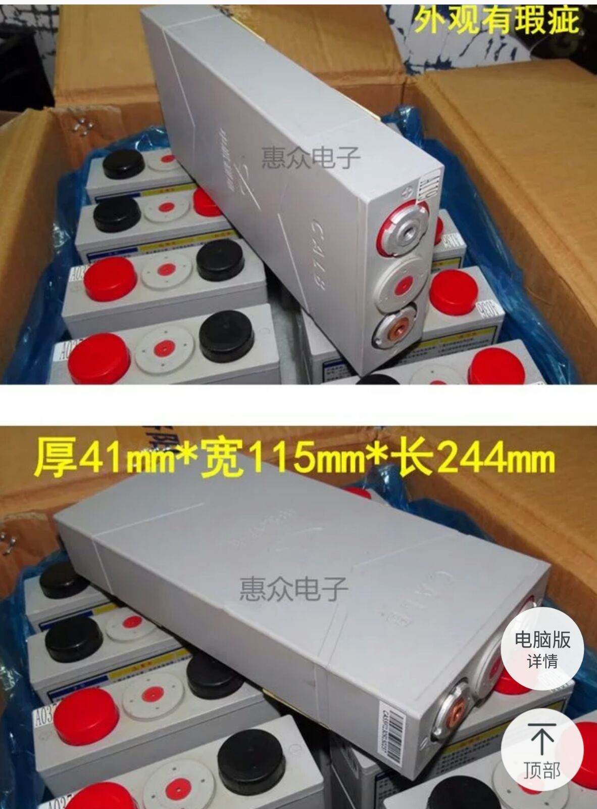

Do you have 2 X 115mm headroom for these 55Ah cells ?
Around @ £15.00 :D
Postby shirley_hkg » 20 Apr 2017, 09:21
This has total length of 275mm inclusive of terminals . Too bad . :x
Postby Burgerman » 20 Apr 2017, 09:24
Sadly not. All these cells are always just the wrong shape!
Only those 125Ah cells from sinopoly are perfect. But I cant find a supply.
http://www.sinopolybattery.com/userfile ... /125AH.pdf
http://www.sinopolybattery.com/en/products.aspx?cid=10
http://www.fdgev.com/en/sp_fa41255bm/
Need 8 of those. But dont speak chinese!
4 together, is 175 tall, 255 long, and 162 wide.
So correct height, 5mm less length, and 8mm less wide than a grp 24. Easy to fit 125Ah where a grp24 came from.

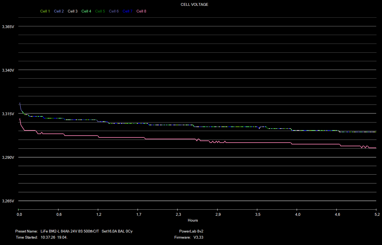

Postby expresso » 20 Apr 2017, 22:16
i got the pack together - BUT it dosnt look good at all - actually looks worse than before - not sure what the deal now :(
i am discharging it now - wont be done tonight - will continue to discharge tomorrow before a recharge
i did use Cell 25 instead of Cell 31 - for some reason i felt it was better - seemed to discharge and charge better - Cell 31 showed 3.3V today -
so i went with Cell 25 instead - maybe it was a bad call or they are both not good ? this worries me if the cells are going bad this way -
i wasnt expecting a perfect line at this point but wasnt ready for this wide a gap between them - what do you think BM - and whats the next step -
i dont feel this will fix itself
Postby Burgerman » 20 Apr 2017, 22:25
Dont know. You wrote many words, but no idea what you are describing.
You reassembled the pack.
You fully charged and tested those 7 cells. You now have 7 good ones. And all connections are also tight.
And then you fully charged the pack.???
Correct?
And now discharging? The screenshot?
If so you didnt do some of the above correctly...
Or you didnt charge it yet??? Or is that chart just monitoring?
Not enough info. You MUST charge and balance the pack before discharge.

Postby expresso » 20 Apr 2017, 23:05
OH -
I put it all back together and then connected to the PL 8 - and monitor - - that screen shot was a monitor before i did anything at all -
now i am discharging it - i may have a chance that it will fix itself - ?
all screws were checked - all of them - i used new screws on the cells i removed them from - replaced the bad cell - to best of what i know - i believe i did it correct -
i did not charge it fully before i started the discharge - i thought i had to discharge it first -- then fully charge balance it - then discharge it again and repeat a few times ?
its a hour in the discharge - should i stop it - charge and then start discharge again or just leave it now ?
Postby Burgerman » 21 Apr 2017, 00:00
OH -
Stop discharging it will accomplish nothing useful yet!
Charge fully. When it stops, do it again half a dozen times so we know its properly balanced. (or as I said in a previous post that you ignored) set termination to a LOW level so the cells balance properly. Read back!
Set termination to 500th or 1000th C and for 3.65V for this one charge to correctly balance everything. 1000th C means 105mA on a 105Ah pack. Set anything between 200mA and 100mA. THIS charge ONLY! (150mA good choice)
It will hold all your cells FULL for long enough to ensure that the whole pack is fully balanced.
Then and only then, monitor it. And if that looks OK, then do a discharge test. You will likely find that swapping that one cell means its fixed!

Postby expresso » 21 Apr 2017, 00:41
Ok i changed the charge to 3.650V - term. 150mAh - and started the charge - for this charge only - then change it back to 3.6V charge and Term. was 200mAh - or leave it this way for the first 4 or 5 recharges before putting it back to the way it was ?
sorry i misunderstood the steps
Postby expresso » 21 Apr 2017, 01:33
first charge - now will set it back to 3.6V and 200mah term.
Postby expresso » 21 Apr 2017, 03:14
ok after 6 charges - the graphs looks OK for the 2nd charge up to the 6th - then i monitor it - and i dont think its holding up -
i will start to discharge it till i go to bed - then start again in the morn. and do a recharge - then a monitor again - but i dont think its going to fix it -
looks like i have to take it apart and replace all 7 Cells to be on the safe side - ?

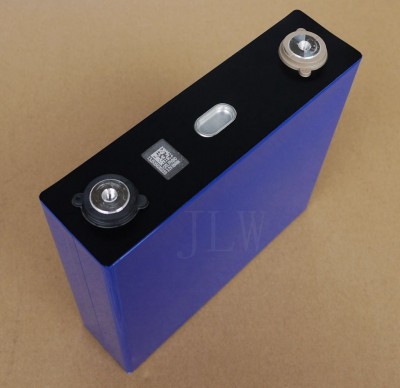

Postby shirley_hkg » 21 Apr 2017, 03:20
Found one similar , 100Ah rated 2C , tested @98.5Ah .
@ £25.00 ;)

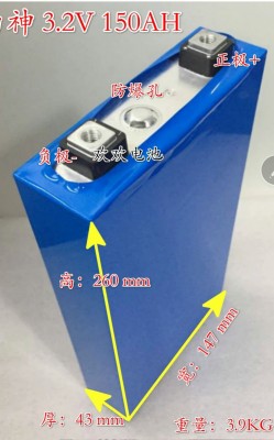

Postby shirley_hkg » 21 Apr 2017, 03:46
:D
Found this too , and think you'd give it serious thought .
Look at the super low internal resistance , and tested capacity .
I'm quite confident that you can fit 16 of them in it , and that's 150Ah .
Should be good stuff . 0.36mOHM @ 2.65V That's really good , itsn 't it ?
@£17.00 :lol:
Postby Burgerman » 21 Apr 2017, 06:53
1st one ok, but prefer the 125Ah one.
2nd one too tall...

Postby Burgerman » 21 Apr 2017, 06:55
Expresso, charge all, remove connections on all 7, replace the cell that falls lower... You dont need replace any that are ok.
What maybe happened is that one bad cell allowed all those to go lower in charge in that one group last summer.
