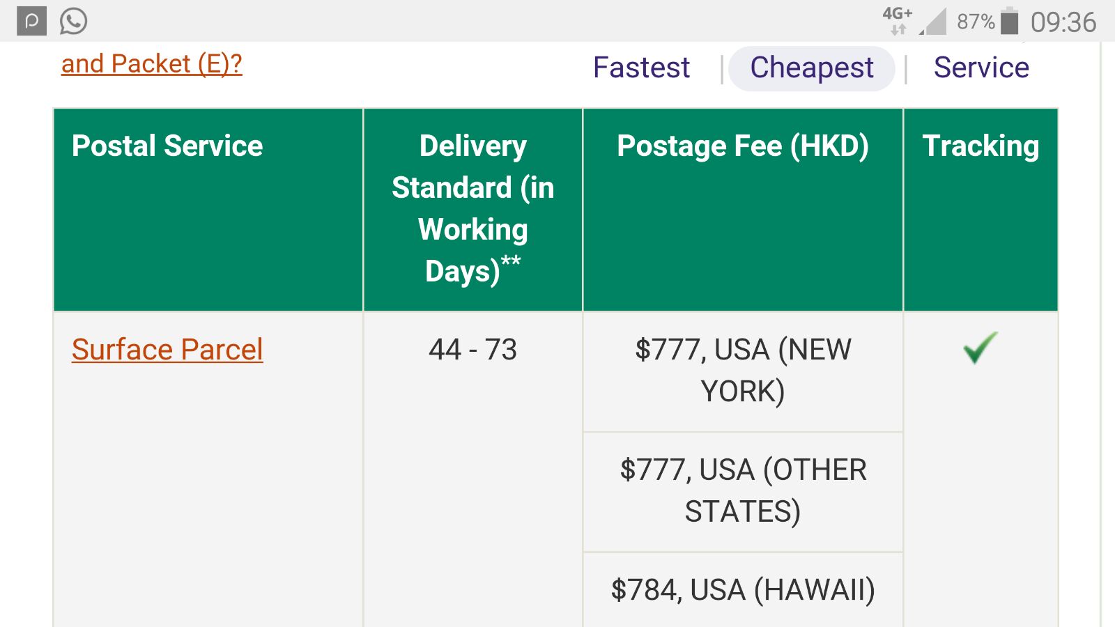

This is 18kg for 8 cells only @$HKD
Postby ex-Gooserider » 25 Apr 2017, 02:52
Worth noting that the biggest difference in price I found when shopping for batteries was in shipping cost - I specified delivery to my house in MA within 10 business days or less, and everyone's quote at least claimed that - but the shipping charges varied by over $500 for the same goods...
$700 is on the VERY high range of what I got for quotes, especially for 'slow-boat' post...

ex-Gooserider wrote:$700 is on the VERY high range of what I got for quotes, especially for 'slow-boat' post...
Unless I'm mistaken, Shirley is quoting HKD, not USD. Unless I'm mistaken, the HKD/USD ratio right now is 7.78/1, so not so bad.

Postby shirley_hkg » 26 Apr 2017, 04:15
Sadly that's the best I can do . :(
Seller asked for US$450.00 for shipping 16 cells to the USA .
Postby Gnomatic » 26 Apr 2017, 16:08
Yeah that's about the same shipping quote they gave me - so shipping would cost as much as the batteries.
Its still a decent deal *if* the batteries are as advertised. But not quite as appealing as before.
