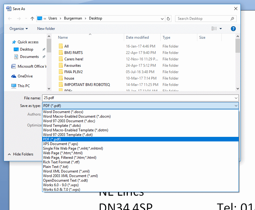

Cant that program save as a word .doc or rich text file .rtf or even as a pdf file? Then normal users with modern industry standard software don't need to go through contortions to try and read it.
EG In MS Office, word, I can save as:
