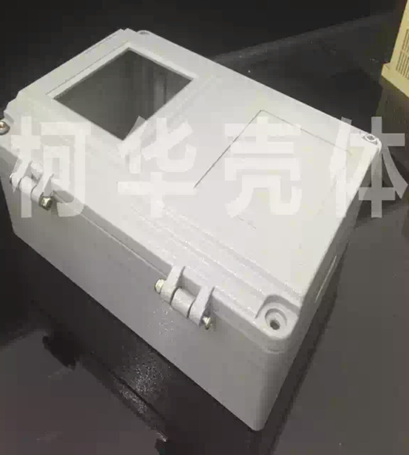

;) Couldn't we have better choices of boxes ? :lol:

Postby Burgerman » 12 May 2017, 10:10
Come with seal? To keep explosion in?

If you can find a box that suits your needs - and fits - anything can work - the box i found is the best i find around here - closest to the size i need - without trying 40 different stores -
the boxes you show there Shirley would work fine - finding those is another story - if you have a direct link to purchase those boxes - that should work fine -
14 inches long is Min. to fit just right - if 15 inches - i can made it fit in the Bag - 10 inches high is nice to cover the whole Cell and 7 or 8 inches wide for 3 Rows of 15ah cells
i have not been able to find this size online searching google - not sure what i am googling - plastic box ? or Mens plastic shoe box is actually the one i am using - i find many - too large - too short - too wide - -
