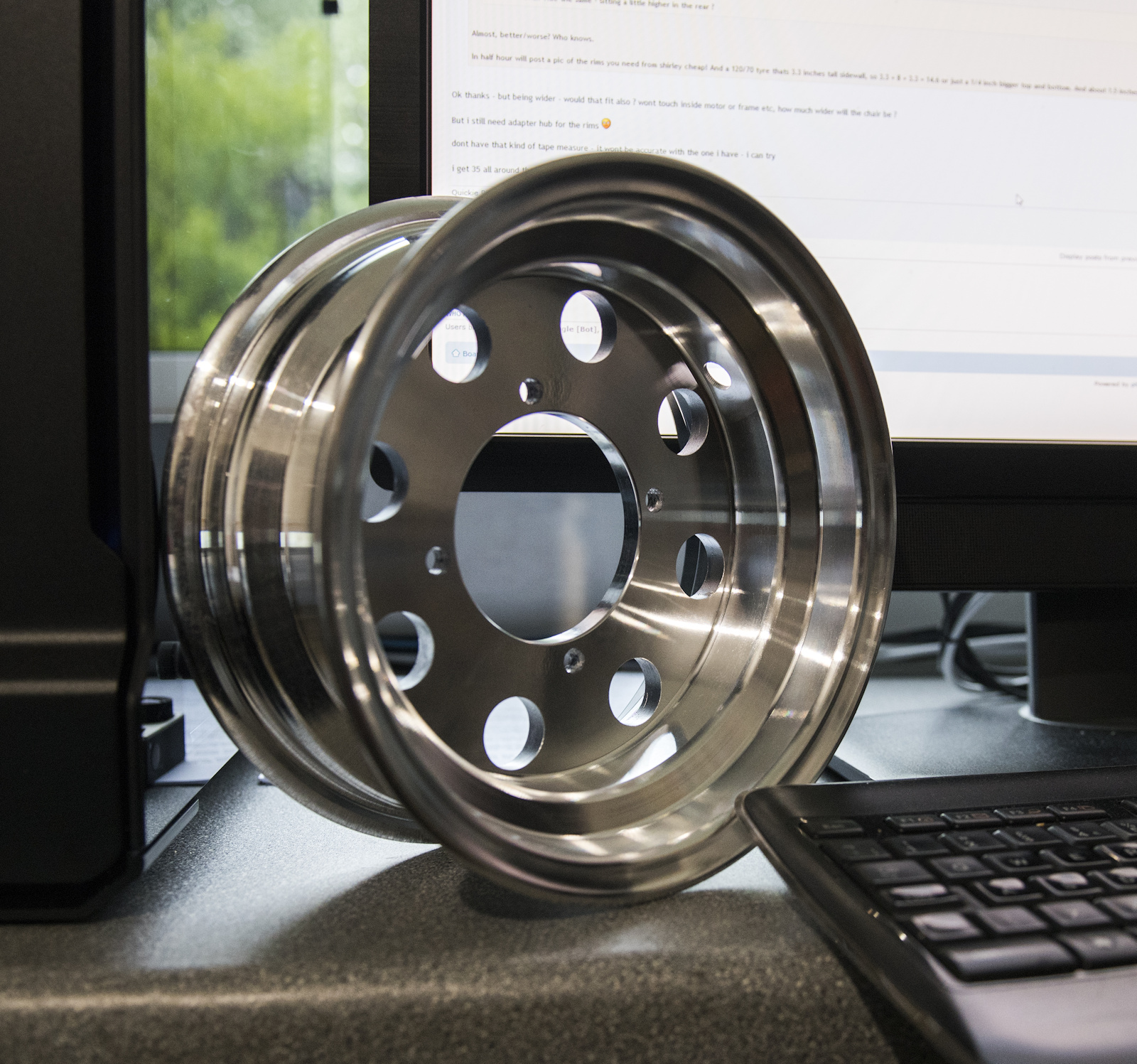

THIS is an 8 inch rim. Its a true tubeless safe strong rim, so can use a tubeless tyre. You will be able to add a tubeless sealer and a strong motorcycle road tyre. Chances of a puncture are somewhere between zero and extremely unlikely!!!
It is 3.5J meaning its the correct width for these tyres:
Duro tubeless, 110/80 or 120/70.
The 120/70 is just 14.5 diameter. And is wider, so looks better, and rides better, and grips better. And wears slower, and is less likely to sink on grass. This is 1.5 inches wider than your 3.00 tyre. It will make your chair 3 inches wider.
The 110/80 tyre is 88mm sidewall (so a little bigger but still less diameter than your 3.5 tyre is very slightly. It will make your chair 2 inches wider. (One each side).
Neither will hit anything as you just add washers if the wheel is too close to the motor.

Postby expresso » 19 May 2017, 22:25
those look great - cool etc, - but 3 inches wider - too wide for my chair - its already 25.5 width and i feel it going from the 222 chair at 24 inch width to this chair - i feel its a bigger chair -
dont think it will look good that wide - - one inch maybe not too bad -

maybe the best size rim is a 2.5 for me tubeless - with a tire that is not taller than 15 inches overall -

the Rim maybe i have to stick with 2.5 inch - and use 110/80 tire - if its 14 to 14.5 inches maybe its the best choice tubeless is fine - great - i just need someone to mount without scuffing up the rims -

Hey Shirley - Look what i found - would this be what you would need to make the adapter for a new tubeless rim ?
i never though of looking for it on the website - went to check for washers and noticed the wheel hub -
https://www.quickie-wheelchairs.com/rep ... -s636-s646
#5
i could buy just one of these and thats all you would need ?
went to look for washers and found the hub instead :)
Re: 3.5" tubeless tires
Postby shirley_hkg » 20 May 2017, 05:00
:D Yes . I can make 2 for you to fit the tubeless rim that BM just posted , if I could have one for reference .
Posts: 4653
Postby expresso » 20 May 2017, 16:03
shirley_hkg wrote: :D Yes . I can make 2 for you to fit the tubeless rim that BM just posted , if I could have one for reference .
OK then - i will order this Hub - i need just one to send you ? and then when you get a chance - look for some rims etc, - now i am not sure i want to go too wide - because the chair may look funny at 28 inches wide -
2.5 inch rim ? if there is a 3 inch maybe - but i see only 3.5 inch - when we get to that point - we have to figure it out and find a few - but it would be plug and play afterwards ? i would just take the new rim and bolt it on my chair -
nothing for me to drill or do - i wont be able to -
i will give the tires i have here a shot - take a gamble and see what comes of it - its either going to work - or i lose the bet and ebay them for half cost - i think i will send in my front tire to get a tire liner for that one at least - makes me feel better in my head :)
Thanks - curious to see how this will end up
Let me ask you this shirley - Would you be able to order this part for me there ? then i wont have to ship it to you - i can PM you my chairs serial number if thats needed - Let me know if not i will order it here then -
Postby expresso » 20 May 2017, 16:27
Just an though now that it may be possiable to do a tubeless rim tire combo once the hub is sorted out which i can get now for Shirley - i wonder if i should just Abort what i doing now with the current tires i have and just wait for the new rims tubeless set up - most likely wont be all sorted and ready till some time next year - :idea:
another decision now i have to make :|
Postby shirley_hkg » 21 May 2017, 03:20
Actually , I can access a 646 2-pole model here, and can take the hub away for a while , to accomplish your project ! .
However , I am not sure if it were the same as yours .
Could anyone confirm this ?
