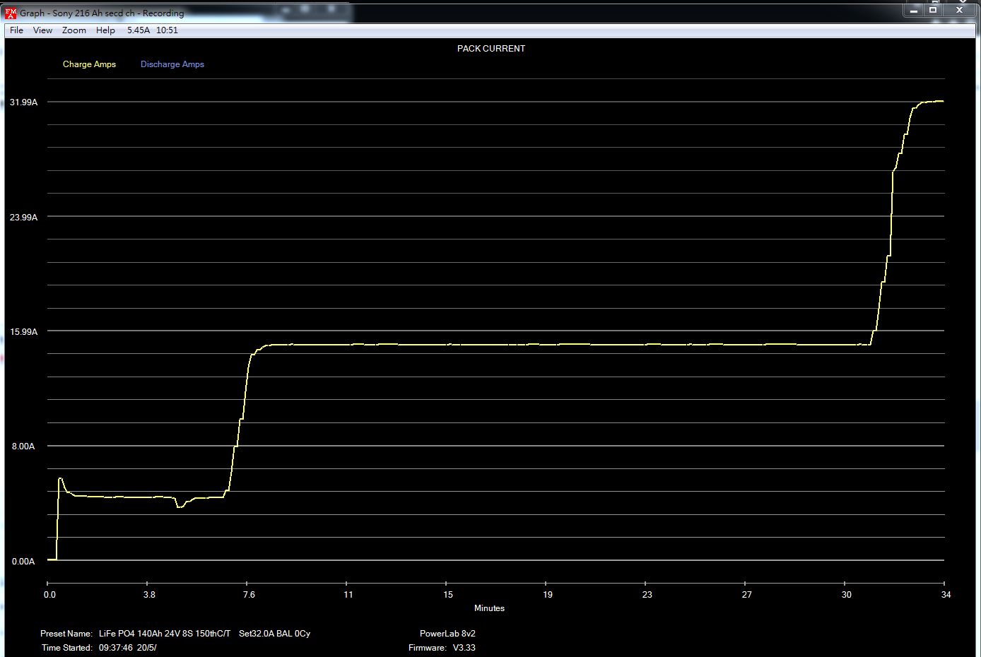

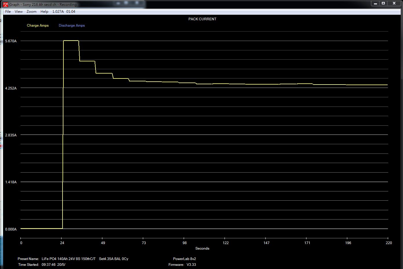

Postby shirley_hkg » 20 May 2017, 05:23
shirley_hkg wrote: BM , would you please include the followings in your suggestion list to REVOLETRIX
1,more balance starting points
2,Soft start for all charge current ; for sake of power supply and initial charging for deeply discharged cells . ( now I enter low charging rate in preset and change to higher amp after start . It then increases at around 0.5A steps . )
PL8 seems quite incompentent at start up . :(

Postby shirley_hkg » 20 May 2017, 05:26
Increase to 32A at two tiers .

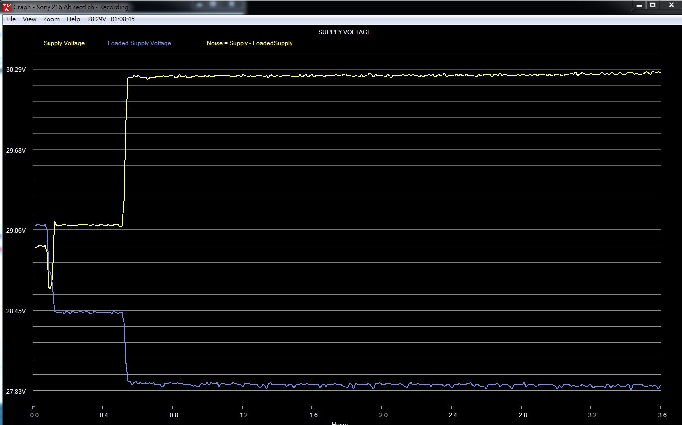

Postby shirley_hkg » 20 May 2017, 07:31
What is that ? Power supply end is solid @28.5V .
Posts: 4656
Postby Burgerman » 20 May 2017, 10:24
I have never seen that. Mine shows just a few tenths of a volt, loaded/unloaded. Because:
Your supply voltage varies by several volts on and off load. Its not very well stabilized at high switching frequency. The charger is monitoring it at high switching frequency, your volt meter will never show this. Mine does but it wasn't cheap! Which leads to this:
Its instability is caused by your power supply voltage partly, and made worse by the close to battery voltage chosen for the supply.
The problem is that it uses two different types of inverter internally. A buck, and a boost converter. If the battery voltage crosses the power supply voltage as charge begins, it has to swap over. If the power supply voltage is above the battery voltage as yours is at start, it uses the buck converter. To lower the voltage. The moment it does this, the battery voltage rises up due to internal resistance, or cables resistance, (and your loaded supply drops) and it then has to try and switch from the buck part, to the boost converter. (that increases voltage from input to charge output).
As it does this, it takes a finite time. And the battery resistance lets the volts drop again... So now it needs the buck again... To stop it oscillating between these two inverters, it bumps the current (and so the voltage) higher very rapidly to move voltage up, or charges slowly for a while to introduce some hysteresis and to try and keep itself away from the transition or swap over voltage. The loaded/unloaded supply makes this worse for the charger to control.
The easy solution is to use a slightly different power supply voltage set to say 24V or lower, or 29V or greater. Even a small change may do the trick. Or even thicker / shorter battery charge cables. Then it will start and rise smoothly. https://en.wikipedia.org/wiki/Buck%E2%8 ... _converter Change this supply voltage or improve the stability of the supply and your problem is gone.
The hard spot is when the battery voltage is just below the swap/switch over point because of power supply voltage level/battery voltage level increasing as charge begins. So the thing to avoid is where supply and battery volts are close. Especially, exactly where yours is set!

Postby LROBBINS » 20 May 2017, 10:53
Another possibility might be to add a large capacitor across the power supply - say 500 uFd, 100 WVDC, but you would then have a charged capacitor to contend with when you disconnect the power supply from the charger.
Postby shirley_hkg » 20 May 2017, 13:25
Changing from 29V to 28.4V this afternoon , was a wrong move then .
Will go back to 29.5V to stay away from that switching point .
Thanks .

Postby Burgerman » 20 May 2017, 16:57
Should help. But remember that on load, your supply falls a few full volts! (that loaded figure). So setting a higher frequency conversion may help here but is less efficient.
Not sure what yours is set to. I usually set 62.5.
But there are 3 options.
The figure it allows you to choose depends on the charge current. Why? Because higher frequencies allow smaller components, at big amps. But lower efficiency and more heat. But its easier on the power supply. And low frequency allows better efficiency at lower currents. so 31khz is more efficient below 20A, but needs bigger components at high amps and will show bigger gap on your supply. So it will limit you to 20A max or will show error..
Options are 125, 62.5, and 31khz. Choosing a higher frequency may help your power supply not drop as low under load. If the settings for charge allow it. Try setting 125khz. But the charger will then waste more energy and not like it at high amps, and may lower the charge current if it detects its getting too hot...
Better to have a more stable supply, or set a lower voltage like, 24. Still at least you know what is going on! I hope I have not caused your brain to smoke!
