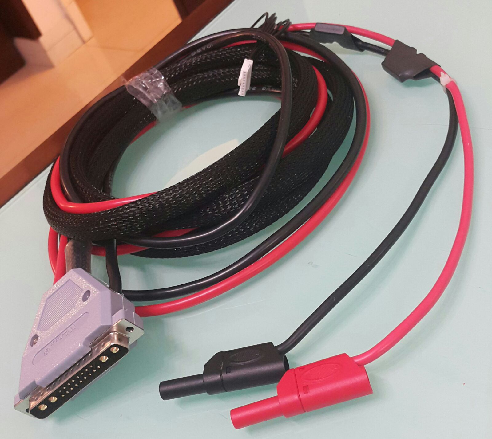

66 inches , longest I ever made . Hope no problem .
Posts: 4569
Postby expresso » 12 Jun 2017, 14:48
nice cable - you be fine - thats the reason you doubled up on the balance pins for each wire - better IR - you used 10 AWG cable for the power leads also on the connector end ?
why did you need it so long ?
Postby steves1977uk » 12 Jun 2017, 23:23
The reason to keep the cable as short as possible is there's less voltage drop, but of course you can overcome this by using thicker wires or double up like Shirley has done. :)

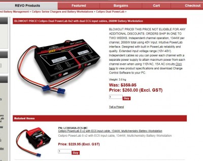

Could it be restored to 2 PL8 ?
Posts: 4569
Postby steves1977uk » 18 Jun 2017, 11:36
Don't think you can restore the PL8's presets to DPL8, although it might work since its just two PL8s in one unit.
Postby Burgerman » 18 Jun 2017, 13:47
No its not.
Its got no charge via the balance ports alone capability, (FMA wiring mode) and uses different connectors. Also has different input voltage range. So different firmware, different software, etc as well as different electronics.
Posts: 70490

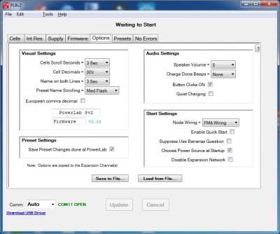

In the PL8 control software, I went to the "Options" tab. I don't want the charger to beep when its done charging while I'm sleeping. So I set Charge Done Beeps to None.
Is that sufficient?
I see a Quiet Charging option right there also. Does enabling that setting mute the charger entirely?
