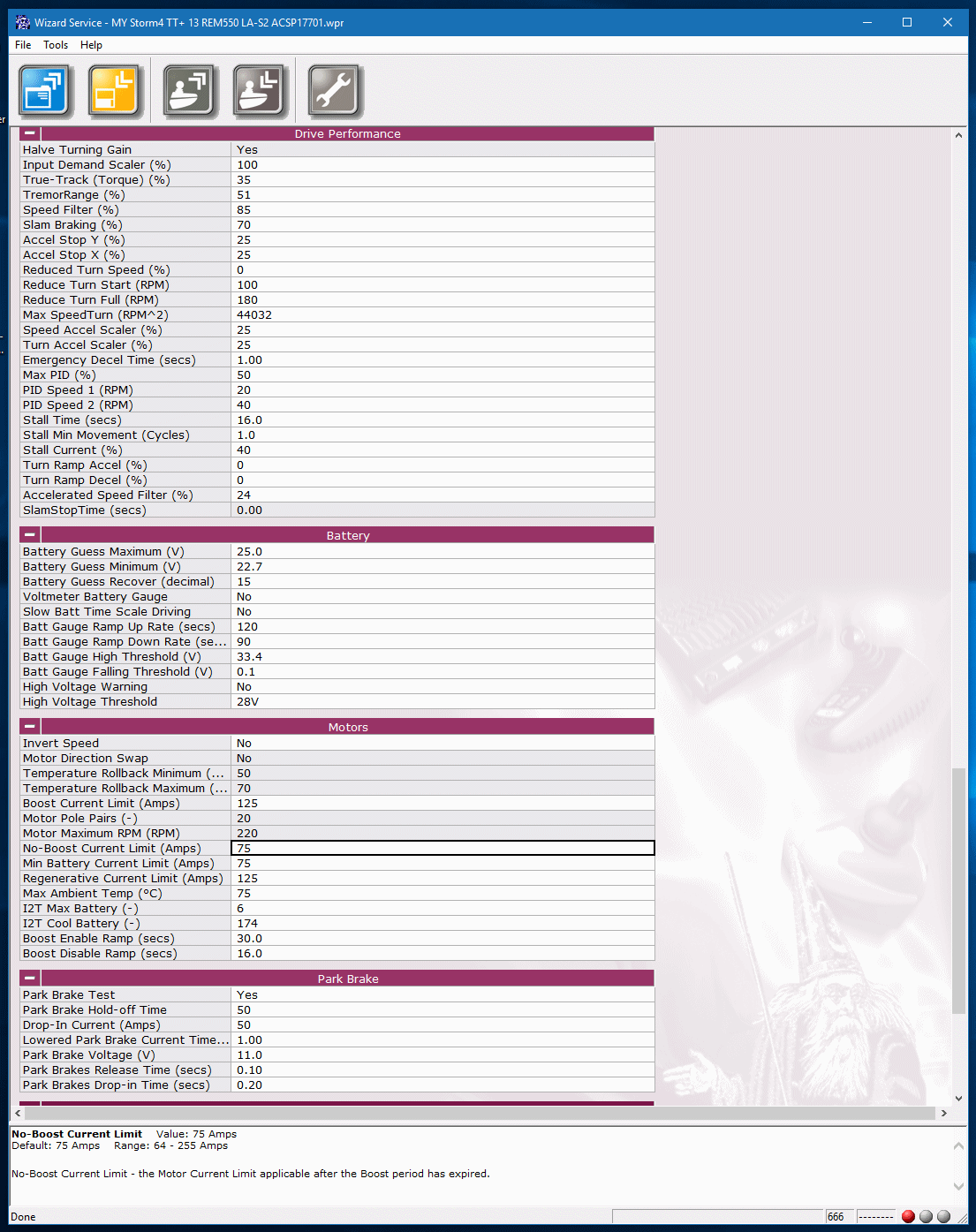

Postby Burgerman » 05 Jun 2017, 16:43
Must be something here that will allow me to fine tune!
Wont touch any of these till I speak to Dynamic or invacare. These are over and above OEM level. But theres one I really don't understand. Ambient temp? Theres no temp sensor in a wheel I think, so its case temperature of controller?
Posts: 70440
Re: New chair!
Postby Burgerman » 05 Jun 2017, 16:46
No-Boost Current Limit Value: 75 Amps
Default: 75 Amps Range: 64 - 255 Amps
No-Boost Current Limit - the Motor Current Limit applicable after the Boost period has expired.
Suspect setting this to 100A will cure a lot of the unpredictability...
And setting temp rollback higher...
Posts: 70440

Postby Burgerman » 06 Jun 2017, 01:52
Thats way beyond oem! Oem is intended for pride/sunrise/factory use etc. This is beyond that/them. This is really for the likes of Dynamics Controls development guys. Allows you to change some really interesting things.
One bit you might find useful, is the section on BATTERY. Have a read! You can configure it for lithium if you want. As you roll the mouse over the field, and the figure, the explanation and help appears at the bottom. So its actually quite simple if you understand whats going on.

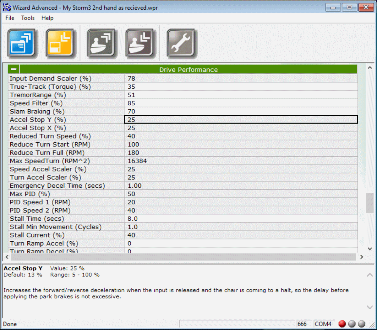

Postby Burgerman » 06 Jun 2017, 02:29
Shirley this may also interest you.
This is the settings for my 10kph 6mph Storm 3... And is only in OEM mode. The difference is that in OEM level you can see all the same settings, but cannot change them. They are greyed out. Most here are grey in OEM.
We can UN-grey them!
Now, the only difference in top speed between the 6, 10, and 13kph versions of brushless chairs appears to be the setting called: INPUT DEMAND SCALER. see below.
On my 8mph (13kph) version it is set to 100.
On my 6mph (10kph) version it is set to 78.
On the 4mph (6kph) versions presumably its set to a lower figure still.
So if your chair is slower than 8mph you can speed it up.
Also see the ACCEL STOP X and Y fields. These speed up the "stop" after you position a chair by an inch say. You let go and it stops faster. Also interesting to make it more easy to drive indoors... There are similar ones that do the opposite.

Postby shirley_hkg » 06 Jun 2017, 02:49
You mean your 10kph STORM 3 is leashed , and now you can unleashed it to 13kph ?
WOW . That really amaze me .
Your last point catches my attention too .
Here people using MK 6i models are complaining that their chairs stopped with a few more inches forward rolling , even when they release the stick at a crawling pace .
Seems this parameter can solve the problem , itsn't it ?
Re: New chair!
Postby Burgerman » 06 Jun 2017, 09:38
Yes. If set higher it stops fast, the last few inches. But less smooth. Read the info in the box at the bottom. Set to 100 it stops dead as you release stick last few inches. Very sharp!
