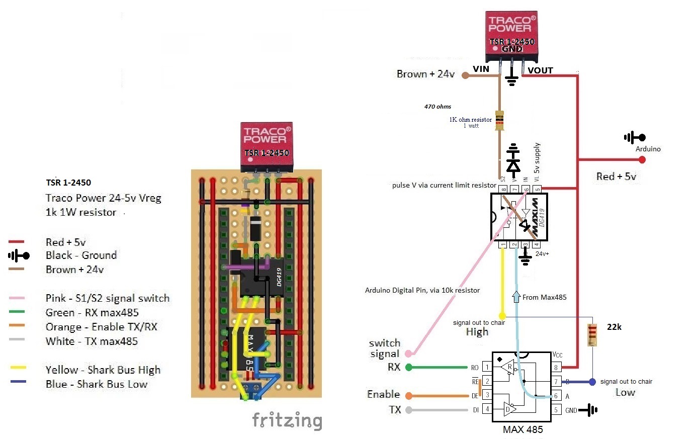

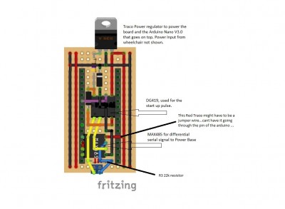

woodygb wrote:You need to replace the 7805 with a Tracopower TSR 1-2450 and feed it 24v.... the Traco is an All in One....so the caps can go.
http://au.element14.com/tracopower/tsr- ... dp/1696320
I think that there is a 10k resistor on the feed to D3 and the resistor value across A-B is 22k.
Sounds about right, i will get the board out tomorrow and check the values i used.
I added the Cap to the output of the Traco Power reg to provide a bit of a buffer during the pulse power on.
In testing i was getting random brown outs.
And the idea being that a person could have the DG419 / RS485 board stick a nano on top and interface any thing they wanted.
eg. A Ublox GPS to drive the chair autonomously.
This is not finished but its all i have at the moment, missing are the traces for the power to the inputs.
There are also 1 too many pins on that header for the Arduino Nano
I was thinking it could be like one of these nano prototyping boards but with out the pin headers so that people can populate it as they need.
And 24v input via the Taco Power Reg instead of the power supply bits on that board.

Confirmed, R3 is a 22k resistor.
I dont have the 270ohm resistor and it works, nor do i have the chair set to go to sleep at the moment.
For those that have not seen my new towing machine using this code/board.
https://www.youtube.com/watch?v=RP0mHbw7hyU
The SBH wire is pulled down to zero volts by 270 ohms in parallel with 22k ohms at the SPM and the SR (The 270 ohm terminations switch off when the bus voltages rise above 8V). This is the "recessive" state and it represents a 1. To transmit, modules pull the wire to 5V. This is the "dominant" state and represents a 0. Note that the transmitting circuit will not achieve 5V; 4V is more likely.

I will update this picture with the value for R2 in the morning
My code doesn't reflect the Purple Trace for the pulse trigger, that was an afterthought to make the board neater.
The two Diodes to the DG419 are for if the DG419 starts up before the Arduino...or the other way around, voltage spike protection either way.
And the surge cap on the 5v lines is not shown as that was added after i built this up, to deal with random brown outs.
At one stage i was using this board to drive the receiver for a Wii Remote version and getting brown outs due to the power draw....i might also have been using a LM7805 but they burned up really fast :oops:
It cant hurt to have it, protection for what ever people plan on adding.
In the video i am using PPM with standard off the shelf RC receivers.

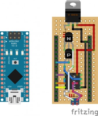

I drew this for myself sometime ago using your info..
Re: Arduino controlled wheelchair
Postby gcebiker » 04 Jul 2017, 14:25
Ah yes, a 1k 1W for R2 i just found the original of that drawing.
Also found a drawing i did that is Wrong and did not work but at least you can see where the Arduino Nano v3.0 pins go.

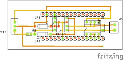

Ok, first crack at auto-routing the traces using Eagle CAD looks like they may be accomplished with a one sided board (cheaper to produce)..
if you want the unused pins of the nano extended out with some extra holes on the board to access them, then it will have to be two sided.
It's worth a couple of iterations to get what you want out of a finished board.. so I'll work up a couple of variations for you to review as time permits.
Both the Traco 1-2450 and 7805 are rated at a max of 1A output.. you say the 7800's were cooking.. perhaps lack of a heat sink on the TO-220 package..
any idea what the current draw of your board is?

It looks like the MAX485's RO,RE, DE, DI, are connected to D13, 3v3,Ref, A0 ?
They need to be connected to the Digital Inputs of the Arduino, i know the Arduino pins can be remapped but i was also hoping to keep the coding required as simple as possible for ease of use.
Please forgive me, this is more than i was ever hoping for and so fast.
The schematics i did up reflected the physical board i made up, limited by hard wiring jumpers that took up more space than traces.
Ive never done up a picture like you have and had no idea the traces could be so thin as to pass between the Arduino Header pins.
For a production run and for maximum flexibility
I was hoping to keep
SS - D10
MOSI - D11
MISO - D12
SCK - 13
I2C pins
SCL - A5
SDA - A4
Hardware serial
TX/ RX
Free for inputs.
The 3 pin header rows were to be the same as RC Car Servo leads, Outer GND, middle 5v+, inner signal (relative to Arduino) .
It looks in the picture like the blue trace connects all three pins on the input headers ?
U8 - 22k the RS485 terminating resistor looks very big ...and would touch the Cap on the input voltage ?
Its only a standard resistor.
U10 - the 1K 1W resistor looks to have enough room, (the current limiting resistor for the 300ms 24v ON pulse)

Postby gcebiker » 05 Jul 2017, 10:57
sirmike, is there a file you can email me ?
A file i can open with the editor and tweak ?
-The cap on the 24v line (C1) is not needed and some of the traces around there don't seem to meet up with anything.
-C2 needs a bit more room,
-IC3 could move up a bit to make room for C2 which also needs to move up a bit.
-If IC3 were then moved a bit to the right there might be room for R2 to be rotated 90deg making room for
-D1, IC1 , D2 and IC2 to move up a few pins to free up D12-D10
My email is ammatthews@gmail.com
I know fluffing about with these small changes can take up more time than doing the board in the first place, having done some not for profit websites for the disabled sailing groups.
I could then email it back to you for double checking and if you say ok, i will order the first batch from Dirty Cheap PCB's make them up and test.
...i have quiet a few IC's and Arduino's kicking around still.
If i get a working one i will then post you one to test on your own chair.

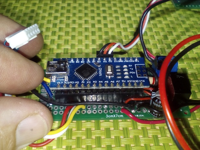

This is the current board i am using, its wired to accept Analog Joystick inputs or PPM from a RC receiver.
The white JST plug is the Joystick input plug.
I also realize now that i used 3 digital pins to accept the PPM inputs and this would limit how much the chips can be moved up.

I guess this EAGLE ? picture is not to scale, maybe there is room for the Cap on the 5v input.
Certainly it seems like the DG419 and RS485 chips are quite big.
There are 5 pin spaces between the headers for the Arduino Nano.
Better view of the RS485 chip, which i would move left by one pin to free up the SS, MOSI, MISO pins on D10-12
The USB plug is on the right hand side so that the board could be tweaked while connected to the Power Chair i am sitting in, the logic Analizer and the Arduino IDE.

Postby gcebiker » 05 Jul 2017, 16:09
I've not got it quite right but this is where i am up to so far Mike.
Blue is bottom track, Red the top track.
