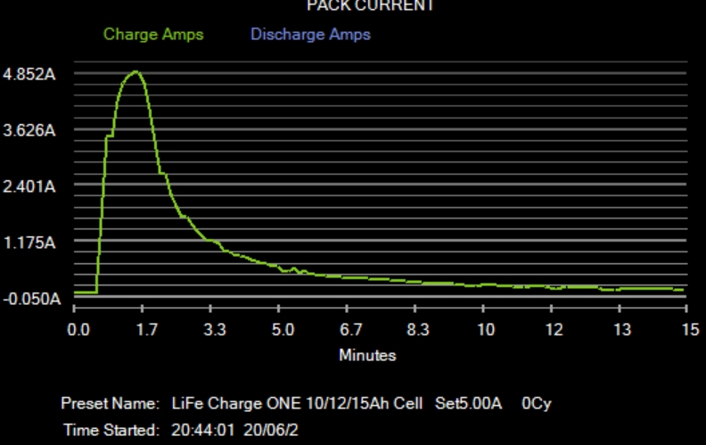

Re: Step By Step 30ah Pack build with pictures
Postby Dan » 20 Jun 2017, 20:07
Another couple of dumb questions. How do you when a cell is charged and what input voltage are we using on the PL8?
Dan
Posts: 573
Joined: 10 Nov 2011, 03:03
Location: Northern Ireland
Postby Burgerman » 20 Jun 2017, 20:31
Any voltage between 10 up to 30V input. Depends what power supply used.
When done? The presets that are user adjustable define the termination point. Its DONE when current falls to whatever mA level is specified. And then the graph stops and your PC screen tells you its done.
Posts: 70459
Postby Dan » 20 Jun 2017, 21:11
Thanks again for being so patient. I think each cell had been maybe charged to about 70% capacity.
Cell 1
Dan
Posts: 573

My next big question will be how do I fit it to my chair? Its going to be a Invacare storm 4 xplore. I will want to be able to charge them together.
Dan - your going to make a 30ah Pack - look back from Page one here - i have pictures - you can follow them - it will show you how to arrange the Cells - attach the balance wires etc, -
when you say a BIT - what does that mean - Did you charge each Cell with the PL 8 Full and left them ALONE for a MONTH or TWO ? at least a MONTH is fine - before you continue ?
