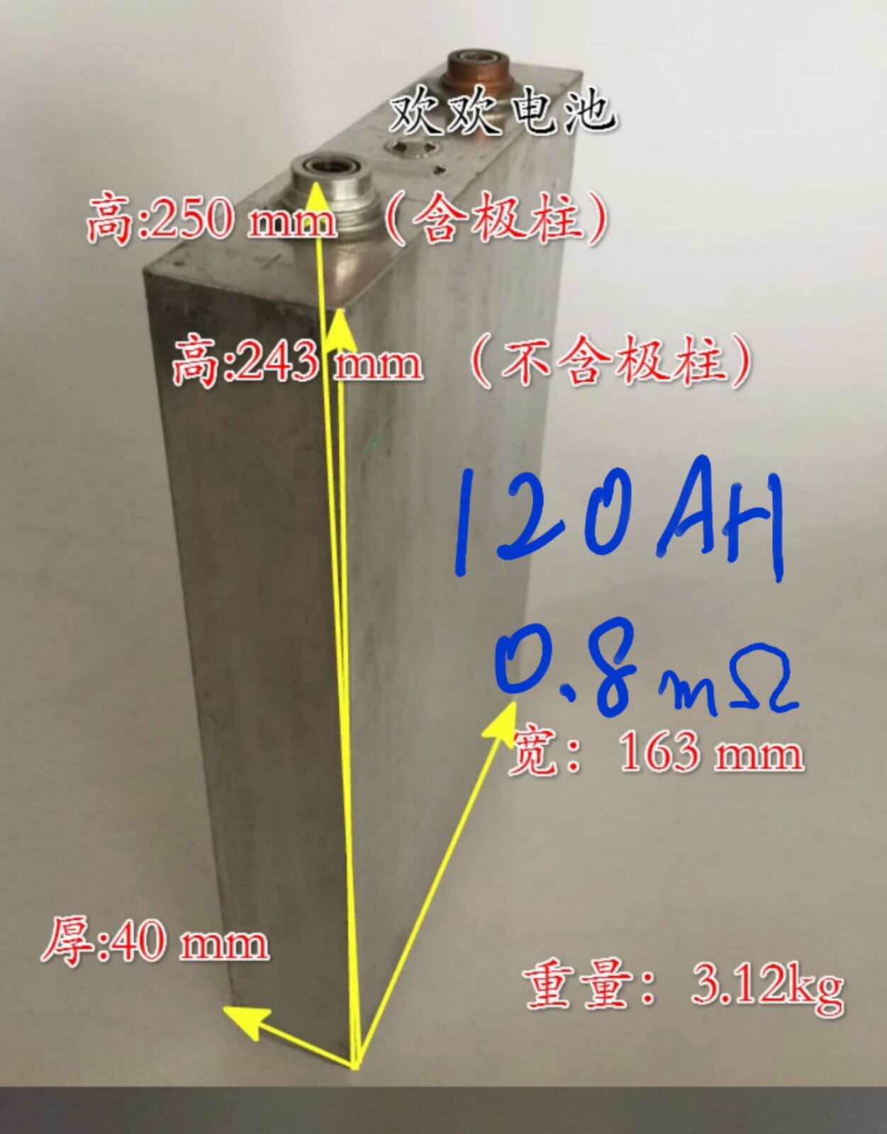

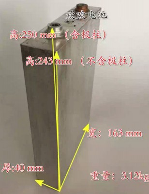

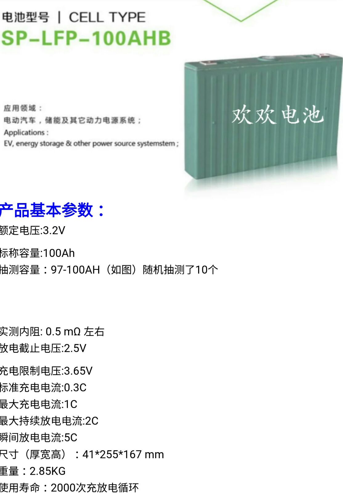

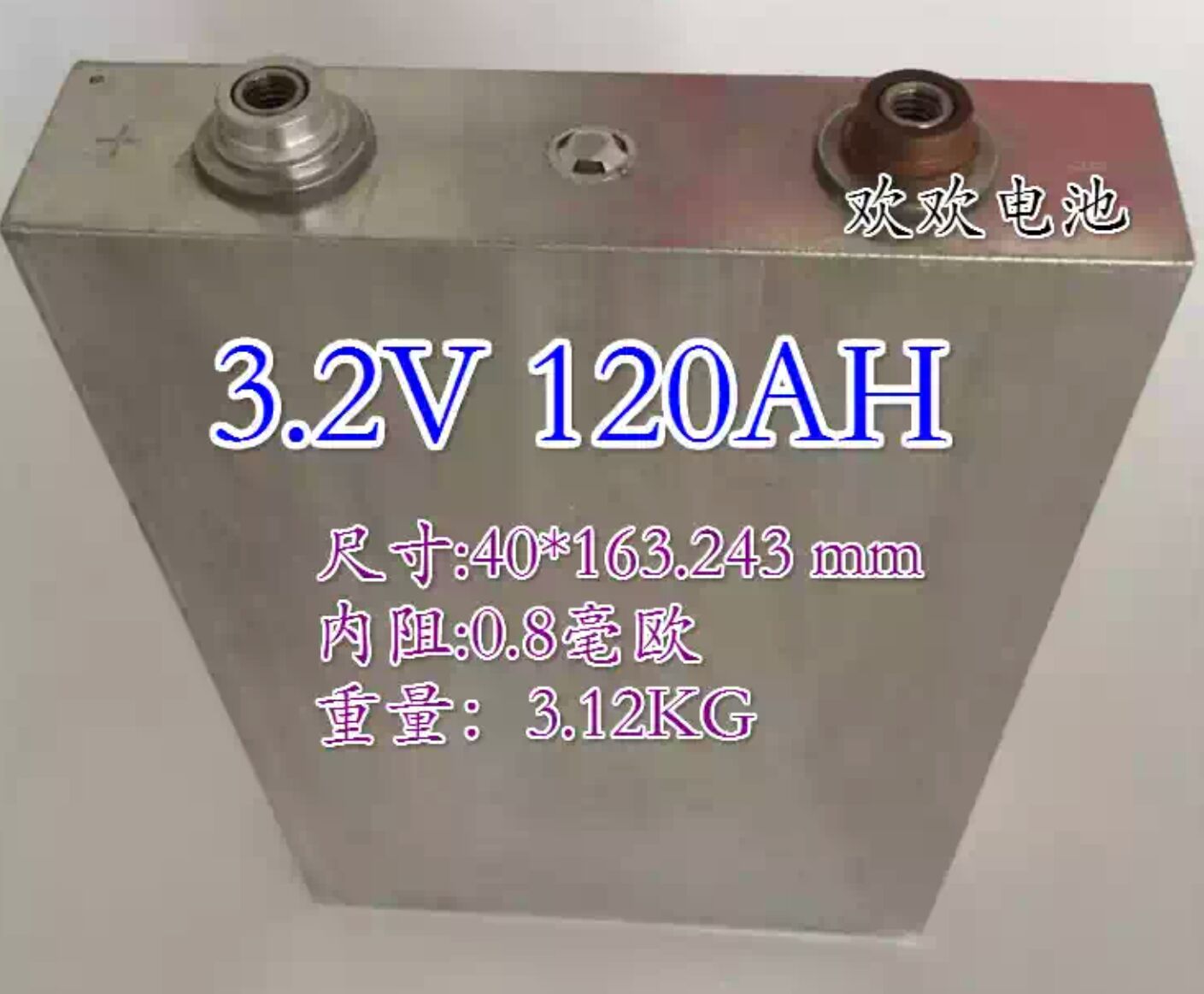

BM , you should give this 75Ah cells some thought again . Their IRs seems better than the brand new SINOPOLY 125AH .
Your box can fit 15 of them . Need 1 more . May be outside the box ? You will have 150AH then . 135AH @90% still .
OR less AH with the twos belows , though 0.8mΩ seems a bit high . The first one is 0.5mΩ
Not enough Ah... Too low rated.
