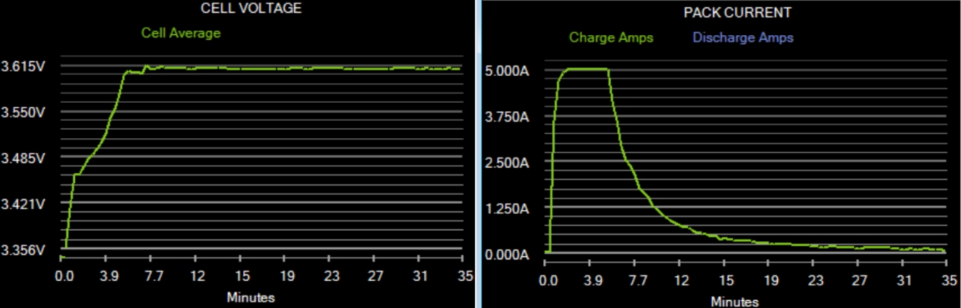

I have the graph from when they were first charged.
Cell 4. The power supply is a new Chargery S1500 V2
Dan

Re: Step By Step 30ah Pack build with pictures
Postby Burgerman » 16 Sep 2017, 22:00
Forget that one. Look at these.
Volts v time
Amps v time.

Postby Dan » 16 Sep 2017, 22:06
Cell nine when I first charged it.

Postby Burgerman » 16 Sep 2017, 22:26
That shows that the line where it holds voltage steady, and where current falls, is a little uneven. So the exact point where the charger terminates the charge will vary slightly. Its caused by the power supply voltage jumping up and down slightly. Many do.
So build the pack and keep track of 9!
