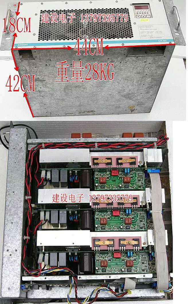

My next PSU .
SIEMENS GR60
7---65V , 0----120A 6Kw , weight 28Kg . :fencing
£150.00
