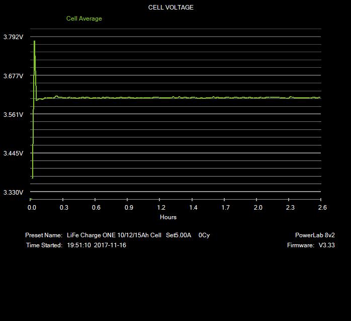

Postby hotwheels_75 » 17 Nov 2017, 03:06
Burgerman wrote:Then CV should easily end in under 2 hours if the cells are healthy. Probably a lot less if they were quite charged. Let them all charge till they reach termination point.
What would you suggest if one doesn’t end in under 2 hours? I put my first battery back on charge after it was already on charge once but didn’t terminate on its own. It’s now been on charge for 2:10 & counting. Current is staying around 300mA, Capacity IN is at 725mAH. Total = 3.619v

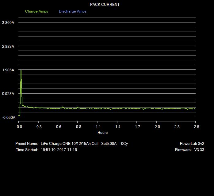

Postby Burgerman » 17 Nov 2017, 03:09

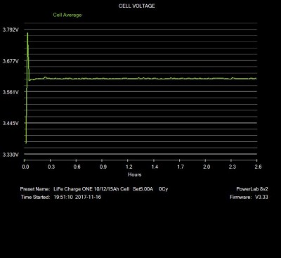

Is it dropping? Look at the amps graph. It certainly should.
Posts: 70441
Re: PSU - Info
Postby hotwheels_75 » 17 Nov 2017, 03:30
Burgerman wrote:Is it dropping? Look at the amps graph. It certainly should.
This is what I’ve got....

Postby snaker » 17 Nov 2017, 03:39
@hotwheels_75: take some close pics of your cables that you are using to connect between the charger and the battery and also between the charger and the power supply too. Someone here might check if terminals were properly done?

Postby Burgerman » 17 Nov 2017, 11:08
Very strange. Call it done, mark the cell with a question mark. The headway manufacturer says charge to 1000thC which is 12mA. So it should easily reach that. But its not falling as it should.

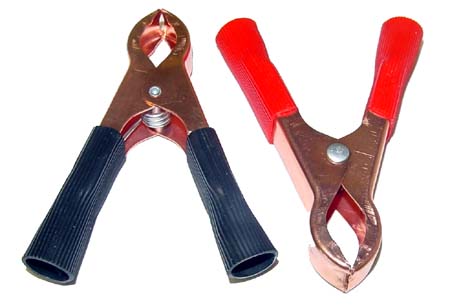

The battery terminals could be an issue, they’re just an old set of battery clamps like these. They’re just temporary until my better ones arrive. They’re attached to the PL8 factory 12awg banana plug wires, with butt connectors.

Could be. We need consistency. Use a ring terminal.

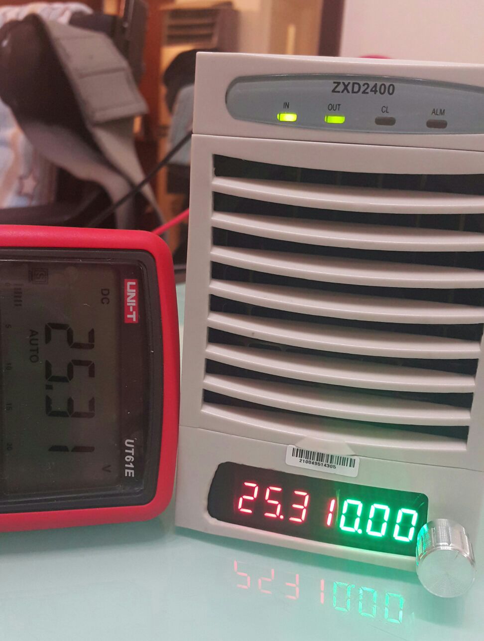

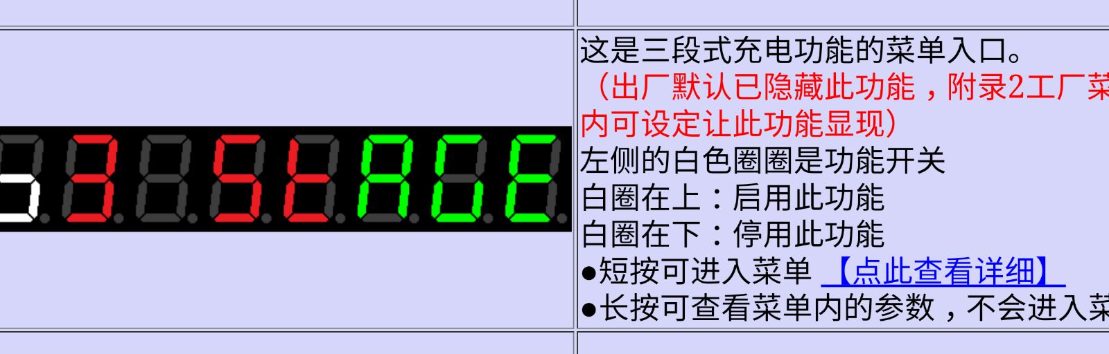

Fun for the next long holiday . Bought this £20 48V50A PSU & a £10 kit .
Will be another 0--60V 0--50A cc /cv bench power supply .
Re: PSU - Info
Postby shirley_hkg » 12 Jan 2018, 03:35
goodpost cheers
Besides , it has 3-stage charger function built -in , and l can set the CC /CV and terminal current too .
Will use it to power PL8 also . The Siemens psu seems a bit bulky now .
