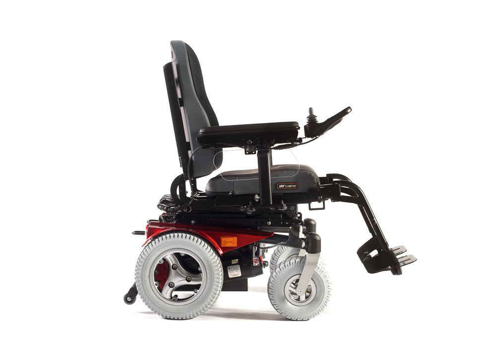

Ordering a cross between a Jive R2 and a Salsa R2 with power everything. Mostly 90% salsa. Same thing pretty much with only seating and 8mph option that I dont want as a difference. If you want to have a more rearward CG the Salsa with canvas plain back is better. And an aftermarket back added later.
Some BUILT FOR ME options...
Some tech not available option not on the forms but they are if you insist.
Power centre footrest (will need reduction in size probably to allow seat to move back)
Power recline but with canvas back (to allow sitting further back to aid CG) for now, then replac sling with http://www.medicaleshop.com/comfort-com ... -back.html
Power tilt with 6 degree start, +30 tilt on top of the 6 starting position.
Power lift.
4 pole 6mph motors for adequate torque, better range. Esp if I fit wider slightly bigger wheels and tyres.
Single vertical arms, - no flimsy lift up... Stronger.
Black - not available stock but it got to be black.
grp 24 batts, soon to be lithium
Rnet newest colour controller and 120A power module as per 8mph for torque.
Sensible price...
Should do for washing van and pressure sore fixing!

Of course it wont be 10kph. 6.2mph. It will have the extra 3 volts of lithium, turned up in programming from 22V max to 25.5 to match, and will likely end up with 120/60-8 tyres on tubeless rims. Which are bigger diameter. So about 12 or 13kph but without the loss of torque due to gearing that the 8mph motors give. So about 8mph AND torque.

It will have godawful grey tyres. So I will be fitting some black ones.
Rear wheels will be tubeless 3.50 x 8 alloys supplied via Shirley, since he offered at a very good price!
Stock rims will be thrown away, complete with stock 3.00 x 8 inch tyres. Stock width is 24.44 inches.
I intend to fit much wider 120/70 - 8 tyres, on wider rims. Overall diameter is .6 inch greater. That will mean a gain of 88mm in total with. 3.4 inches. So it will end up 27.9 wide, or tha same as an X5/V6. Except I can space the tyres in slightly as clearances allow, and gain a little probably. But it will then be tubeless, have better ride, and look better too! I cant help myself. I was going to leave it stock. Then a lithium pack of course.

Same. Salsa, Jive, are Grooves... Its all just fashion and options and marketing! Except your motors will change that.
I wanted to not pay for fancy comfort seating that positions me too far forwards and makes CG position needed impossible. And didnt want 8mph. So ordered Salsa with some jive options, 4 pole, 120A, black, centre footplate, and single post arms, with the "mini" versions arm/controller swingaway, positioning built inwards to get correct joystick and arm top positioning. And a sling back and ugly scafolding headrest! To be thrown away. And replaced with something prettier and more comfortable that doesent push me forwards! Then bin the battery, tyres, rims, and reprogram. Thats the plan...

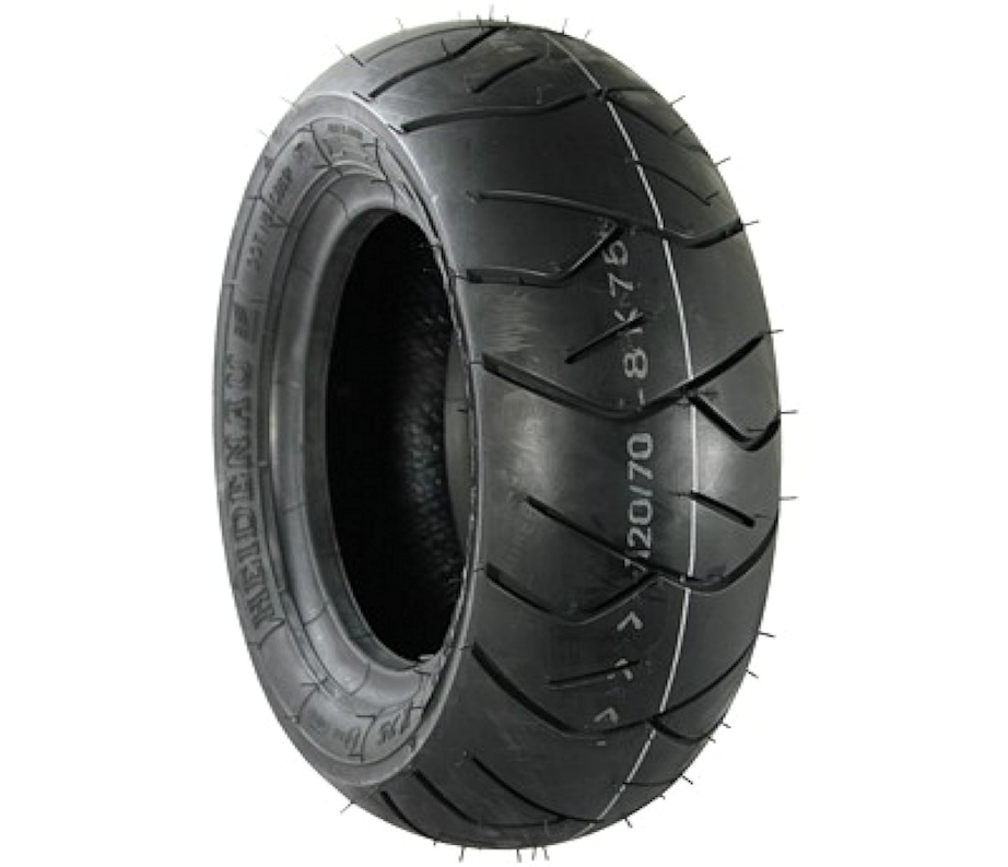

Couldnt get the Duro tyres, out of stock... So now have a similar construction, 120/70-8 tubeless set of these. Thats same 14.3 diameter, 5 inches wide, 4 ply, tubeless and so very stiff/strong construction and so no worries about punctures and long service life:

Nice tyre :clap
at least you can buy fronts same make to match :dance
