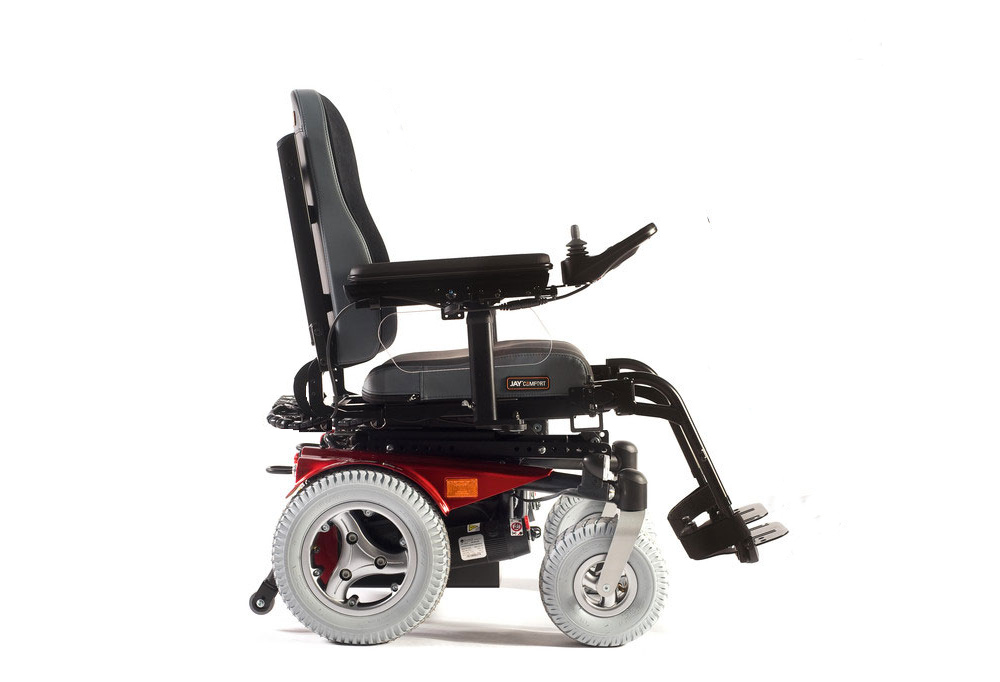

Done same with my groove brushless build
Have you got to swap front forks to take 4 inch wheels.
Or is that pic just a demo one.
Postby Burgerman » 30 Nov 2017, 23:07
It comes with 4 inch rims, both jive/salsa?
Posts: 70464

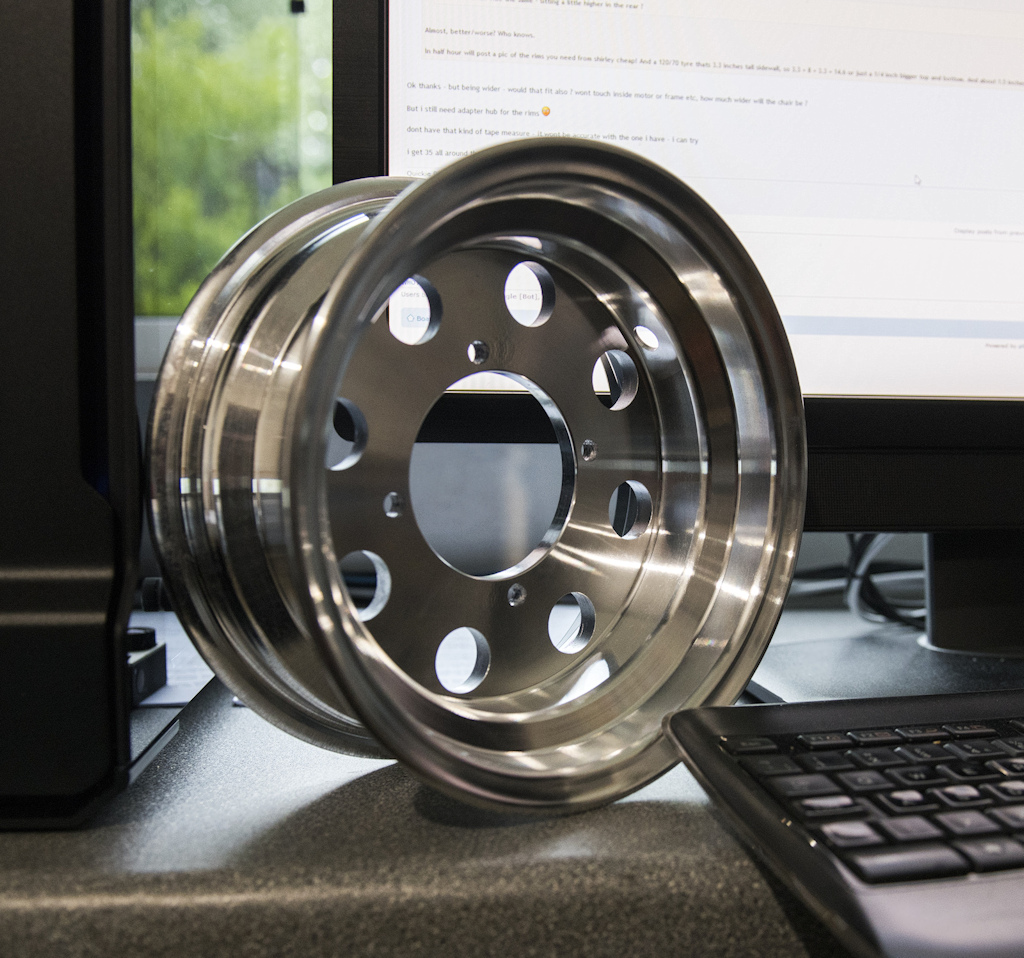

Rear wheels will be tubeless 3.50 x 8 alloys supplied via Shirley, since he offered at a very good price!
Stock rims will be thrown away, complete with stock 3.00 x 8 inch tyres. Stock width is 24.44 inches.
I intend to fit much wider 120/70 - 8 tyres, on wider rims. Overall diameter is .6 inch greater. That will mean a gain of 88mm in total with. 3.4 inches. So it will end up 27.9 wide, or tha same as an X5/V6. Except I can space the tyres in slightly as clearances allow, and gain a little probably. But it will then be tubeless, have better ride, and look better too! I cant help myself. I was going to leave it stock. Then a lithium pack of course.

On a pair of these wide 8 x 3.5 inch tubeless alloy rims. I bought 4 of them, at about £10 each via Shirley.
Where do I get matching fronts again? :cussing

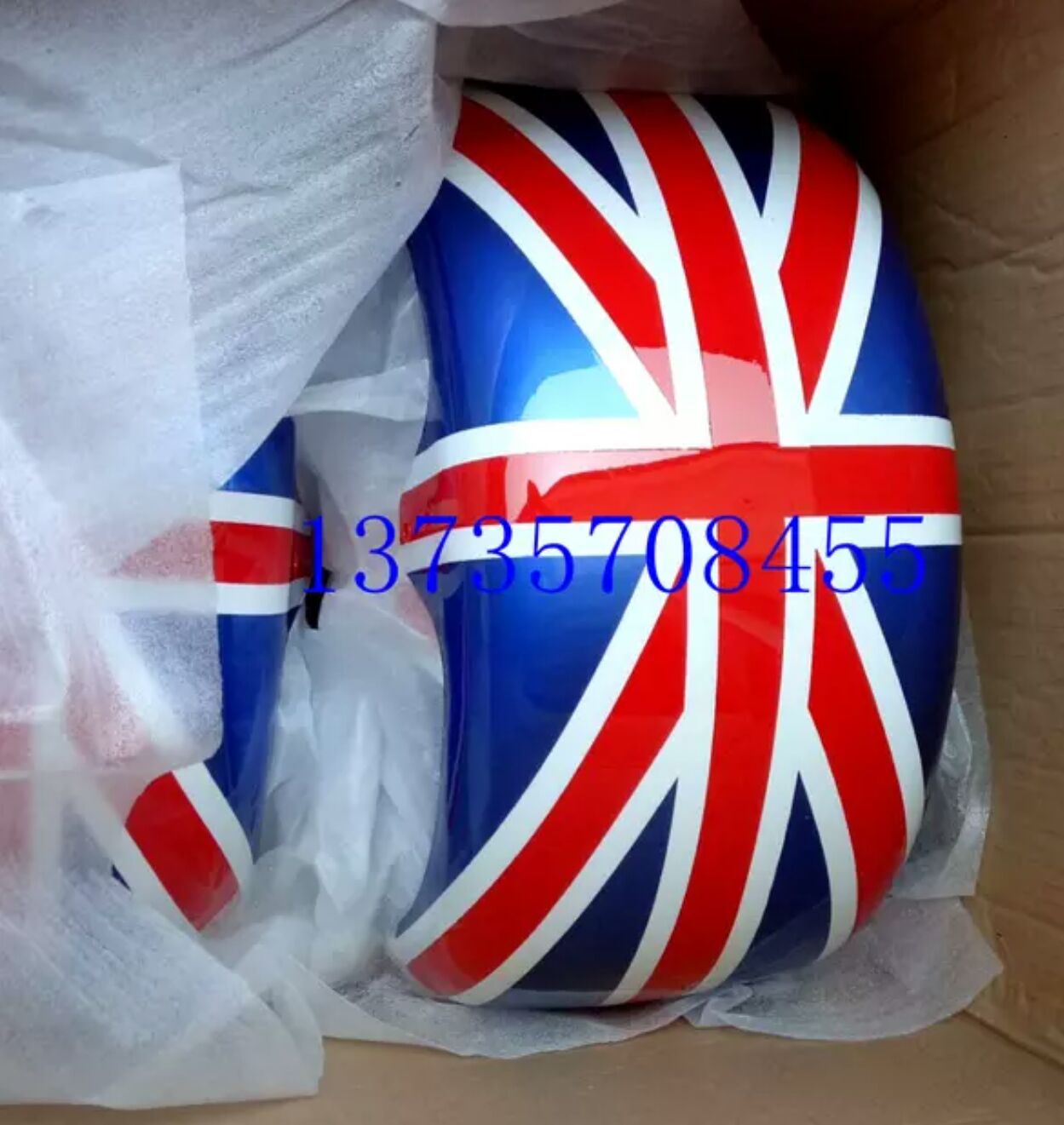

Postby shirley_hkg » 07 Dec 2017, 02:45
Burgerman wrote:On a pair of these wide 8 x 3.5 inch tubeless alloy rims. I bought 4 of them, at about £10 each via Shirley.
YOU may love these mud guards . cheers
