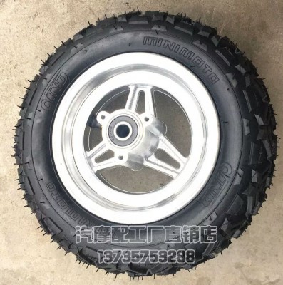

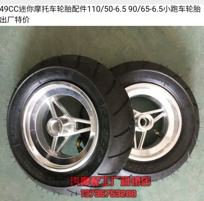

Burgerman wrote:On a pair of these wide 8 x 3.5 inch tubeless alloy rims. I bought 4 of them, at about £10 each via Shirley.
Can someone lead me to a link to these? Are they available in 3.75 inch? Would Carlisle Turf Saver 4.80 - 8 that call for 3.75 rims be too pinched on 3.5"?
Posts: 5794
Postby Burgerman » 28 Dec 2017, 11:26
I think only 3.5. PM shirley!
Proper tubeless rims. Well made. Cheap from HK. Too pinched? A little pinched I would say.

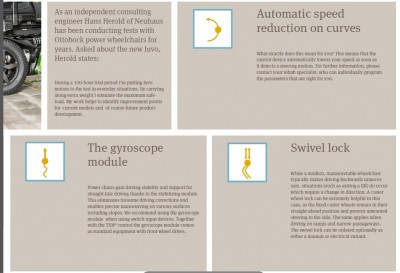

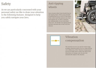

Strange features with new OTTOBOCK JUVO . . :ak47 :bounce
Postby Burgerman » 01 Jan 2018, 12:14
Summary?
They fit a gyro so that front drive becomes possible (but still steers odly) and on other chairs when you attempt to steer stupidly programmed powerchair in a straight line you dont suffer the delayed action over controlled swerving about. Personally I hate driving with gyro on, and couldnt disable it fast enough. Its not required if you have normal hand function and coordination with a properly programmed chair. It just removes feel and makes things worse.
They test with some added weight... Really.
They have fold back casters on front drive...
They programmed in a load of damping so cobbles dont cause your shaken hand to change direction. Which means it steers about 3 seconds after you tell it. Real solution is proper joystick hand/finger placement and position.
They have caster locks. Those are really not new. They have been available for years. I wouldnt want them, they are not required on a properly programmed chair as it goes exactly where its told anyway...
They have programmed in some speed reduction that automatically slows the chair (which I really dont want!!!) if you are going fast and try and turn. That is possibly useful on a front drive (unstable platform) powerchair.
In other words a load of band aids to try to cure the symptoms that are actually caused by low turn acc/dec settings.
