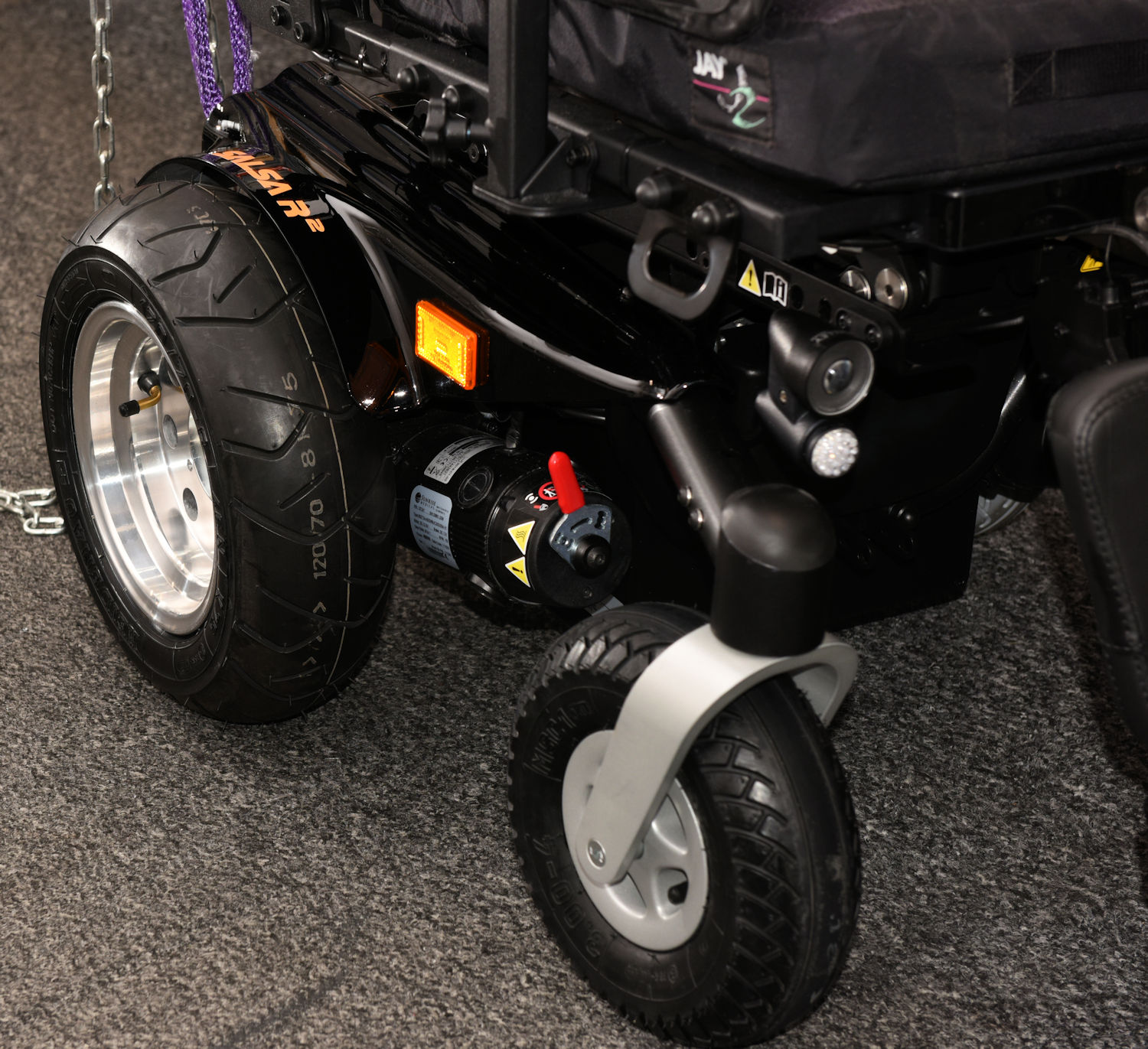

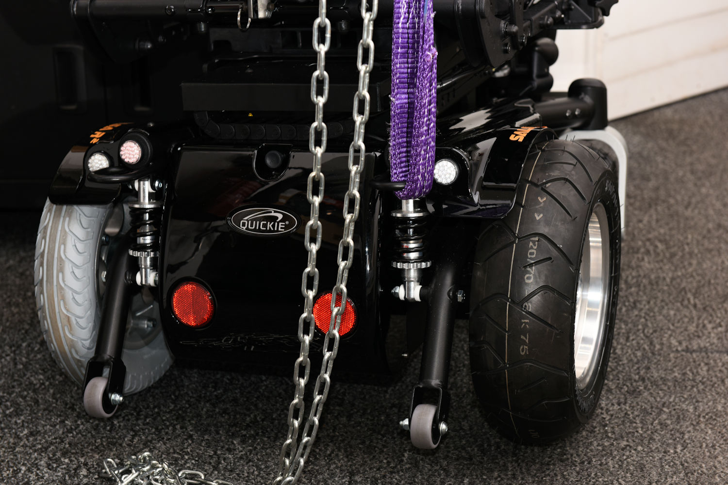

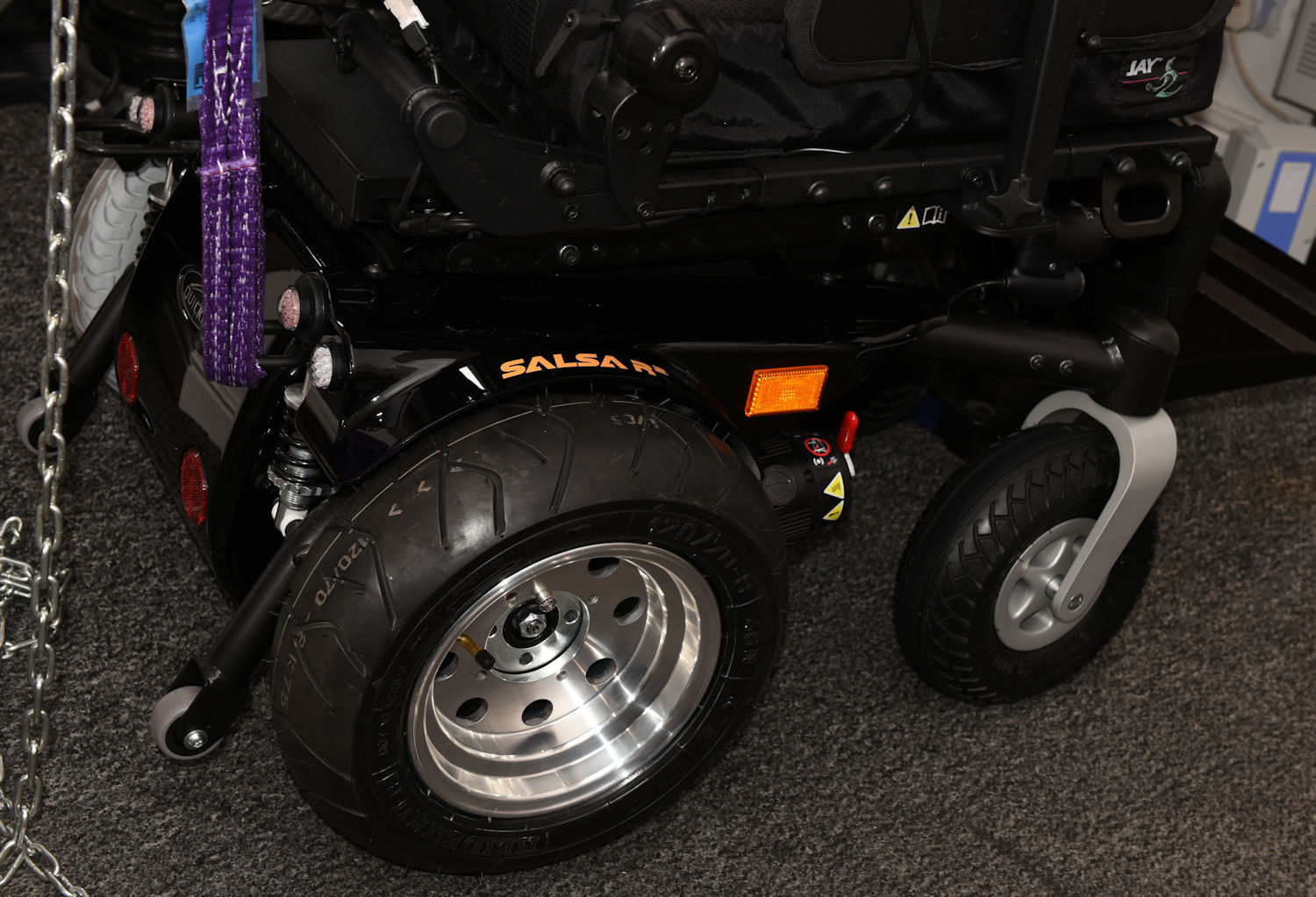

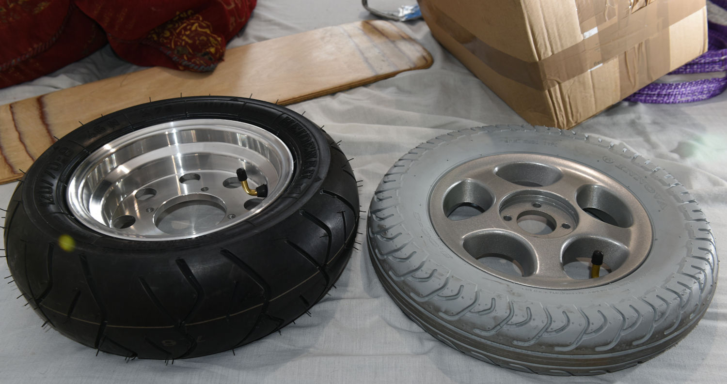

Postby Burgerman » 03 Feb 2018, 14:39
Flimsy grey tube / tyre and wheel on the left.
Stronger 70mph safe construction tubeless tyre and rim on the right.
Not fitted yet. And it will sit 5mm further in when I get the metal to make an adapter.
Plenty room for the bodywork... And its more in keeping with a 180kg chair!
Then to see clearance...
And from the front...
Posts: 70438
Postby Burgerman » 03 Feb 2018, 14:48
Compared

Postby Burgerman » 03 Feb 2018, 16:08
Notice light moved inboard too.
These tyres and wheels add about 1.6 inches per side since the wheels can be mounted a little closer in. By a few mm...
If the stupid manufacturers solt this chair with the lights moved, centre footplate, seat moved bach, these tyres/rims, control pod mounted correctly, and decent programming. Then they wouyld sell them like hot caces to all those like me that want a decent rear drive chair. Because there isnt a stock one on the market. True, it ends up 27.5 wide. But then thats the same as me! So no loss.
