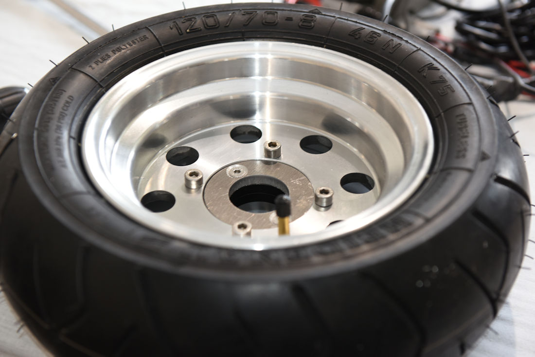

Postby Burgerman » 05 Feb 2018, 05:55
Theres no tyre that is the same diameter. Powerchairs come with 1.75 to 2.5 wide rims. A 3.50 x 8 fits correctly on a 2.5 rim, but looks tall and thin in comparison.

Postby Burgerman » 05 Feb 2018, 10:10
Yes. Thanks. Not bad for about £9 a wheel! Plus some expensive tyres...

Postby Burgerman » 05 Feb 2018, 20:08
To put that another way, stock tyres are 76mm (3 inches) wide.
The fat tyres are 120mm wide and actually measure 118.
So each is 42mm wider. However theres 8mm wasted between stock tyre and motor. So when you fit the wider tyre you take 6mm of this leaving just 2mm clearance. So the 42mm wider tyre will only add 42 -6mm = 36mm per side.
Stock width is 620mm in the specs.
So we are adding 36, and 36mm...
Makes total width 692mm or 27.3 inches. (my 27.5 guestimate!)

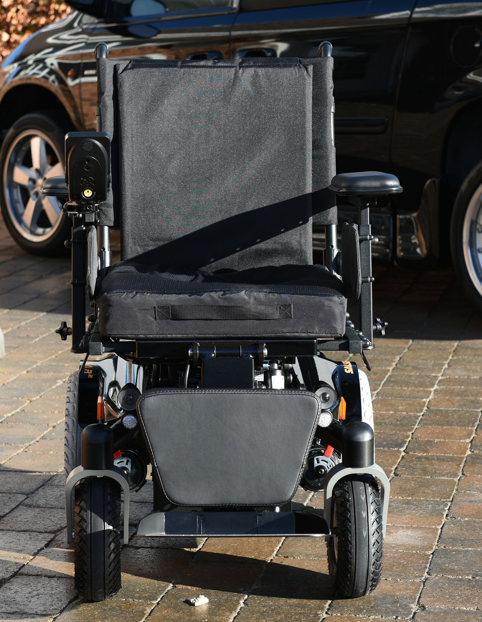

Postby Burgerman » 07 Feb 2018, 15:46
Right, getting up for a few hours today. So a quick pic or two. This is with everything done except
- rear wheels and tyres.
-Jay3 seat back.
Those are still to be done. As soon as the parts come.

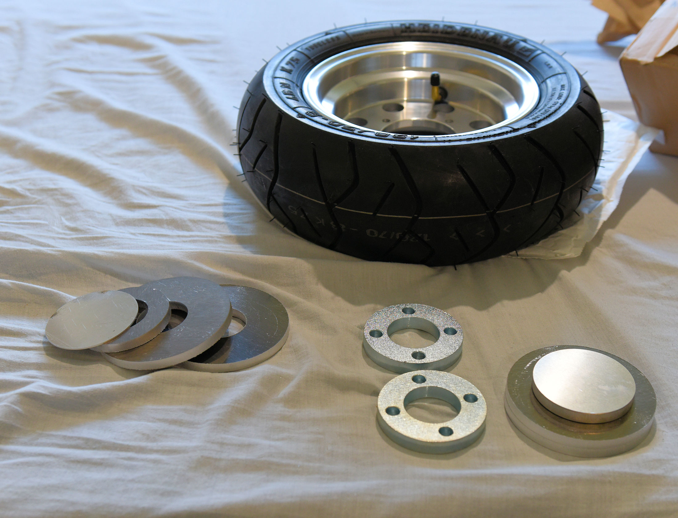

Postby Burgerman » 07 Feb 2018, 15:54
And now my lazer cut wheel adapter parts are here. 3 days! And now to mark/drill...
On the left.
Remember this:
Spacer ring:
Inside diameter 41.5
Outside diameter 110.0
Cover plate 2 parts.
Posts: 71102
Postby Burgerman » 08 Feb 2018, 00:06
Marked the easy way. Sit one on top, and spray paint to mark holes.
4 times...
Then drill 8.5mm on all plates. Two used each side as the laser will not cut more than 8mm and I wanted 16.
So two halves will get bolted together.
Posts: 71102
