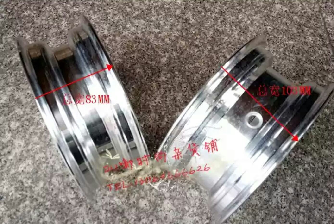

To put that another way, stock tyres are 76mm (3 inches) wide.
The fat tyres are 120mm wide and actually measure 118.
So each is 42mm wider. However theres 8mm wasted between stock tyre and motor. So when you fit the wider tyre you take 6mm of this leaving just 2mm clearance. So the 42mm wider tyre will only add 42 -6mm = 36mm per side.
Stock width is 620mm in the specs.
So we are adding 36, and 36mm...
Makes total width 692mm or 27.3 inches. (my 27.5 guestimate!)

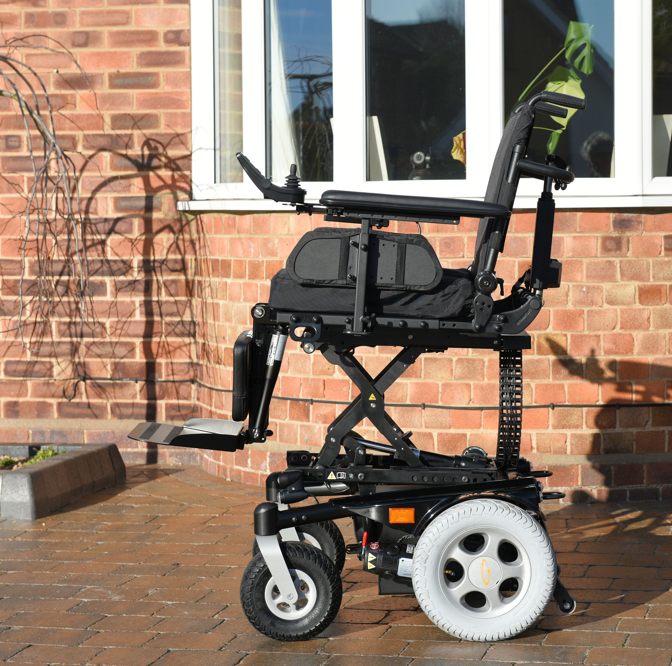

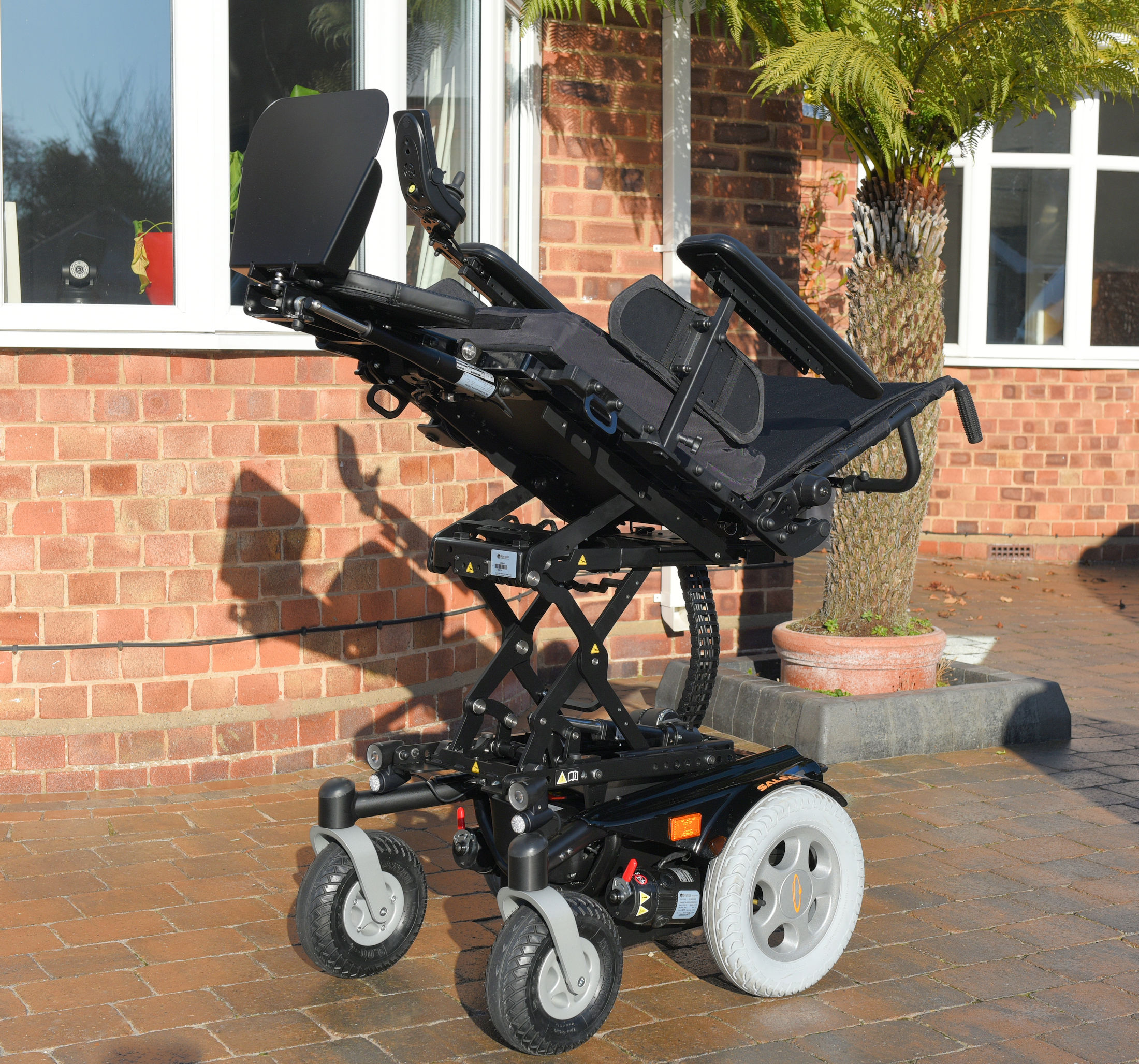

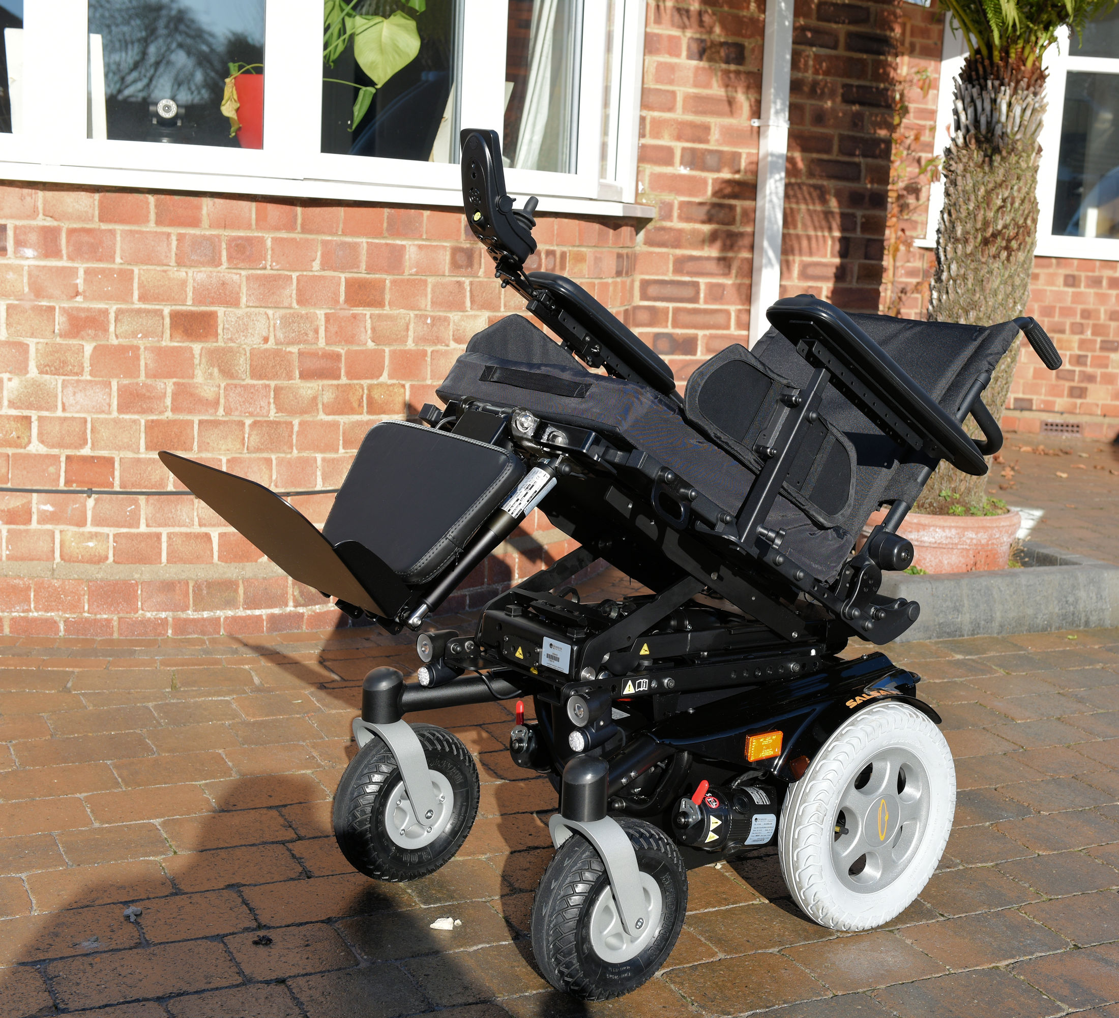

Postby Burgerman » 07 Feb 2018, 15:46
Right, getting up for a few hours today. So a quick pic or two. This is with everything done except
- rear wheels and tyres.
-Jay3 seat back.
Those are still to be done. As soon as the parts come.

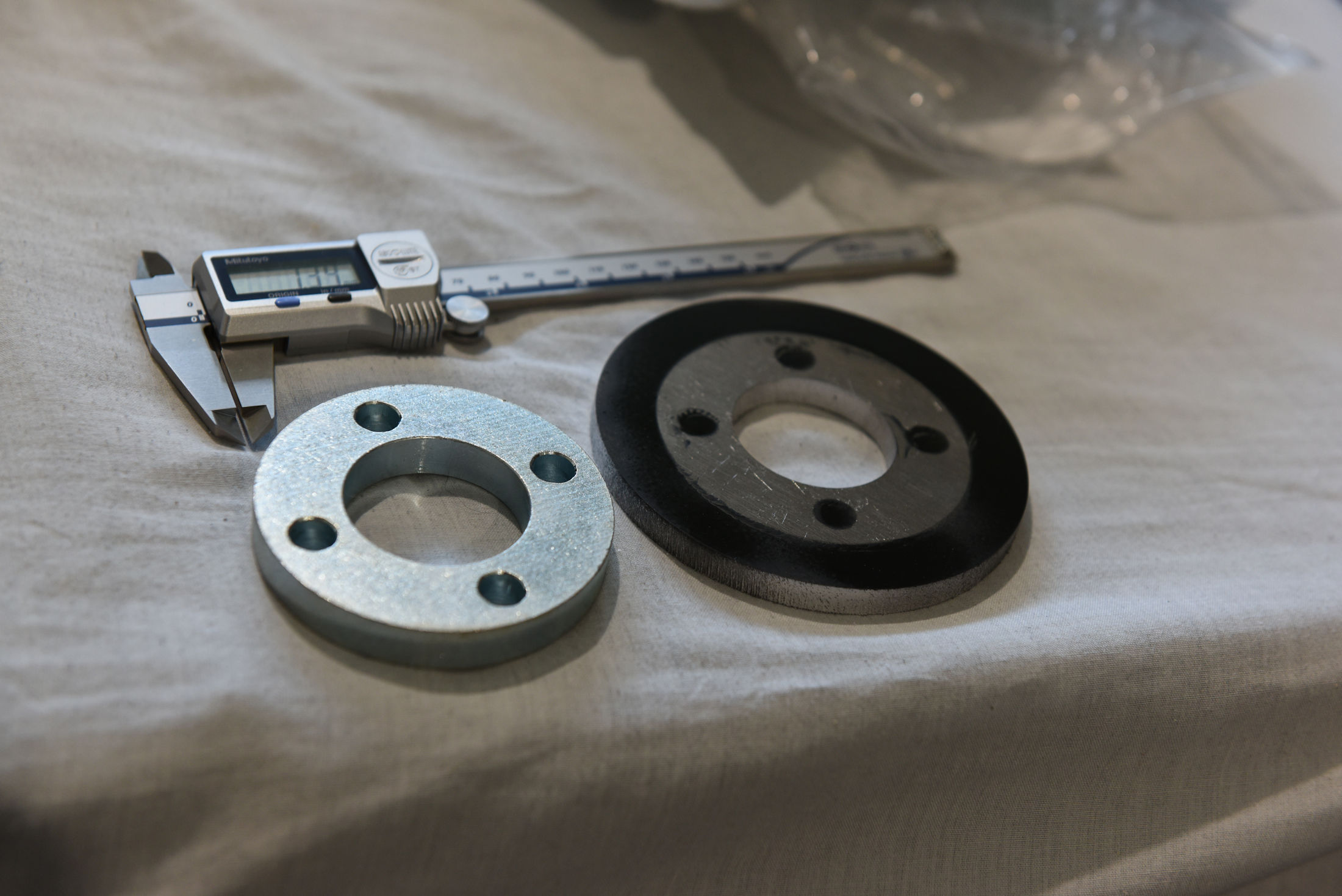

And now my lazer cut wheel adapter parts are here. 3 days! And now to mark/drill...
On the left.
Remember this:
Spacer ring:
Inside diameter 41.5
Outside diameter 110.0
Cover plate 2 parts.
Posts: 71101
Postby Burgerman » 08 Feb 2018, 00:06
Marked the easy way. Sit one on top, and spray paint to mark holes.
4 times...
Then drill 8.5mm on all plates. Two used each side as the laser will not cut more than 8mm and I wanted 16.
So two halves will get bolted together.
Posts: 71101
Postby Burgerman » 08 Feb 2018, 00:19
Part done, hard work when all your drils, allen keys, bolts, files, are all on the floor... So not done yet.
This bolts on in place of the otiginal spacer/wheel. And it will tomorrow have another 4 holes, tapped M8 for the new wheel at 92mm PCD. Near the outer edge.
Then theres 2 more parts that wiull bolt to the centre to centralise the wheel, and to give a flush finish on the wheel centre hole. As you will see. The black bolts fit to the chair. No nuts used. The two stainless ones just hold the two halfs together.

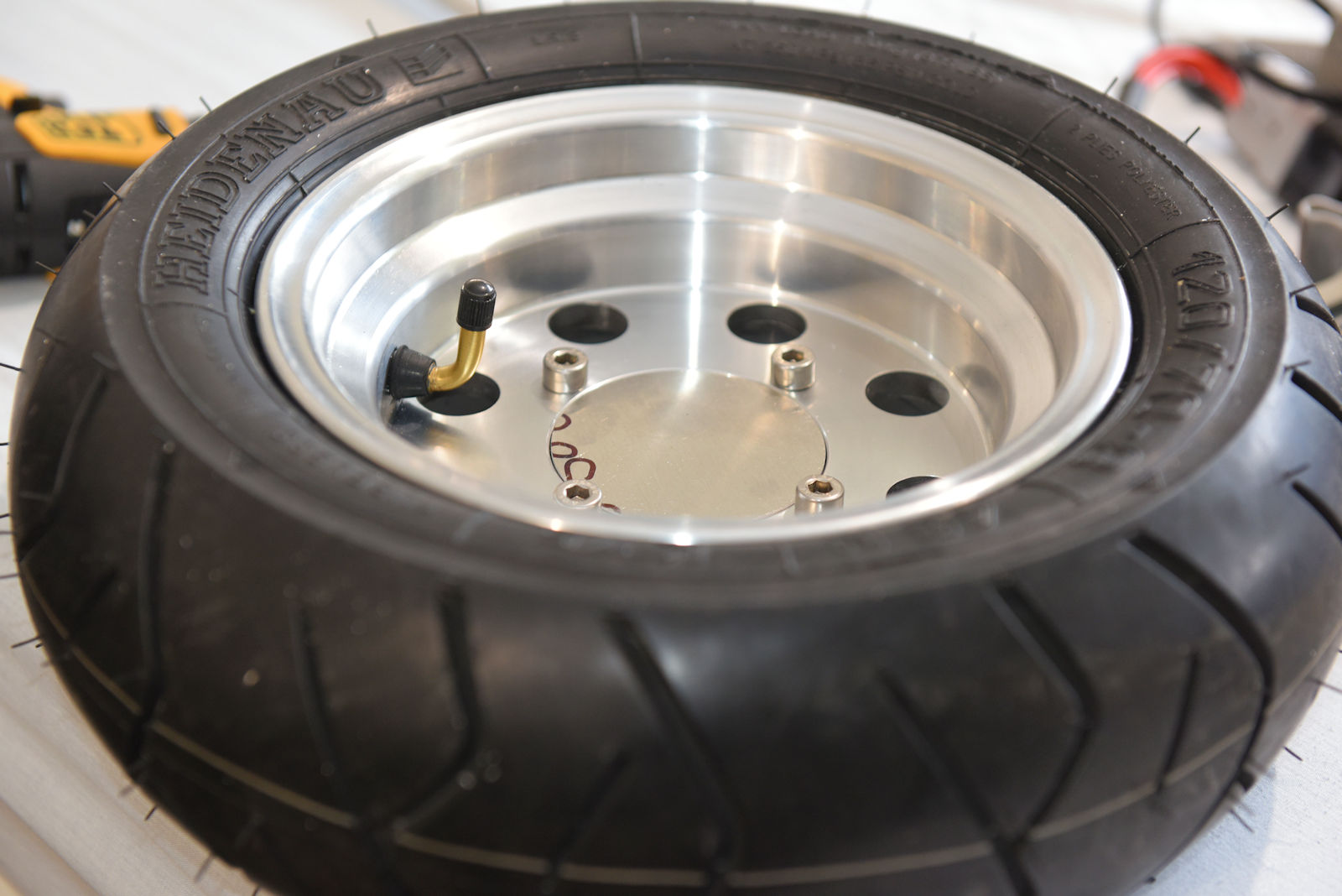

Postby Burgerman » 08 Feb 2018, 14:32
Wheel adapter bolted to wheel, no cover, needs cleaning up, spraying black etc.
And it then gets a 1.5mm thick cover, that will be polished, and held on with two 4mm countersunk screws.
And then I get to start all over again andmake another one for the opposite side... The fun. :cussing

Postby Burgerman » 08 Feb 2018, 15:51
Screws done (1st wheel...).
Just needs a polish and fitting. Centre cap bolts are not fully tight here.
