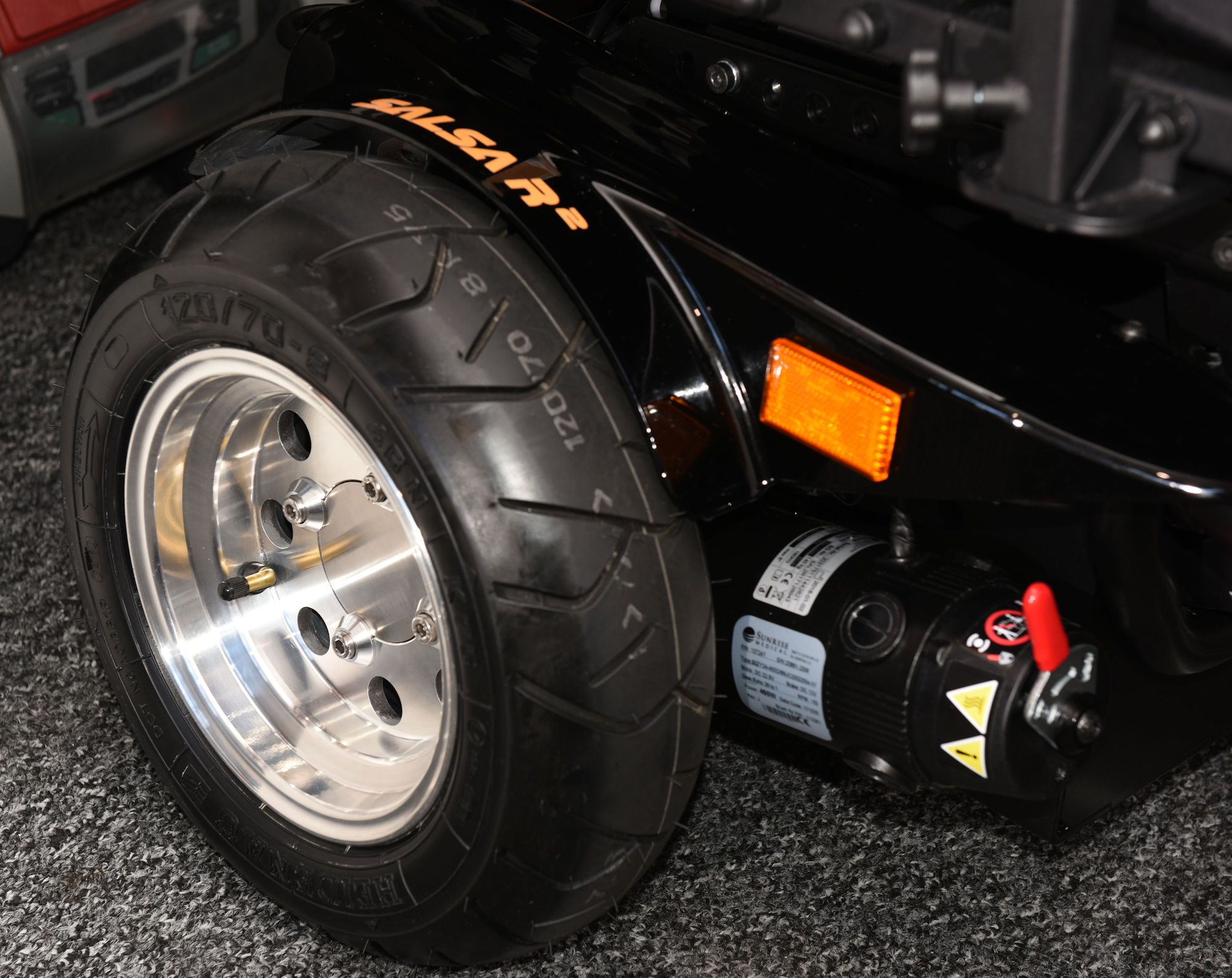

Postby Burgerman » 15 Feb 2018, 16:51
AND i didnt like how the centre caps were held on with two screws.
So I made a new centre disk in stainless 304 (by calling lasermaster and ordering it! 74.5 x 1.5mm stainless https://www.lasermaster.co.uk/metal-laser-cutting ) and locked it in with the load spreading washers.

Postby hank » 15 Feb 2018, 21:34
Now that setup on wheel centres does look well. :thumbup:

Postby Burgerman » 16 Feb 2018, 06:10
Ebay! :worship But it better look finished. And neater to have them hold the centre disk too. And of course the disk is stainless steel! It actually looks better in real life than a photo with flash. All really well finished.
I have the other 2 wheels with the duro tyres fitted. Will swap when I get a carer here. Still only getting 2 hours per day off my bed...
That laser cutting company is super accurate and 2 day delivered! My favorite company at the moment.

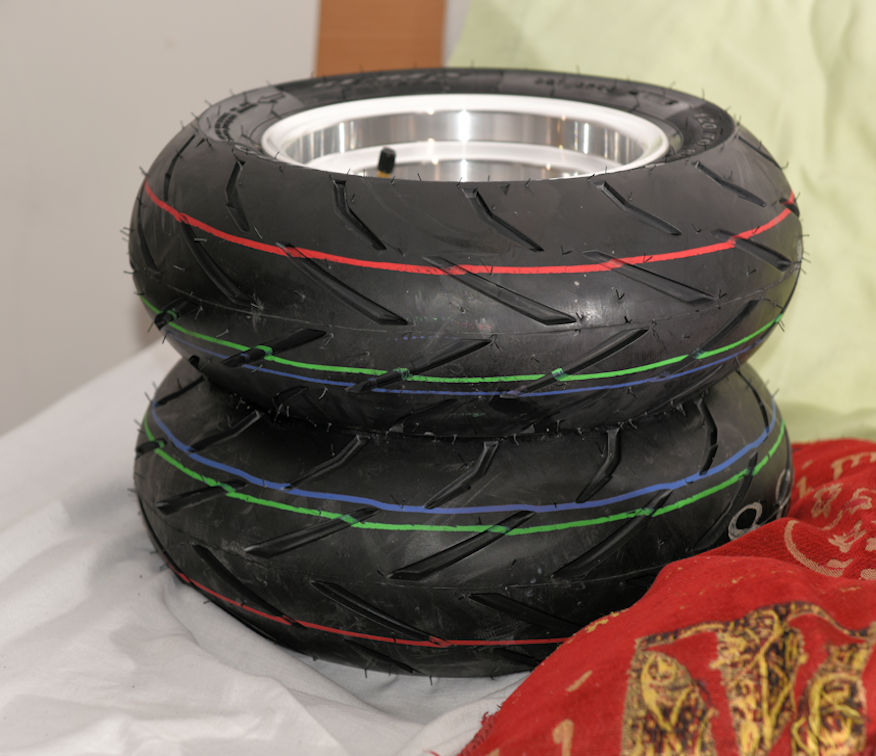

Postby Burgerman » 17 Feb 2018, 19:36
Except these tyres. Bought in belgium. Delivered 2 days!
These are a much tighter fit to the tubeless rim. These are very high quality and tough tyres for motorway speeds. And are designed for racing and so the rubber goes all sticky if you get them hot! That wont happen in a chair! Fitted these to the 2nd set of rims I bought from Shirley. I got 4 because I may need a spare, and £9 each!
These tyres are 18mm bigger diameter and 6mm narrower than the other set. But they are harder to get off the bead after inflation so safer if you want to run really low pressures. Both types are fine at 20psi or higher. Been testing. Down to 10 both types, they are OK. So 20 is very secure. running at the recommended 36psi they are super safe. I think I had a leaking valve core before, that let one tyre go to a real low pressure. Its hard to tell because the sidewalls are stiffer than mobility sized tyes. So you cant easily tell its deflated a lot.

Postby expresso » 17 Feb 2018, 19:47
nice - i guess the ones i have and using are for Tubes - if i wanted to keep the same size as a 350-8 - i would need 120/70 tire ? what is the link for that tire - model etc, - curious for when i need to replace mines -

Postby Burgerman » 17 Feb 2018, 21:19
Expresso, I think this is going to be another thing thats hard to find in the US.
Try searching for:
Heidenau K75 120/70-8
or
Duro Or Kitaco 120/70-8
Both are the same diameter as what you have now actually a fraction less. But are low profile and so wider. You need the 3.5J wide rims for these - very cheap. From that chinese auction site or if shirley will ship them too you even better. If you ask him nicely! But right now hes still in 2017 and drunk. drunk2
If you want to fit the same size as you have now, those are available in 3.50 8 as well, and are on one of my chairs. http://www.wheelchairdriver.com/images- ... r-1024.jpg and in this case with a cheap steel tubeless rim.
