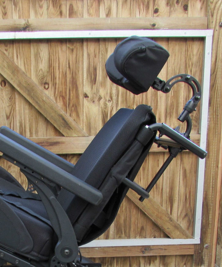

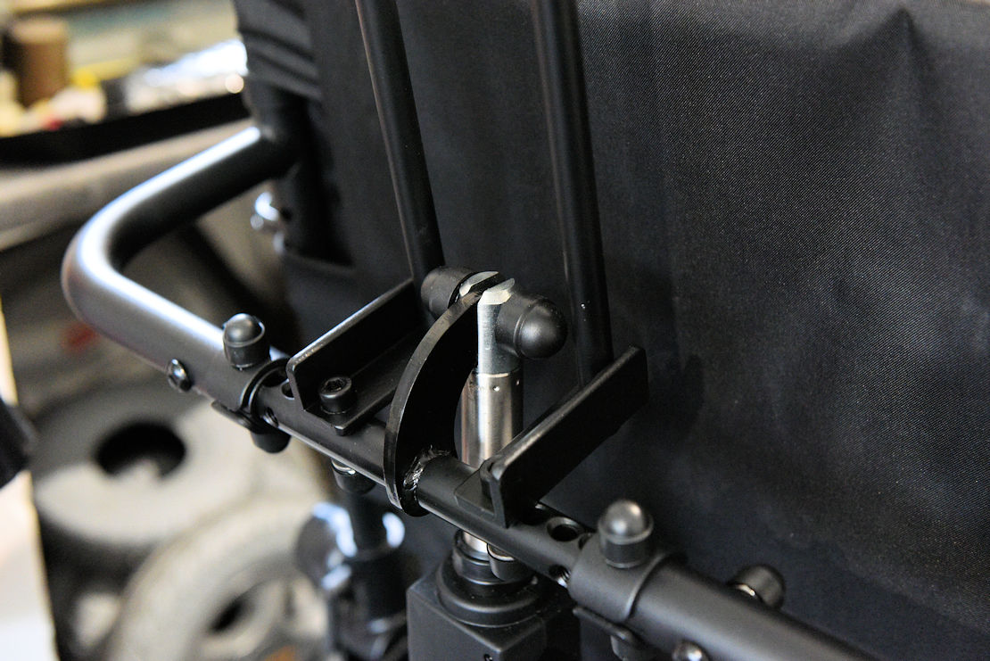

Postby Burgerman » 13 Mar 2018, 15:04
You cant have tilt or recline, esp both, without a headrest... Your head is heavy!
The stock headrest mount that sunriuse supply, requires that it is fitted over the huge push handles, sticks out about 9 inches total, and looks terrible.
So I threw it away as you do, along with all the adjustable knickles that nobody needs, and then made a stronger simpler much lighter mount that mounts where the seat recline actuator goes on the cross bar on the seat back.
Basically I added 2x bits of 5mm thick x 25mm angle iron x 75mm long. And 2x alloy bars, 13mm diameter. At the top added two M8 "eye" bolts. Easy, 10 mins work. And a few 13mm spacers at the headrest mount.
And push handles now shortened by 7.5 inches. I can now turn around in my van, at my PC, or in the toilet, without ripping chunks out of the wall or knocking the computer off the bench... And it wobbles less, looks better, and saves about 4lb... cheers
Posts: 70452

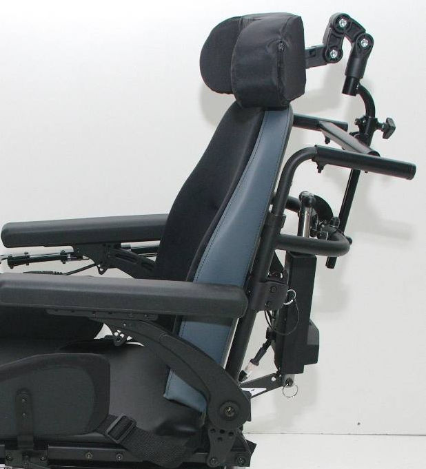

Postby Burgerman » 13 Mar 2018, 15:10
Replaces this (not my chair, same setup...) here:
Posts: 70452
Postby CPguy » 13 Mar 2018, 15:13
That looks so ... disabled I guess! ;) Right you are to improve on that!
I would not want to be found dead in something as ugly as that...

Postby Burgerman » 13 Mar 2018, 16:04
Its not just me. Or you. NOBODY wants it. So why do they do it?
Its like they are trying to make it as badly thought out as they can. To use up as much metal, with as many parts, bracketrs, & bolts as possible. That makes it over heavy, over complicated and as ugly as possible. So that nobody wants it. It also makes it 10 inches too big/wide. Hits everything around you. Maybe they want to sell as few chairs as possible? :cussing
Changing half a dozen such cockups on this chair (or any production chair) turns it from a thing of horror to a desirable, properly functional chair. That leaves one question. What are they thinking?
It remains the best rear wheel drive chair available at the moment however! Just requires some minor improvements. But all do.
