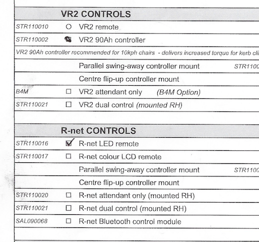

CPguy wrote:R-net LED and VR2 90A is not possible. Either both R-Net or both VR2. Check again!
The seller emailed me the order form but I know nothing about powerchairs.

Postby Burgerman » 14 Mar 2018, 15:12
Well thats a contradiction.
An R-NET control pod requires an R-NET power module. And that can use this too, so start saving! http://www.cw-industrialgroup.com/Produ ... CJSM2.aspx
R-Net http://www.cw-industrialgroup.com/Produ ... R-net.aspx
A VR2 Controller needs a VR2 power module...

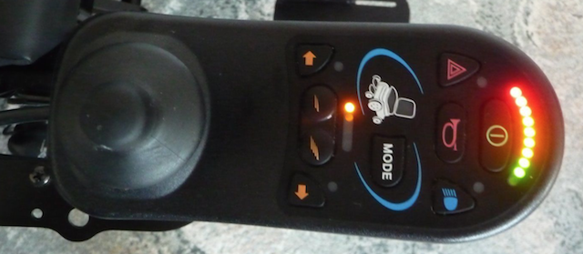

Postby Scooterman » 14 Mar 2018, 15:19
Here's a photo of the controller.
So do you think there's a mistake on the order form?

Postby Burgerman » 14 Mar 2018, 15:24
On the order form both VR2 and r-net are ticked... Which cant work.
Thats an Rnet LED joystick pod. http://www.cw-industrialgroup.com/Produ ... R-net.aspx

Postby Scooterman » 14 Mar 2018, 15:39
I'm confused?
These are the only options on the order form. All the other guff is about legrests, armrests, seat width, wheels, etc
If as BM says the item we can see is a R-net led joystick. Then that must mean the VR2 90Ah controller is wrong?
Does it matter? The chair obviously works, but I assume if it's got a lower power controller then the spec isn't as good?
Postby Burgerman » 14 Mar 2018, 16:41
Yes, its got an r-net 90A one instead, since thats the only one that can be fitted. Or if really lucky a 120A one, but thats not a stock option.

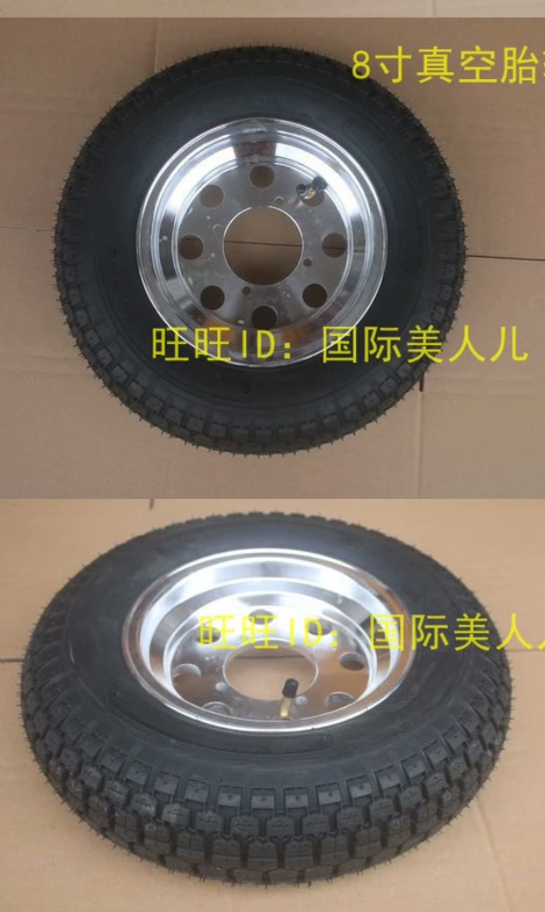

Postby shirley_hkg » 15 Mar 2018, 07:06
Scooterman wrote:
How about changing the 12.5" solid drive wheels and solid 9" castors tyres and perhaps wheels to give a more cushioning ride and nicer look?
I don't know this Shirley HK gentleman so will have to buy in UK. Also if I changed the drive wheels I'm guessing I'd need to get some of them spacer plates made like BM..
I'm at your service . It is around £23.00 a wheel with 3.50-8 tyre .
With BM's measurement , I can make & ship with those spacers too .
