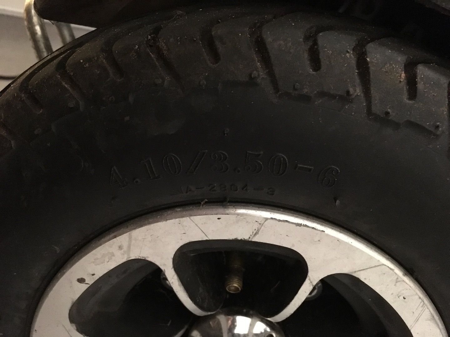

From the ref numbers my scooter tyres are imperial 4.10/3.50-6. So being careful once again they're 4.1" tread width, 3.5" side wall height, and designed to fit on a 6" rim? So in metric they would be 105/85-6? So in tubeless purely as an example these would fit https://www.amazon.com/3-50-6-Tubeless- ... B073SDG9LL? I'm sure you must have mentioned the benefits of tubeless tyres in the main pages. I shall have a read up later as I don't know what the advantage is, I'm just copying you.

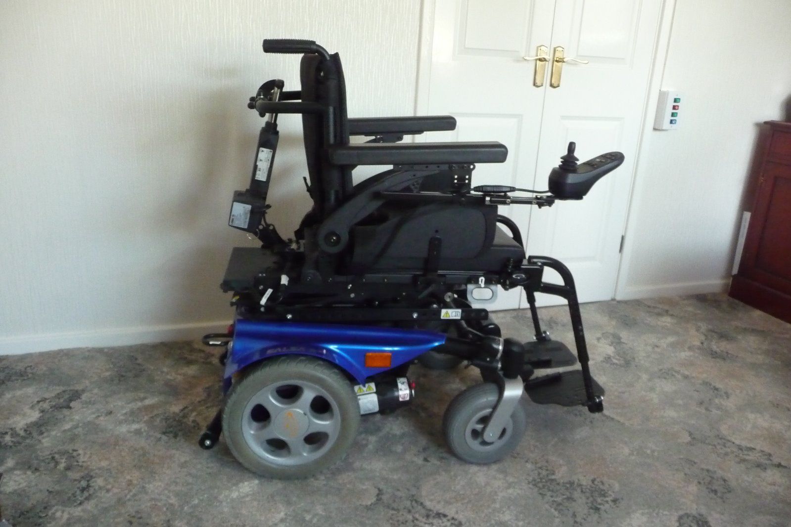

This is a photo from the eBay listing (private seller)
. As it is, especially on solid tyres even to my eyes it looks like it'll handle like a dog. As you mention at the start of the this thread the reason you went for a fabric backrest, as well as moving the seat back was to try and achieve a higher rear to front weight bias. That's why I also went for a fabric backrest and am going to do exactly the same as you. I learnt that from playing around with manual wheelchair set up.
