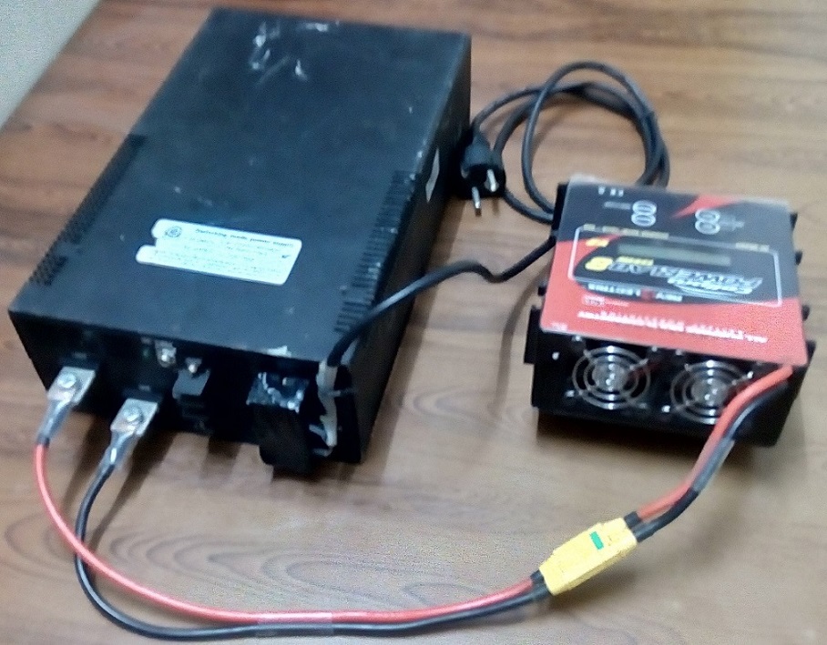

Postby shirley_hkg » 17 Mar 2018, 13:56
Delivery in 2 or 3 days via Speedpost , postage doubled . :wave:
Allow me to test it , before shipping out . cheers
Re: PSU - Info
Postby Gnomatic » 17 Mar 2018, 15:54
Looking good. :)
