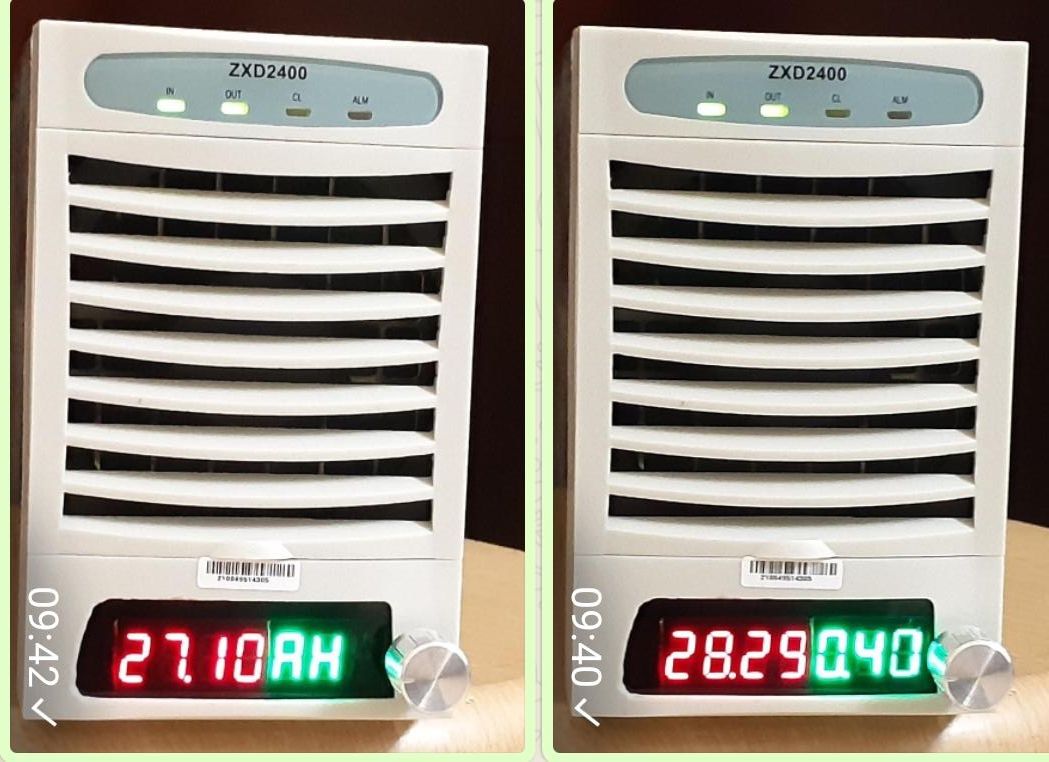

Postby shirley_hkg » 19 Apr 2018, 02:57
Try it on a pair of old MK Gel.
CV @28.2V ,for 9hrs . Current seems won't sag any further .
Re: PSU - Info
Postby Burgerman » 19 Apr 2018, 09:16
Because they are old...
With older batteries you need to lower charge voltage. The correct voltage at room temperature is 13.8 up to a max of 14.1V. But old batteries are not efficient and warm up as you charge so voltage must be lower. And the older they are the higher this current will be.
To desulfate old batteries as much as possible leave on a small 200mA limit with 15v max for around 3 days. But dont expect miracles!

Postby Burgerman » 08 Nov 2018, 11:40
Mine do. Yours dont because they are sulfated and old. So set termination or transition to float to occur at .5A instead of .2.
Or set volts to 28.0 instead. Or try to charge at CV for around 8 hours anyway, it might remove some of the sulfates. But watch out as the current can begin to increase. And then the battery gets warmer. Then it draws more Amps... Gets ever more warm, and melts...
