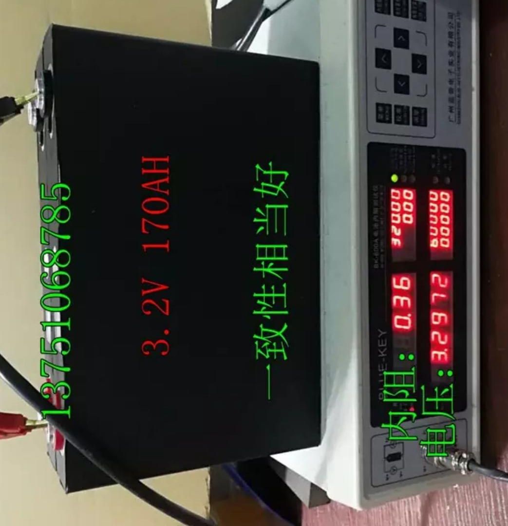

Postby expresso » 17 Apr 2018, 16:02
whow - this may change everything now - those will fit in the same size of the group 24 - how much are they ? now that i would love in my chair 170ah :thumbup:

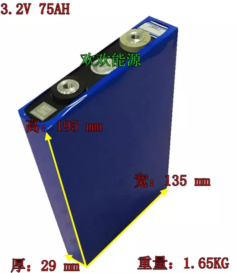

These things appear!
But as usual, no supply available!
Also uninsulated. So casing is negative... Causes issues making a pack.
I would still be interested.
IF theres a regular reliable supply of new cells. Would nylon dip every cell. About 5x over to be sure. And seperate with 1mm plastic card, and 3mm on the base. Tape the lot up with duct tape. It will then be safe. These will be low C rate. So a large pack is essential. So you NEED 170Ah. But will work. So then...
From MK 73Ah you get about 40 to 45Ah out. So these will give 3.5 to 4 times as much range.

Postby Burgerman » 17 Apr 2018, 17:25
To insulate you can tape them together temporarily, but add black RTV (bath sealer, silicone rubber) between each cell. Add 4 rubber washers between each as spacers. Leave to set. Sit the whole thing on a 3mm plastic base, and silicone that too as a permanent attachment. Test cells FIRST! You wont get them apart. Build as 2x 12V batteries. And seperate them with a rubber mat.
Then you end up with 2x lead brick replacements.

Postby Burgerman » 17 Apr 2018, 18:15
Yes it will fit exactly!
Width wise, 255, we have 260 as per MK (or more on some chairs) Leaves room for 2mm sheet either side.
Thickness 41, 4 cells is 164. MK is 171mm, so we have 6mm spare. Thats 1.5mm sheet per cell. and /or siliconed.
Height, is much lower so space for a 8mm steel plate below, and a 3m plastic sheet for safety with ease.
It would be possible to fit 4 into an empty grp24 shell... And make a "battery"... Those are available too.

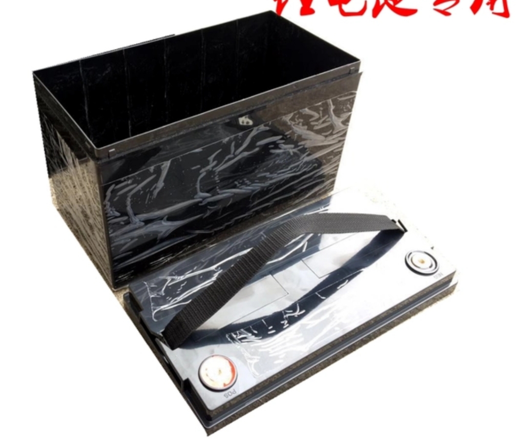

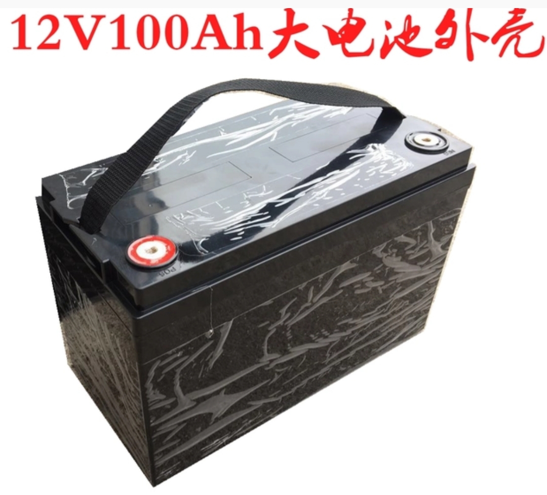

Postby Burgerman » 21 Apr 2018, 18:28
I used to get all kinds of battery manufacturer spam. Since I sold batteries online. I remember some for empty battery shells, with lids not yet applied. They had 6 internal walls that would need removing. With a dremmel or similar. But no longer have these. So cant easily find now.

Postby foghornleghorn » 21 Apr 2018, 19:05
1. Does anyone know how durable something which has been 3D printed is? Wondering whether it would be possible to design and print a case with 4 slots the cells would fit in snugly.
2. Completely opposite to that, do the cells get hot in use and would they not really enjoy being fully enclosed? Just concerned as I have broken down before due to overheated electrics.
Burgerman wrote:I used to get all kinds of battery manufacturer spam. Since I sold batteries online. I remember some for empty battery shells, with lids not yet applied. They had 6 internal walls that would need removing. With a dremmel or similar. But no longer have these. So cant easily find now.
The only empty shells I have seen were in a classic car magazine designed to hide a new battery in a period looking case to keep the concourse originality fusspots happy. They weren't cheap.

Postby expresso » 21 Apr 2018, 20:31
https://www.simcobox.com/plastic-projec ... er_page=50
this place may have something or maybe can have it custom cut to size -

Re: Sinopoly Cells - Info -
Postby Burgerman » 22 Apr 2018, 14:43
Yes those. But we need grp24 size.
260L x 174W x 220 to 240 tall.
Posts: 71096

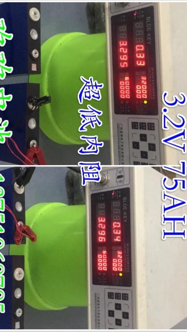

Postby shirley_hkg » 25 Apr 2018, 02:26
Found these good cells , and good price .. Reviews from buyers are ALL positive .
0.3mΩ rated @5C . 75Ah@£20.
May fit 16 of them in a G24 space . cheers :clap:
