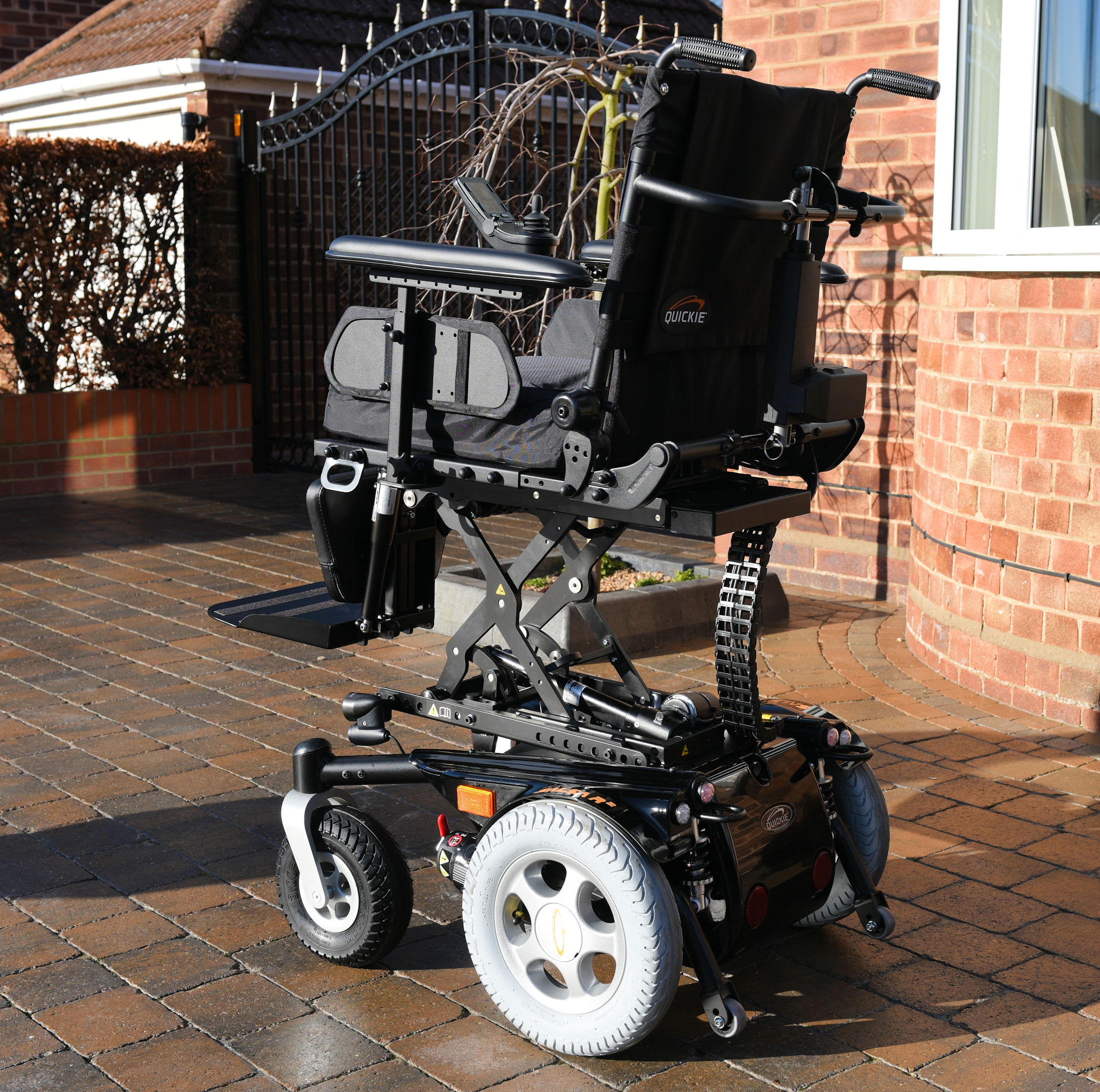

first off here is a picture of the chair - and links to the parts list which shows the hub part number to be the same on both chairs - i have the newer motors - its 3 years old - I dont have the older larger motors - but when i look it up - it does show the same hub part number for both older and newer motors
so i would say the 636 you can use there would be the same as i have -
take a look -

The limiting factor is the motor can in most cases. It means a tyre cannot go inwards as it will hit the motor. So take a look at that gap, and any other thing that the tyre will hit if moved inwards at all.
You need a 2 or 3mm gap minimum.
Provided you have this now, then the thing that determines the total width is the tyre width.
If you had a 3.50x8 tyre (3.5 inches) and fitted a 4.5 inch wide tyre, then each side will be 1 inch wider. Adding 2 inches to your chair. :problem:
My 120 tyres are in mm. Thats about 4 and a three quarters wide in inches. Those would be a slightly SMALLER diameter, but not much. And 1.25 inches wider each side. So your chair will be 2.5 inches wider than it is now.
With 110/80 tyre it will be .87 inches wider each side. So add 1.75 inches to your existing width.

As it the tire rim sits right now on my chair - its as close as it can be to the motors - i mean its so close that i didnt think it would work but it does - the tires can not go in closer the motor any more.
If i understand you correctly BM - does this mean that if i used the rims from shirley with a hub adapter he may make for me - and use the same 3.50 x 8 tire on a 2.5 rim - this would make my chair even wider than it is right now at 26.5 inches ?

Ok - does this mean i am stuck with what i have and cant do any better ? if i want to keep the width the same -
on a 2.5 inch rim from shirley -
would this be the size tire i would need ?
120/70-8 widest, which works and looks best and is the closest to stock diameter from all these sizes. - this would make the chair wider ?
i mean if i can do 27 inch - that should make a difference much i dont think from 26.5 now -

1 single 120 tyre is 120mm wide. Thats almost 5 inches. Yours are 3.5 inches.
Your chair would gain 1.5 inches per side! So 3 inches wider than now.

ok i see - my chair was i believe 25.5 wide from the start -
i guess the only tire is a 90/90 - 8 if they make that size - that would give me 3.5 wide tire but may be too much sidewall then - ?
bottom line i am stuck with what i have unless i want to make the chair wider ? i though having the correct rim size would make the tire just not looked as pinched and flatter - i believe 2.5 inch is correct for the 3.50 x 8 tire or similar
getting rims wont solve anything in my case ? or improve anything
Re: 636, 646 Wheel Hub Adapter
Postby Burgerman » 10 May 2018, 23:12
2.75 should be OK.
But yes, unless you move the motors IN by the extra tyre width, you cannot go wider.
90 is wider though by a couple of mm! But slightly less tall.
76 is the same as a 3.00 tyre.
This is just 25.4 wide.
Because to fit 145mm or 5.5 inch wide tyres, I moved the motors in by 3 inches each side.

ok so your suggesting a 2.75 inch rim with a 90/90 - 8 inch tire ? that would work with no other modifications ? may just be a few mm wider than what it is now - ?
i was thinking 2.5 inch rim - shouldnt that work better to keep it at the same width ?
lets say - i got a 2.75inch rim from shirley - with the hub adapter and a 90/90 - 8 tire - what would the outcome be more or less ?
i just need it to work with no modifications on my end - - other than adjusting the fender - thats fine - but cant move the motors etc, -
another thing - the screws on the hub - that the tire bolts down to - those dont need to be touched ?
Postby Burgerman » 10 May 2018, 23:42
I dont see a good way to fit the narrow rims at all. Theres no room for any adapter, the centre nut will be sticking out, it will all look a bodge...
A 90/90 tyre is 3.55 wide.
And is 90% of 3.55 tall. So overall diameter is 81mm x2 sidewall. So (81 x 2 div by 25.4 to give incheas, plus 8 rim, gives 14.37 diameter
The 350 is 3.50 wide, and 3.5 + 3.5 + 8 = 15 diameter.
The 300 stock tyre is 3 wide, 3 sidewalls, and 8 rim so 14 diameter.

Ok so the best tire would be a 90/90 closet to stock just wider and would work on a 2.5 inch rims. ? But may be hard to find if at all. Maybe I am making a big deal for nothing and just stay with my stock rims tires ? I will try look for that size just to see what's out there curious. The rims would have looked nice maybe more trouble than itz worth. U don't think it's worth having shirly do the work and get rims ?
Postby Burgerman » 11 May 2018, 09:13
Not if you have to fit them backwards and have a nut sticking out of the middle. I wouldnt.
