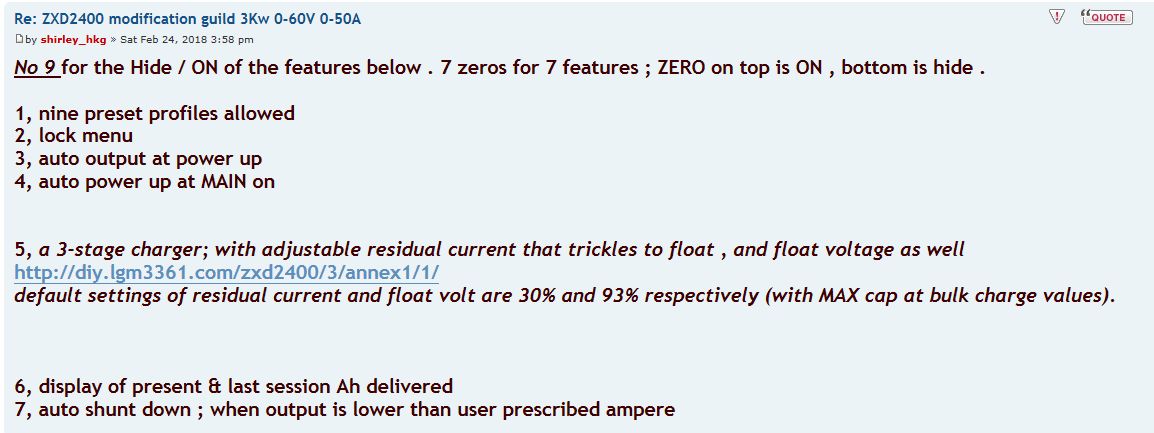

Postby shirley_hkg » 24 Feb 2018, 08:58
No 9 for the Hide / ON of the features below . 7 zeros for 7 features ; ZERO on top is ON , bottom is hide .
1, nine preset profiles allowed
2, lock menu
3, auto output at power up
4, auto power up at MAIN on
5, a 3-stage charger; with adjustable residual current that trickles to float , and float voltage as well
default settings of residual current and float volt are 30% and 93% respectively (with MAX cap at bulk charge values).
7, auto shunt down ; when output is lower than user prescribed ampere

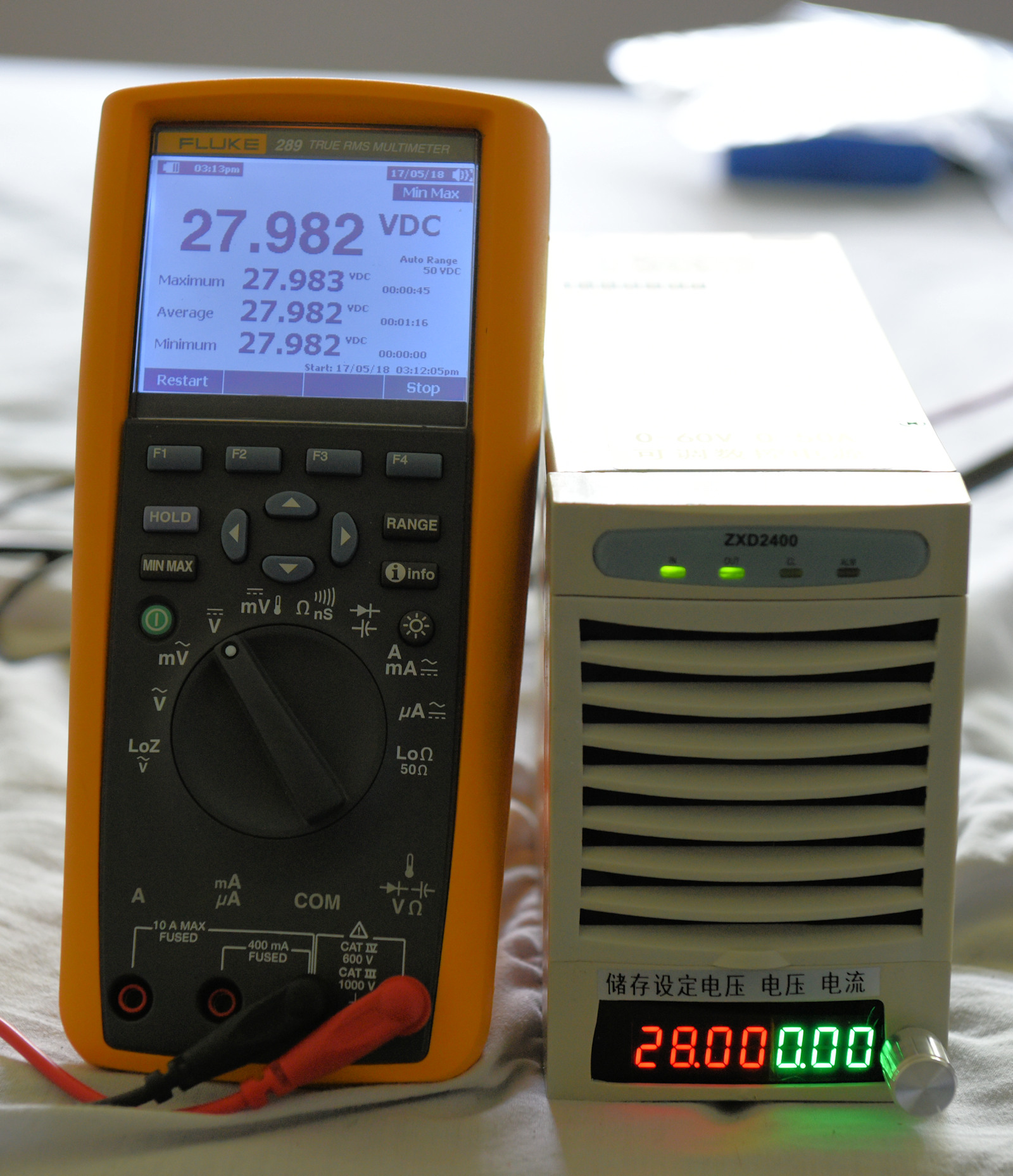

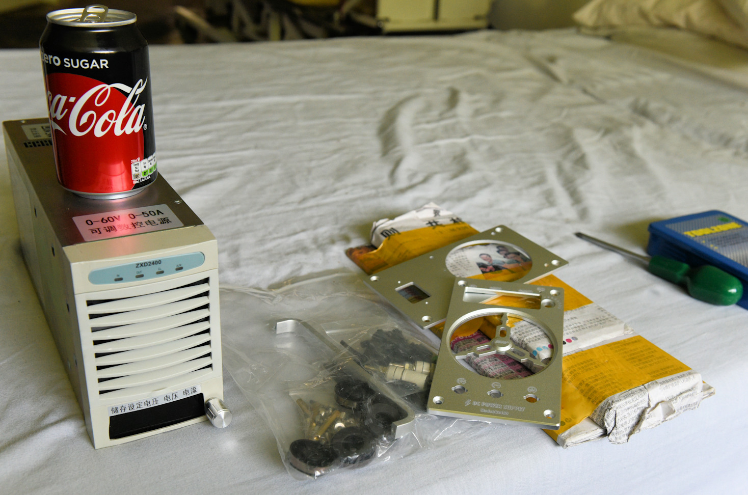

pICS AS ARRIVED
Sorry keyboard is stup[id and types caps!
This thing is 3000 watts, and not much bigger than a coke can!
Front with optional case (not built yet)
Rear with high power terminals. The new case adds some up to 20A termiunals, and a earth/ground to the front as well.

Within 18mV worst case, from 5V to 60V so pretty accurate, Once warmed up. (20 mins) and over 10 min monitoring, varies by just 2mv lower/higher unloaded. And theres no measurable ripple or AC at any frequency on the output I can detect. So far pretty good. But all measured without load.

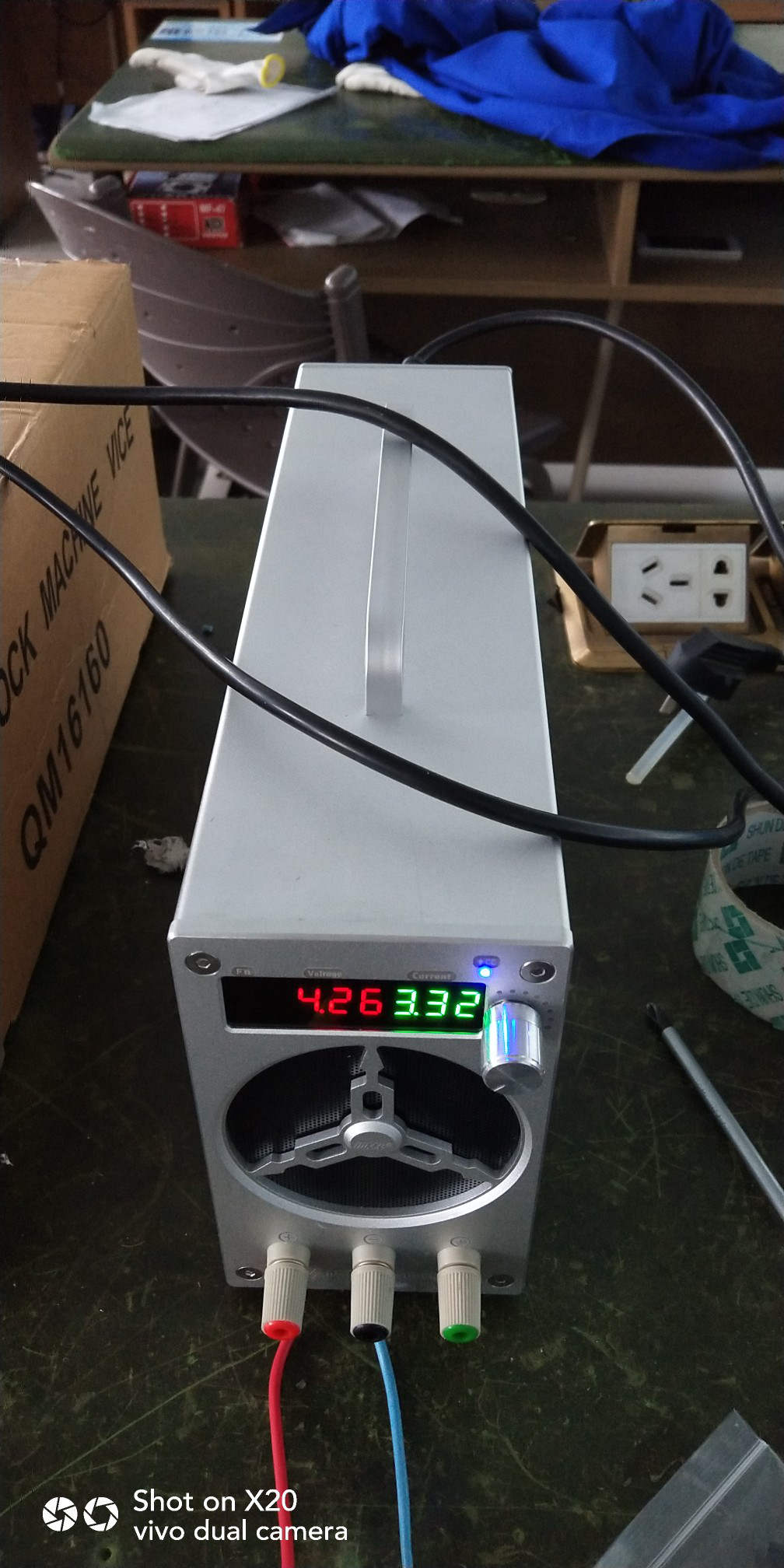

My fancy case is now fitted. But 3 questions.
The blue LED? No clue how its wired...
The display, held at one end by the nut on the switch/dial. And nothing at the other? :problem:
And my 3 pin mains connector was in 4 bits :o . So looking on ebay for a spare.
Otherwise it a really well made case/kit. Looks complicated, and gets much simpler as you go. No instructions? No problem. Just take it apart and it all just falls into place.
Hardly any wiring to do. Just basic stuff. However the provided 4mm banana connectors cant do 50A. They struggle at half that. I know this because my other two bench supplies use identical ones on the front. But they melt is you overdo things! I replaced them previously. So I will be fitting an anderson on the rear. Easy to do. It also has 2 fans that are not thermostatic as far as I know. They just start up with the power. So will be adding a heat switch to those. So they start up if the heat sinks exceed 40C. And 50C. Rear one first. Then the noisier front one if required.

Postby shirley_hkg » 18 May 2018, 02:35
The CL on the front will lit when in CV mode , so is treated as CC / CV indicator . Its orange in colour . You may change it with the blue led provided .
The encoding knot is held only with a thin nut in front . Just unscrew it and push the knot back in .
The fans are thermally controlled by the PSU , so any fan will do.
Yes , I'd like a better pair of power poles too.
