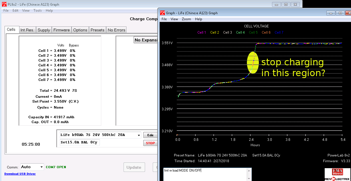

this is a typical charging one of my two 7S5P headway 38140S packs.
a good balanced charge
as you can see, the pack took 41917 mAh and was perfectly balanced.
given
" Lithium batteries hate being fully charged, ... "

does it make sense to stop charging early most times? and fully
balance/charge occasionaly?

Postby expresso » 21 Apr 2018, 18:14
From the looks of that Graph - You are already not fully charging - i mean its already being stopped - at 3.55V your good and you should balance them all the time - i believe this to be correct way - BM will correct me for sure - its looking good :)
Postby Burgerman » 21 Apr 2018, 21:30
I charge at 3.550V per cell. The manufacturer says 3.650. Why? Because that much overcharge allows a degree of natural balance as the full cells cant charge more. and energy is wasted as heat. So they get less cells back as damaged due to use of unbalanced cells. They do that because the typical charger is a 2 wire dumb charger and relies of a typical BMS which has too low balance current and lets the cells go over and under the target voltage for many hours while attempting to balance...
You can reduce it to 3.525 or 3.500V if you want as a minimum, but charge time will be slower, longer at CV before true balance is achieved.
Your CV time is already too long though. Whatever the termination point mA is on tha PL8 now, increase it by 50% at a time until you get a termination at about 1 to 2 hours after it attains a balanced CV top voltage. On your graph around 3.6 hours point.
You only need longer at CV if the pack is slow to balance. If its good, as yours is, set termination Ma higher, CV timeout to say 2 hours, too.

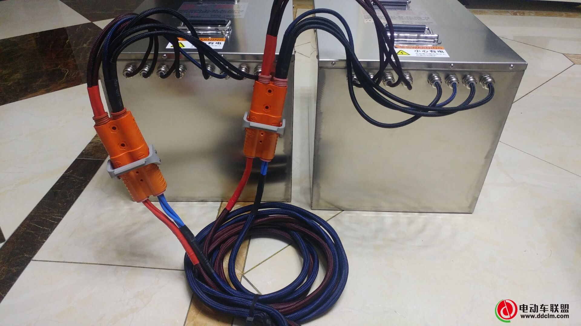

Postby shirley_hkg » 24 Apr 2018, 08:58
Cool connector. What's it called ? :dance
Postby Burgerman » 24 Apr 2018, 10:57
Dunno. But its huge! Unless thats a photo trick. :problem:

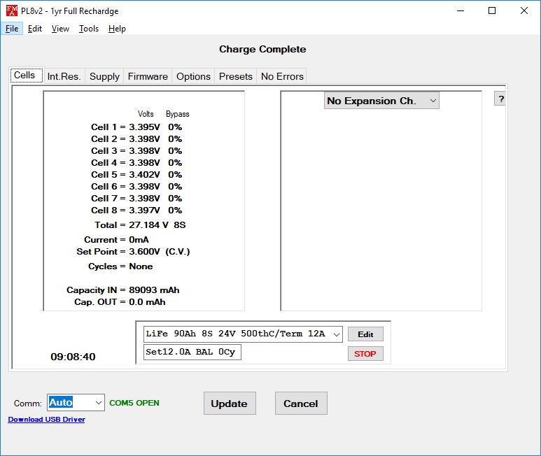

Doing a bit of maintenance on my chair getting it ready for warm weather. In the process I pulled out my battery pack and decided to see what kind of shape its in after one year of use. I fully discharged my 90Ah pack till one cell hit 2.9v, then charged it back up.
So 89Ah returned. With the charger not violating the laws of thermodynamics, that means the actual amount of power returned to my pack is a bit less than that. So in a year on I've had a bit of degradation. I'm not surprised by that. A big heavy chair and a big heavy me, with a fairly small pack. I'm off pavement quite a bit, so I'm working the cells hard.
Still though, not bad. It might be good for me to build a 30Ah add on pack at some point. 90Ah has proved to be plenty of range for me. But with the add on, it would lighten the load on the cells a bit. Especially when I know I'll be going on hiking excursions etc.
With the PL8 saying 89Ah returned, what's the best guess of the actual capacity of my 1yr old pack now?
Postby Burgerman » 27 Apr 2018, 19:54
So what Ah was REMOVED from the pack, when the first cell hit 2.9V?
THAT is the all important figure and deadly accurate.
With the following provisos:
Never test to full capacity, unless a spare cell, since its very bad for the cells and you can finish up with a cell that has increased self discharged rate very easily. To test and measure FULL capacity you must discharge at around 0.1C to 2.50V. Or use a higher rate and a CV discharge to 2.50V.
So unless looking for ultimate capacity measurement at 100% discharged never really try to go lower than your 2.9v (or 2.8v at the very lowest). But that wont measure full capacity. Theres also a false drop off at around 90 percent discharged that looks like thats it. But that flattens out again for a while if you keep going. But best not to try that unless you are desperate to make it home... So you will measure about 11Ah this way from a true 12Ah cell if you discharged it fully at a low rate.
You cannot measure Ah back in with any level of accuracy.
I would be surprised if theres more than 3 to 5% loss of actual capacity. You cannot measure Ah back, to determin capacity that way. For these reasons.
You do not know how much was left after you stopped discharging. So you might get only 90Ah back into a 100Ah battery to be 99% full because it wasnt empty. And the last 1Ah to 3Ah may take 6 or 8 Ah to complete due to thermal losses and balance losses (1A dumped to a resistor begining as soon as CV is reached, which all add up.
These losses depend on balance settings, and termination current as much as anything. But also in cell internal losses at 3.600V. And on resistance in the whole system. The loom, cells, and the charger all have internal resistance and get warm. Its quite normal to be 97 to 99% efficient at the early part of the charge. And much less as charge starts to reach CV.
I dont think it is very helpful. What did it take out? Add to that say 5 to 7% remaining that you didnt remove. Thats more realistic.
But at a guess I would say about 3% less than when new. Going by my own packs. Unless theres a fault.

Postby Gnomatic » 27 Apr 2018, 20:28
Thanks for the reply.
I don't know how much I took out Without a supply with adjustable voltage, I'm not able to use my load dump and the PL8 to do a regen discharge the way you do, with the PL8 controlling the whole thing, measuring how much power its taking out of the pack etc.. And w/o regen discharge with load dump, the PL8 is very slow by itself when discharging.
So I just connected my ~20A load dump to my pack. Used the PL8 to monitor, and when cells hit about 3.1v, I disconnected the load dump, and used the PL8 to finish discharging. Then charge the pack up.
So your 3% best guess is all I was asking for. My intention was not extreme precision. So all in all my pack seems in decent shape after a year of use. No returning to lead bricks.

Postby ex-Gooserider » 01 May 2018, 02:40
shirley_hkg wrote:Cool connector. What's it called ? :dance
It looks like some sort of Anderson variant, but that doesn't help much. I tried looking at http://www.ddclm.com/ based on the name in the photos, but the site is in Chinese or similar ideographic language, and I don't see any buttons for getting English, so you are probably better off checking it out than I am... cheers
I'd say the nicest thing about it is that little lever setup to ensure positive hookup and locking - might be really good for our members that have trouble manipulating regular Andersons...
