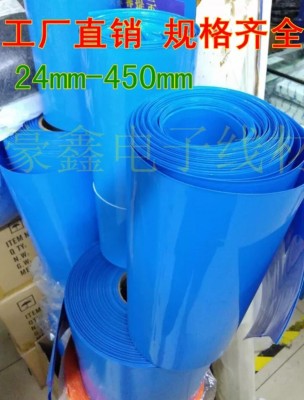

Fold electrical insulation paper around it , and shrink wrap it.

@Furio: Firstable I insulated the battery box by a 0.5mm amiang sheet. It's very solid and cheap (about $4 for 1m2). Then I wrapped each pair of cells by a 0.5mm silicone sheet and sticky tapes. I note that the silicone is very durable, 0.5mm is already strong more than enough. The sticky tape is specific to wrap lithium cells. It is very special, I see it the first time. It is made of mica, very sticky, thin but solid.
Links to buy silicone sheets and sticky tapes
https://world.tmall.com/item/5244358338 ... 0936362501
https://world.taobao.com/item/387284724 ... bbceJuyQ1E
I wrapped the pack the same way we make our traditional rice cake :mrgreen:
https://www.google.com.vn/search?q=goi+ ... 60&bih=702
Here is the final result
https://photos.app.goo.gl/E8tmjESjqjsB3zhZ7

https://item.taobao.com/item.htm?spm=a2 ... =14#detail
or this?
I'm interested if so, and can still ship to US. cheers :dirtbike
