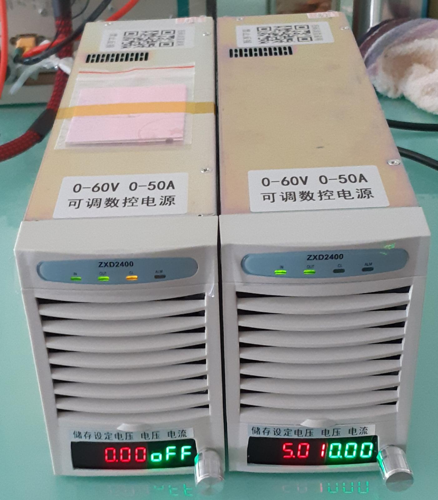

Hope to post PSUs at weekend . cheers

Two new PSUs are checked . Everything is fine . :clap
