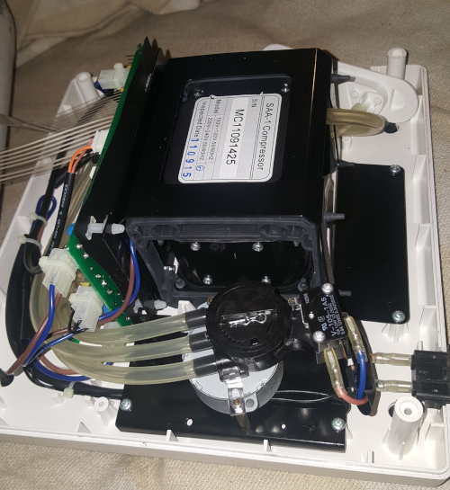

Tell me is it good for pressure ulcer prevention, and do you have any pictures of its internals or without cover?
Mine will be here tomorrow. But I will be sitting on it making photos a bit difficult!!! :cussing

The internals of the box.
Do they work? As you know everybody is different, all I can say is they work for me. I'm trying to find a side-on picture of my chair I took a while ago to post showing where I've mounted it.

Yes that was an american site, and a cushion that costs plenty thousands!
Looks like most of that pump does nothing much? There are many pumps on ebay very cheap, and smaller. So if the battery one is noisy I will buy an ebay quiet 240V pump, and redesign...
Thanks for the pic.
