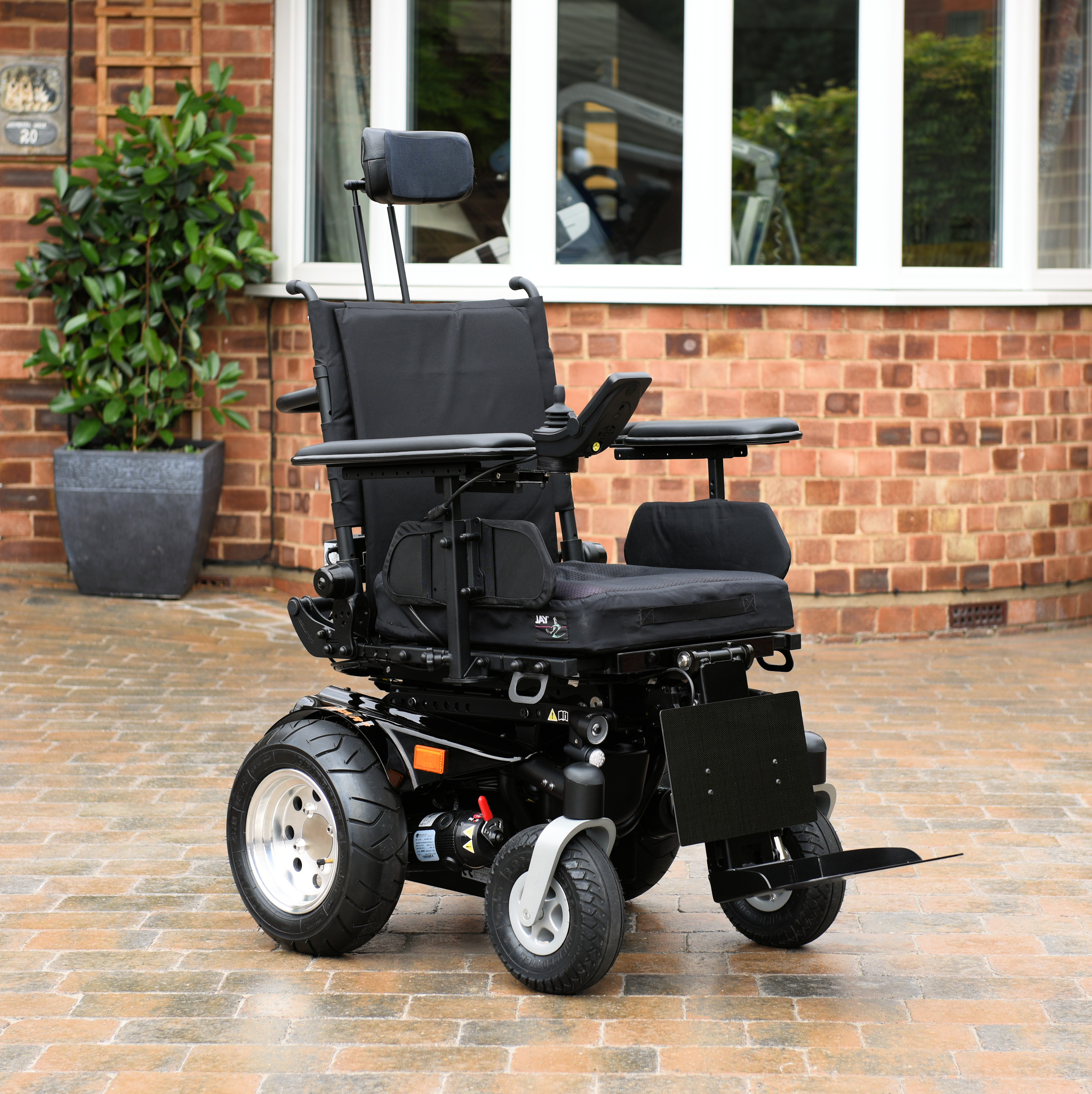

SUMMARY
This is currently the best rear wheel chair currently available on the UK market, SUBJECT TO A FEW SIMPLE MODIFICATIONS, having looked at and tested most. With the possible exception of the V4 magic mobility at stupid money.
With the following ESSENTIAL small changes, to make it work. Without these its hopeless like all stock rear drive chairs are. If you want a current rear drive powerchair that works in the UK, you need to do the following:
ESSENTIAL MODIFICATIONS
1. Seat moved back (without this you can forget about ever steering properly or use indoors, or soft ground)
2. CENTRE footrest was ordered, from the mid drive chair and actuator modified a little to stop a tyre hitting it on the left side as it was designed by an idiot. So that the essential relocation of the seat could happen. I.e. moved back, along with the footplate without caster collisions that swing away foot rigging cause. Those are a definite no!
3. Seat angle adjusted (new holes drilled in front mounting).
4. Black paint - custom order. Not essential...
5. 120A controller for adequate torque, with ESSENTIAL OEM level, severe re programming, so it will actually go through a doorway.
6. Cut push handles short as they are a rediculous length that hit everything indoors as you turn or manoever.
7. Joystick swing away mount is both dismally flimsy, wobbly and in the wrong place if you ever want control. So is modified to put it on the inboard side of the arm, re-drilled ACCURATELY with longer bars, so it misses the arm, and does not wobble... And raised by 3 inches to make it possible to steer and control properly once programmed to respond.
8. Headrest stock abysmal mounting scaffolding affair binned, it was rediculous, and new headrest mount made. Now it doesent look so bad, and does not demolish your home as you manoever about indoors.
9. New rims, and tubeless tyres fitted, making it 27.4 wide. Mostly because these are strong, and tubeless. And because the chair is seriously heavy and stock tyres are sevrely overloaded.
10. New black caster tyres... Not essential!
11. Front lights relocated inboard so the dont hit everything in sight and get smashed against my bed when transfering.
12. Backrest actuator/backrest modded slightly to allow greater recline angle.
13. Single post arms selected and moved forward - not the swing upward wobbly ones... And wide P shaped tops.
14. Seat set to 20 inches wide.
15. 4 pole 6mph motors, 2 pole or 8mph have inadequate torque.
16. Many small details, that theres no room for such as modifiing the footrest actuator mountings, and replacing the pad with a thinned carbon sheet to allow correct positioning, etc etc.

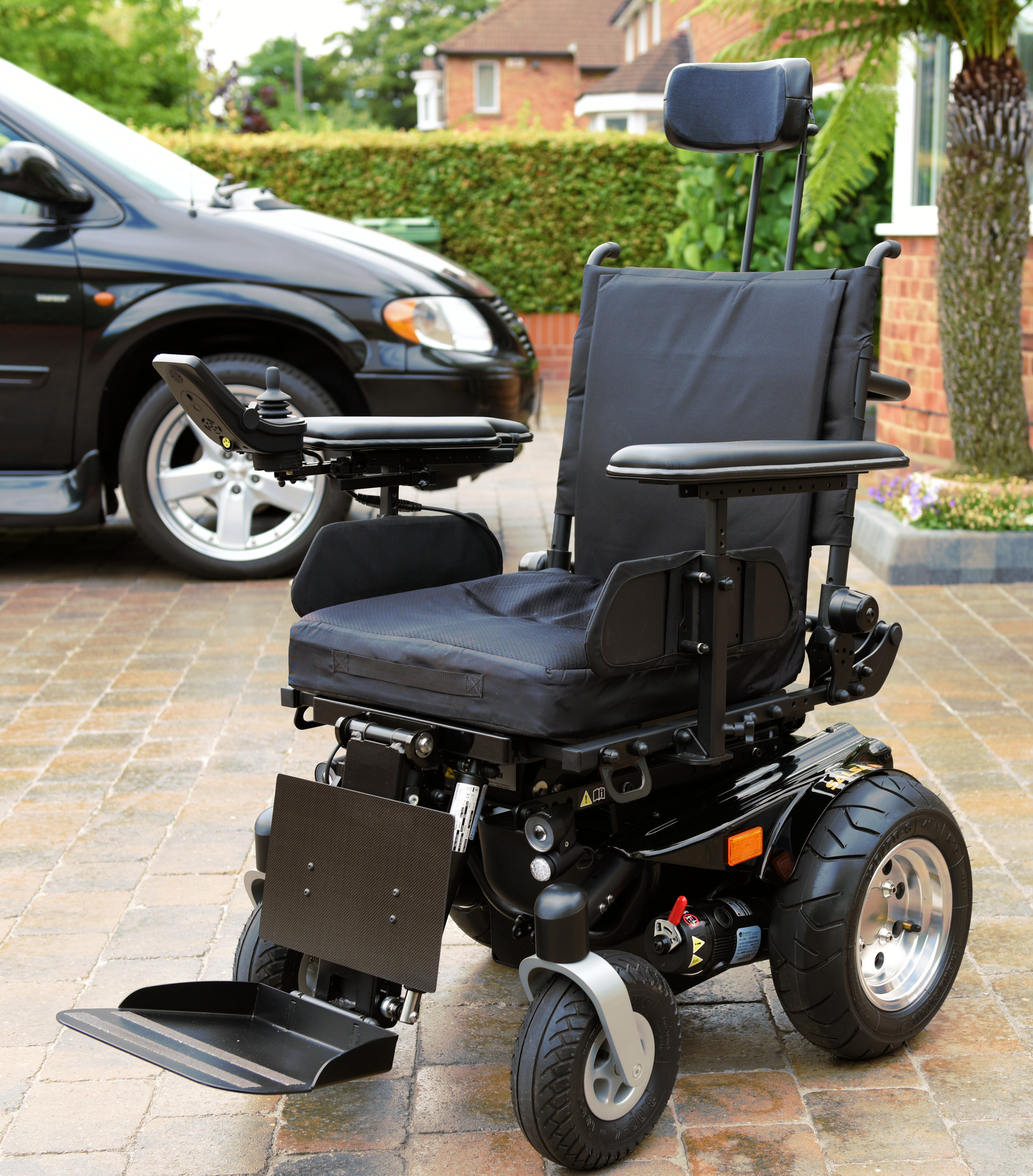

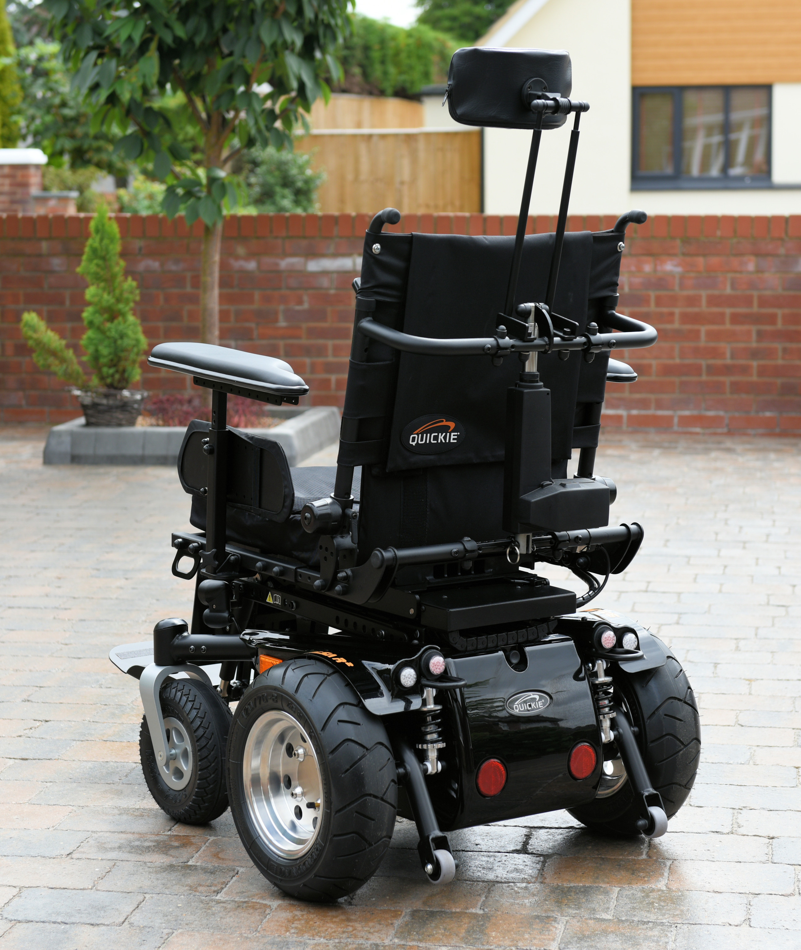

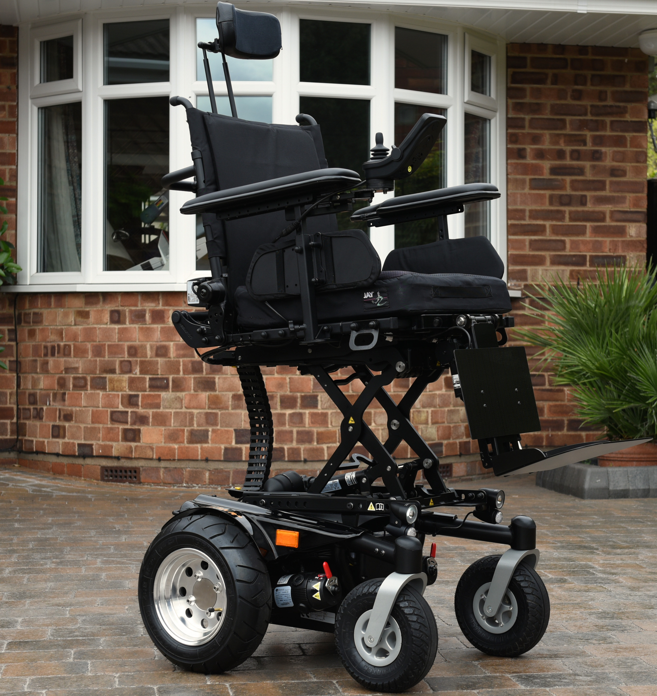

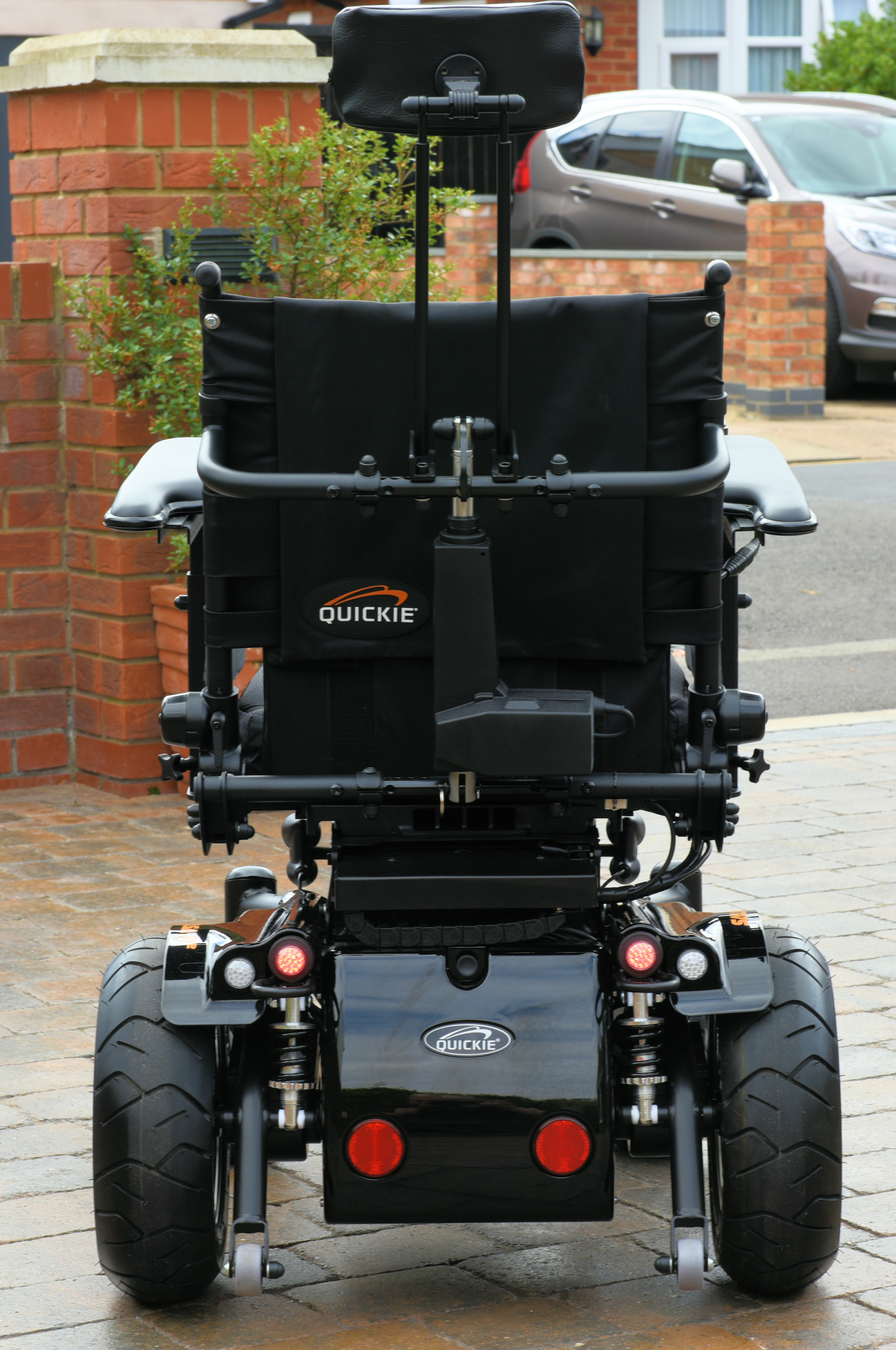

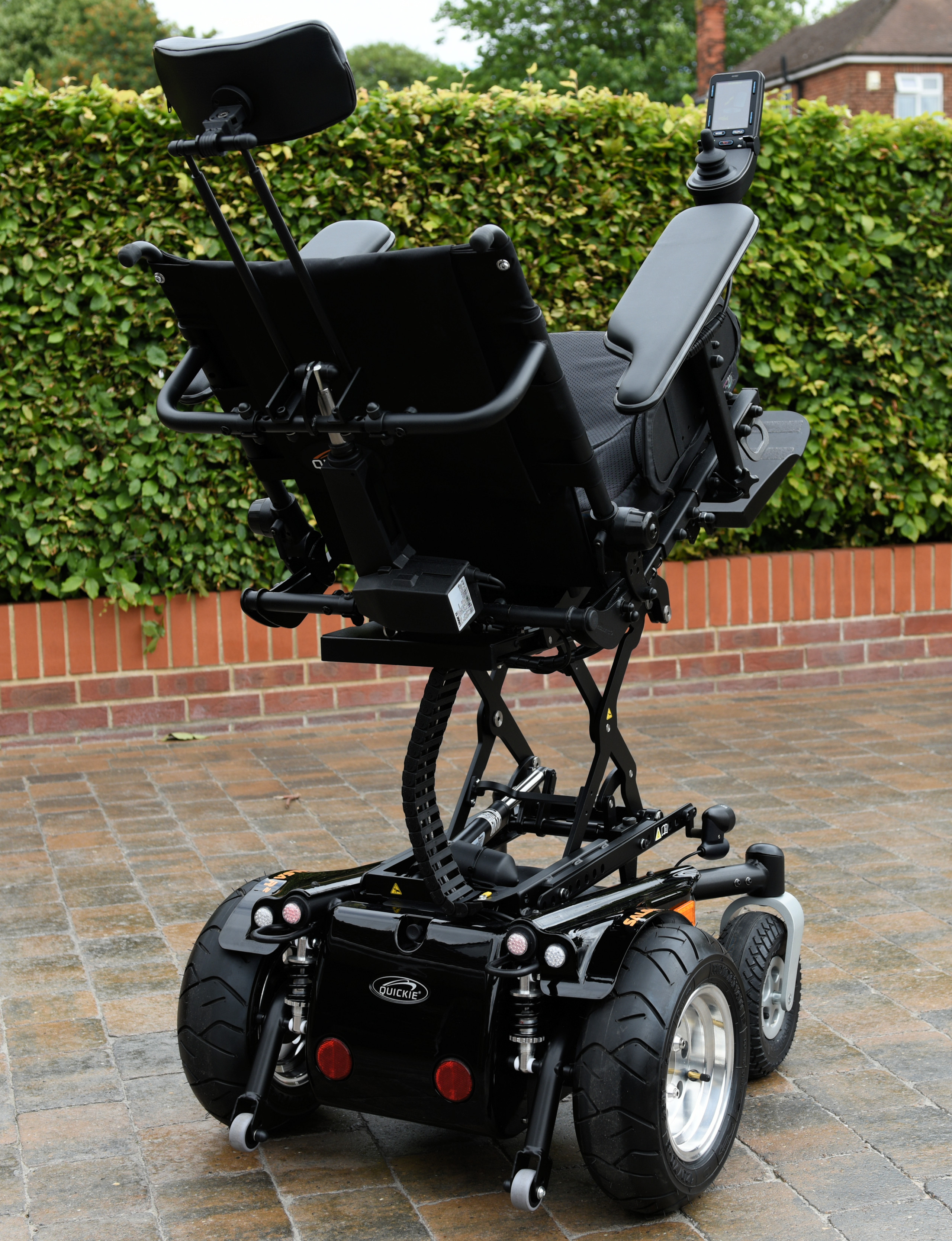

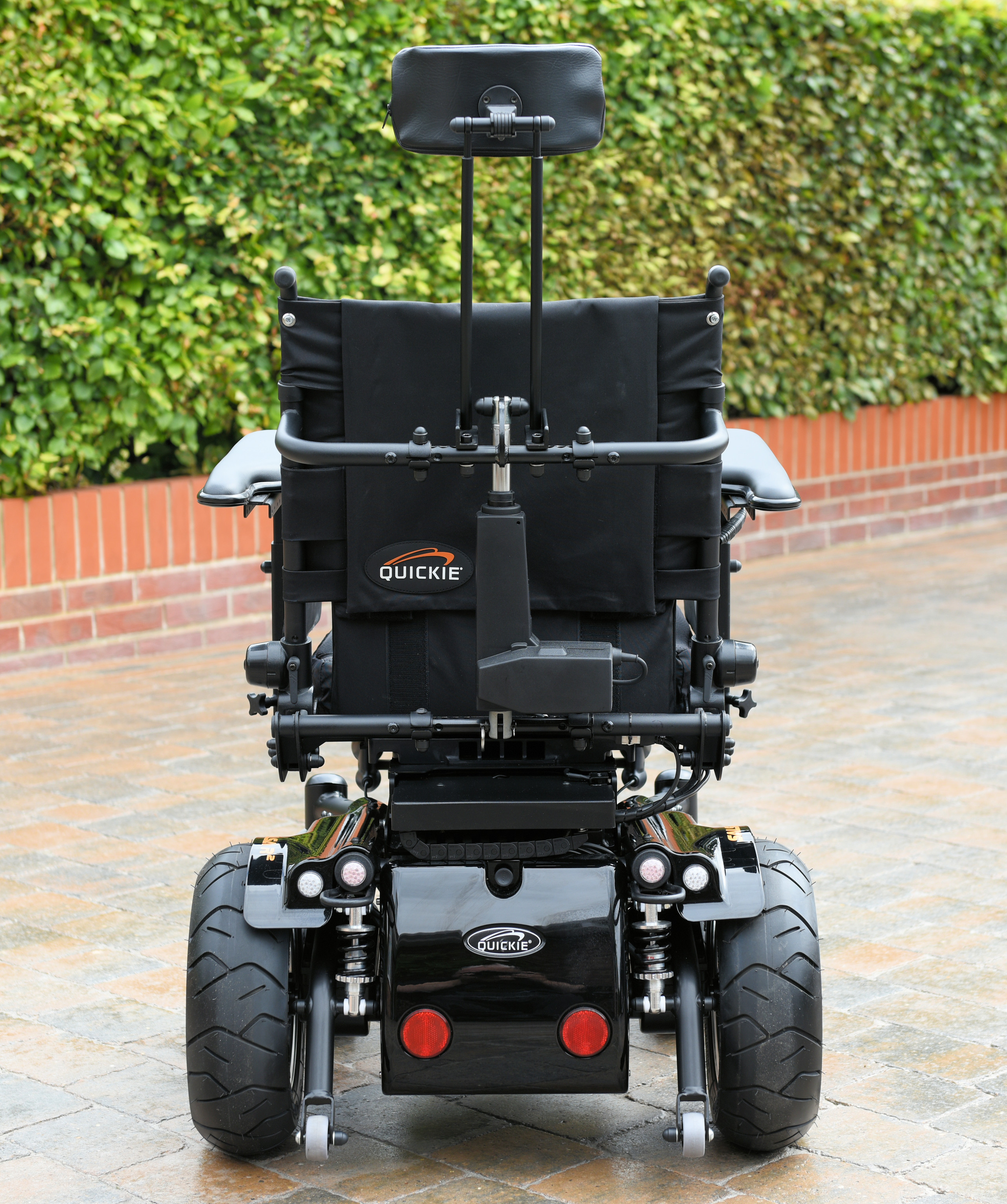

PICS, SEATING DOWN
AS ABOVE!
MODDED ACTUATOR POSITION SO TYRE DOES NOT HIT IT.
NOTE JOYSTICK MOUNTED FURTHER INBOARD. SWING AWAY MODIFIIED AS STOCK ONE WOBBLES AROUND LIKE A DRUNK PREVENTING GOOD CONTROL ONCE PROGRAMMED CORRECTLY SO YOU CAN ACTUALLY STEER THE THING.
SEAT RELOCATED REARWARDS TO CORRECT CG POSITION. MADE POSSIBLE BECAUSE OF LIGHTLY MODIFIED POWER CENTRAL FOOTREST. BECAUSE YOUR HEELS GO BETWEEN THE WHEELS.

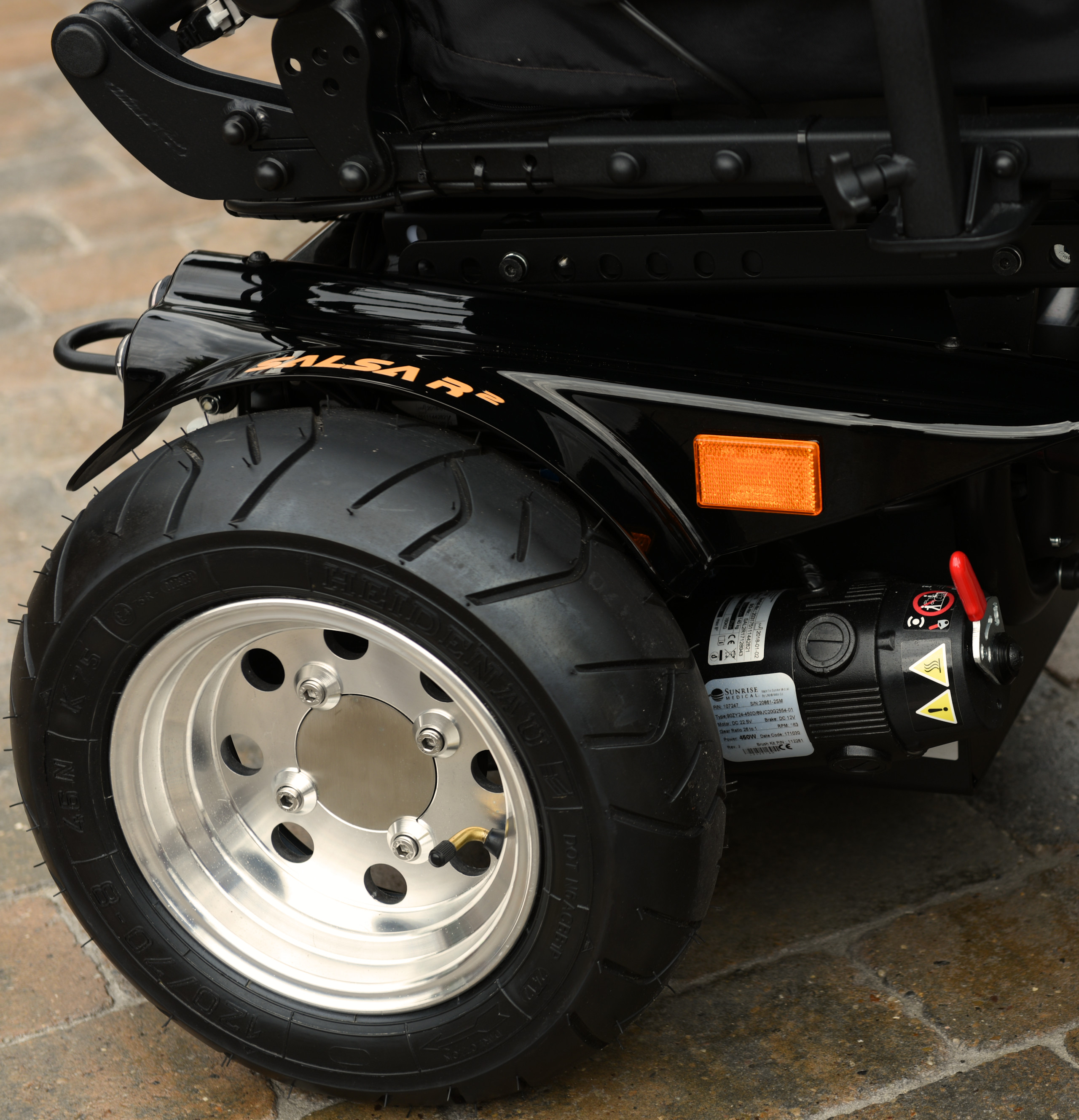

ALSO BLACK TYRES... NOBODY LIKES THE GREY INSTITUTIONALISED LOOK. 10 INCH TYRES FOR GOOD OUTDOOR AND SOFT GROUND CAPABILITY.
THE REAR ARE OPTIONAL. MAKES THE CHAIR WIDER. TUBELESS 120/70 - 8 ON 3.5 WIDE RIMS.

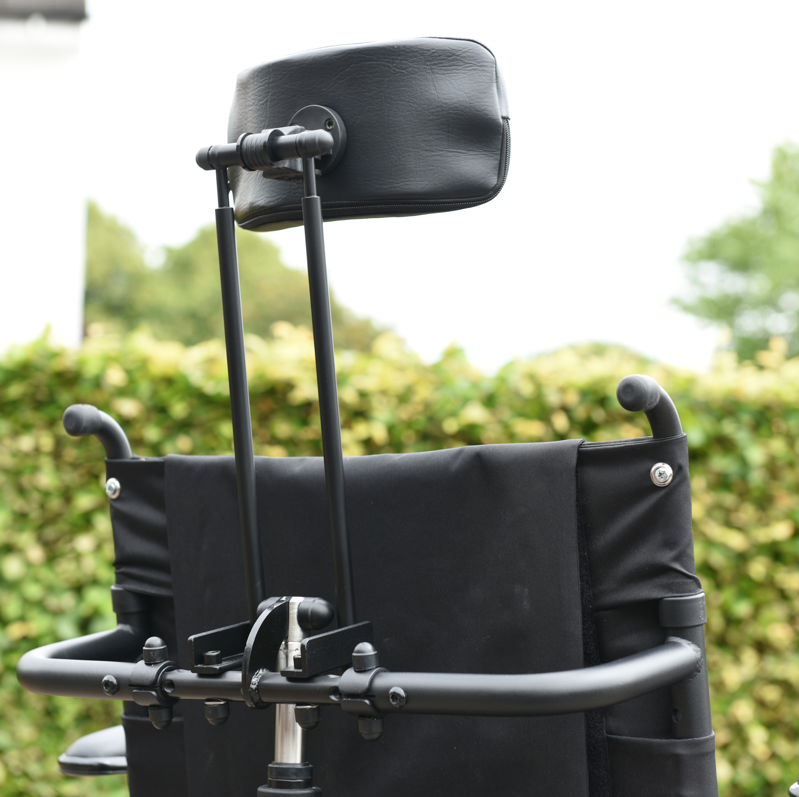

MODS: REMOVAL OF BULKY UGLY, IN THA WAY GOD AWFUL HEADREST MOUNTING SCAFFOLDING, AND PUSH HANDLES.

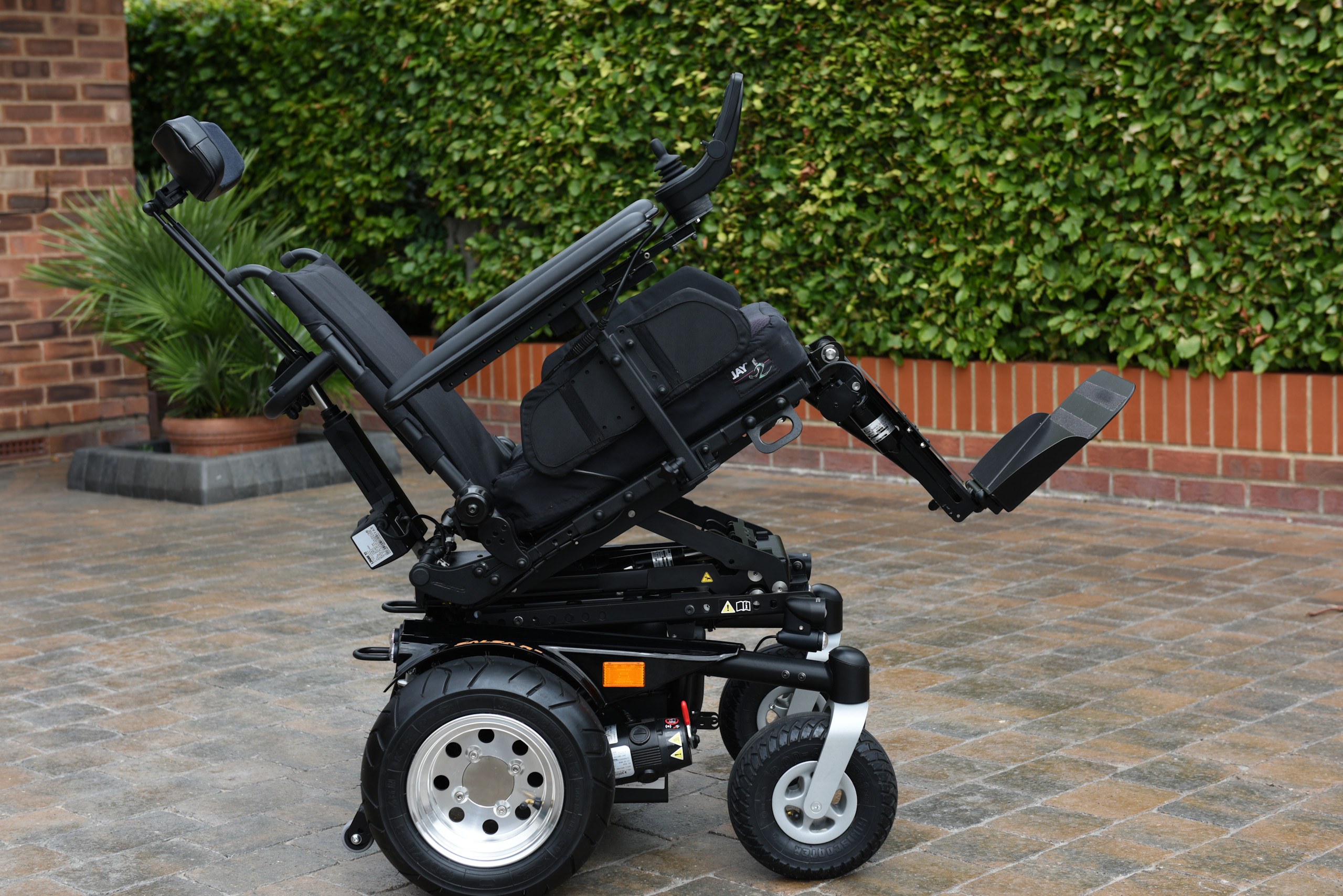

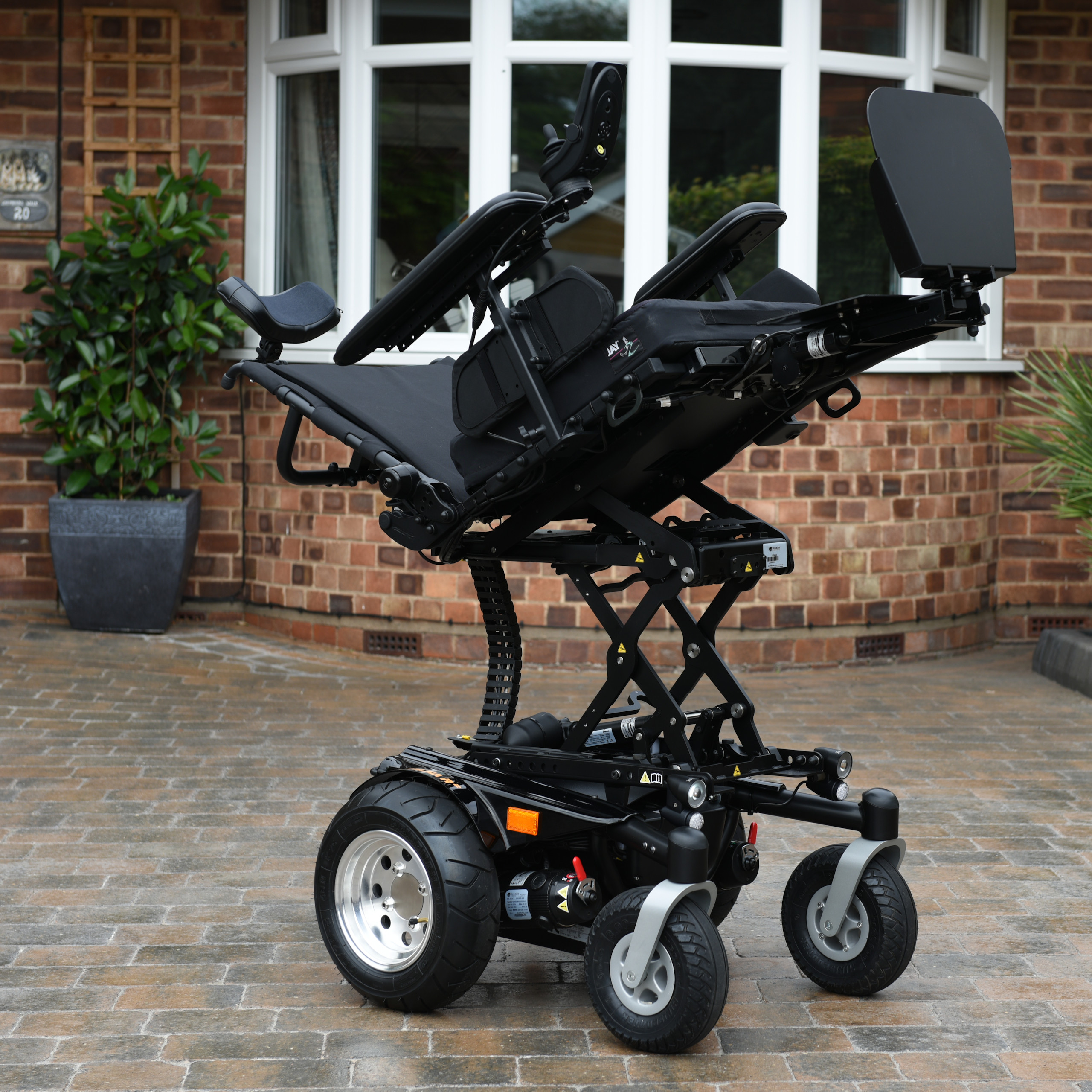

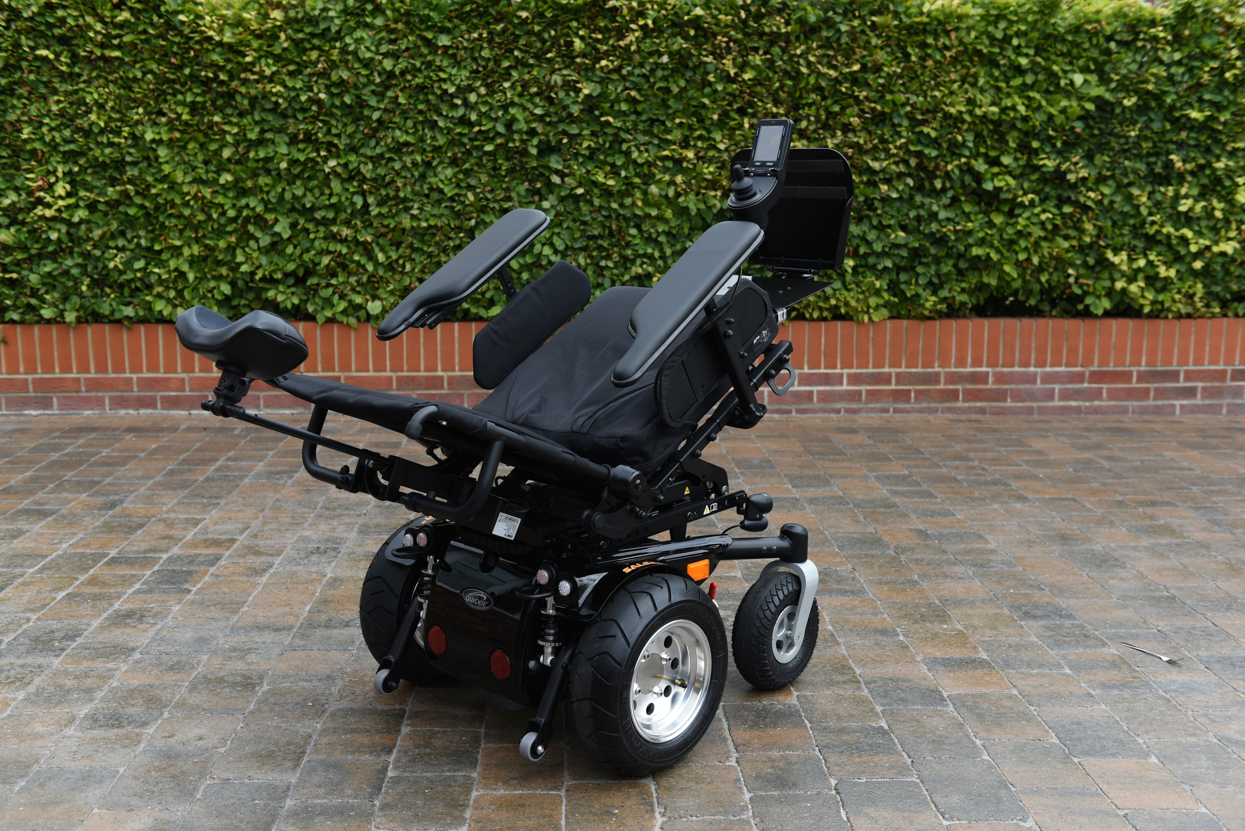

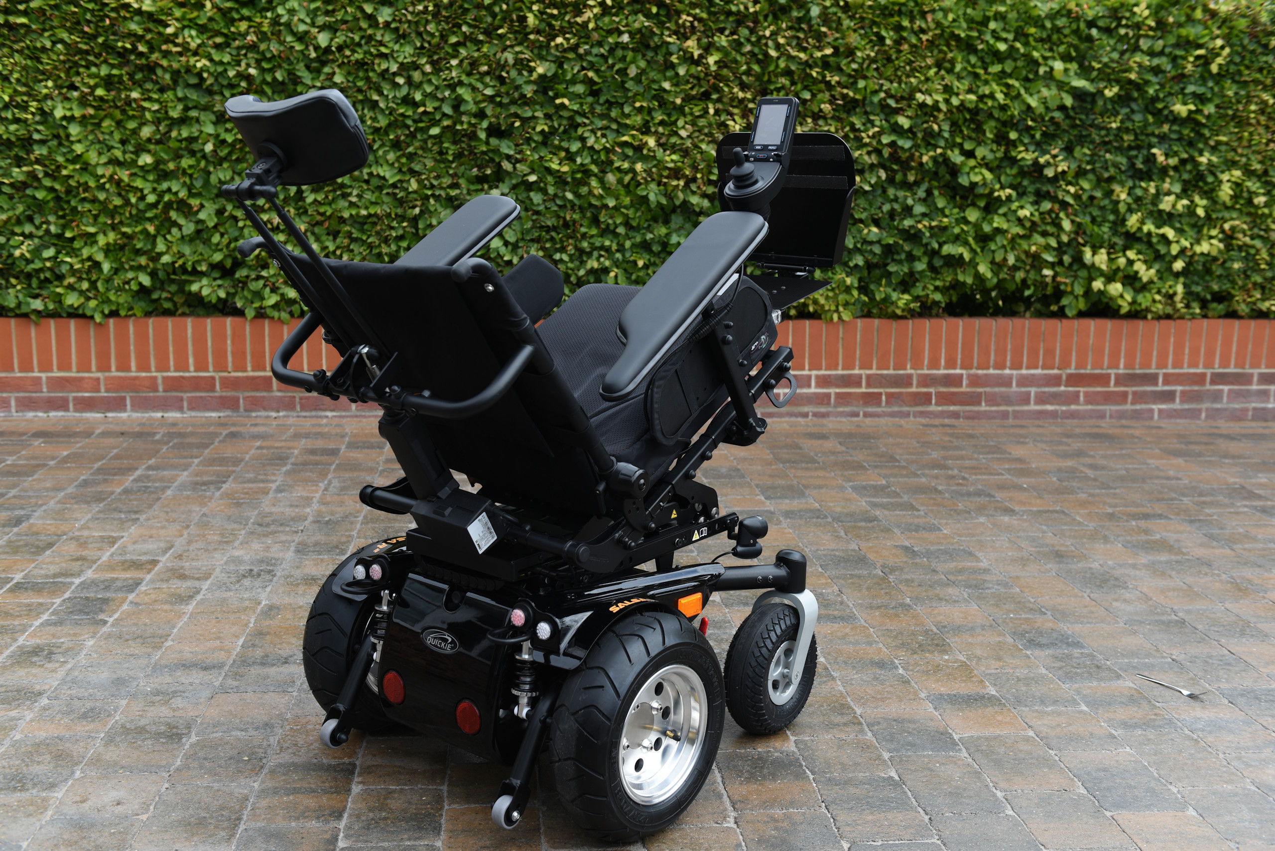

SEATING
Raised and tilt.
Lift only
Tilt only
Tilt and footplate
Recline, tilt, footrests.
Recline, tilt, lift, footrest.
Recline, tilt, lift, footrest. Again from front.

Fency , ahha . cheers
Now look at a 210Ah mushroom cloud generator inside .
drunk2 drunk2
Postby Burgerman » 02 Aug 2018, 01:59
BITS THAT MATTER!
Tubeless rims and 120/70 - 8 tubeless tyres.
Removed the 30mm thick pad that stops my legs and feet sitting correctly on the footplate. Who designs this stuff? Replaced with a bit of carbon fibre, saving about 4lb of steel plate and padding/fake leather.
Moved light inboard as they stupidly stick out to hit the bed as you transfer and everything you get close to. Again, why do they do this?
And heres how close the caster gets. Seat lowered, no tilt, footrest moved back.
Headrest scaffold thrown away, and replaced with simple alloy bard and two bits of angle iron. All sprayed black with a can... Actual headrest is crap, so making a better one. Still small. Before all this was thrown away there was literally 12 inches of extra metal sticking out of the rear to hit everything in my workshop, and to wreck the house. What do they think about when making all this stuff? I also cut off the stupidly long 10 inch long push handles, and used 2 small rubber caps. Allows shopping bags to hang!
And... rear lights are actually pretty bright. Can barely be seen in the daylight sun.
Joystick correctly located more inboard, and 3 inches higher to allow proper hand technique for the zero delay programming that allows proper accurate control. This was essential.
Posts: 70441

Postby Burgerman » 02 Aug 2018, 10:12
Mines not so poor. I bought a used one, stripped it, and redrilled all the holes to suit a very slightly larger bolt that is now a tight friction fit. Theres zero slack or movement in it. And the "arms" or bars, are longer so that it swings past the wider jay arm tops. So its now pretty good. But a lot of effort.
Posts: 70441

Postby Burgerman » 04 Aug 2018, 18:05
Not measured it but with seat moved back, and centre fooplate its about 5 inches shorter than stock. But definitely longer than my own chairs. And 1.75 inches wider. But if you want tilt, recline, lift etc you do need some stability. Esp if you are no lightweight!
