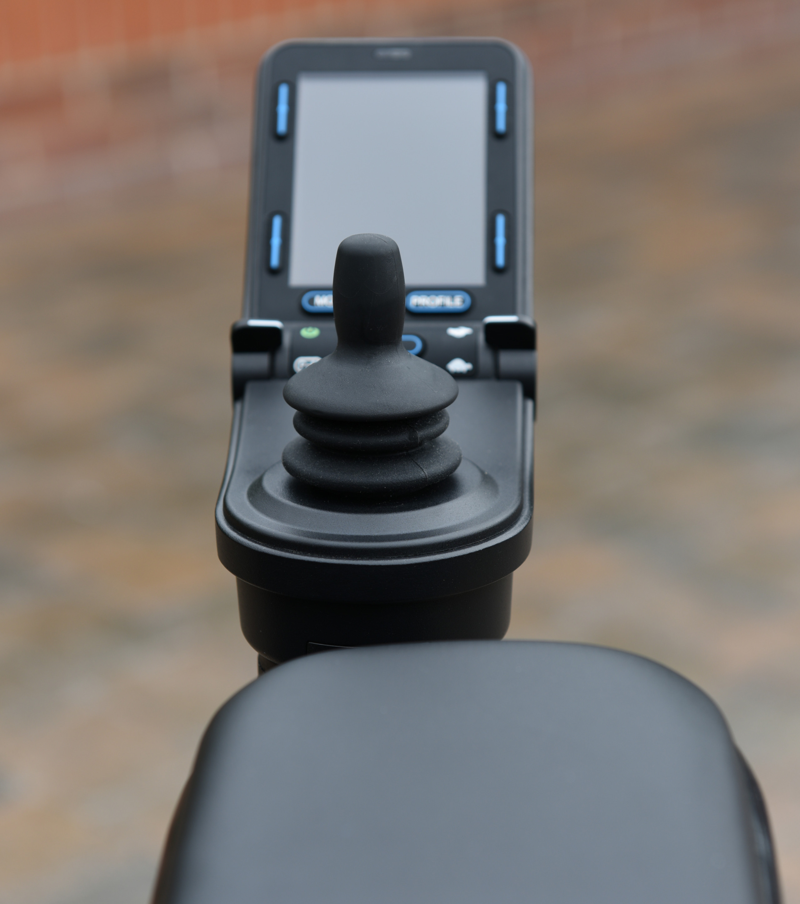

1. It HELPS if you have good hand and finger movement, and good eye / hand coordination.
2. Its ESSENTIAL that the joystick is mounted SOLIDLY with no wobbles or movement in relation to the chair.
3. Its also essential that the joystick is positioned correctly. Most are way too low, and too outboard. ***
*** It needs to be slightly inboard of the chair arm centreline, not too much reach, and the body of the joystick housing needs to be slightly higher than the arm top. So that your hand and at least the two (or three) lower fingers and part of the hand can CUP the outer side of the Joystick body. IN COMFORT! While leaving your stablised hands thumb and forefinger to operate the joystick.

To achieve this may need a little attention from a tech with a drill, a few spacers, some reconfiguration of the arm, a better swingaway as most are frankly crap and also wobble, but its IMPORTANT! Dont allow the tech to tell you its OK. Its not! It must be correct. You just cannot drive a chair thats correctly programmed unless your hand can cup the solidly mounted, correctly positioned joystick in comfort. What will NEVER work is resting your arm on the chairs arm top, and just holding the joystick with your fingers -- which I see all the time.
More soon. You can post here, but for now, I will delete it, to add the next parts in order when ready. :fencing
Watch HAND POSITION and FINGERS only in video.
JOYSTICK POSITION
Inboard, higher than arm.

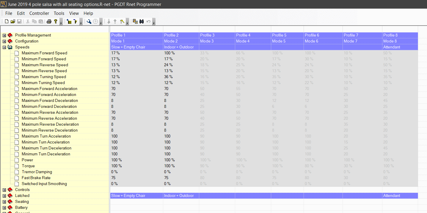

BASIC PROGRAMMING TO MAKE IT STEER!!!
First, do the above!!! It matters once programmed.
These are not actually my own settings, but are a tamed, steady, very controllable version which will allow accurate steering control, and will work from 2mph up to maximum speed of 6 or 8mph. It will make your chair work properly and steer properly for the first time ever. First a couple of screenshots. You may do well to try these image settings below as your starting point. EXACTLY as shown.
Note: I only have 2 profiles enabled. And I use only profile 2.
Profile 1 is just for moving an EMPTY chair around.
You can have as many as you wish. But one is plenty if set up correctly! Its all thats required, or wanted.. You can have more, but you will wonder what they are for.
NOTE ALSO: You or your tech, will be unlikely to be able to set many of these settings to these levels, with a DEALER level programmer. Due to hidden walls being set up. So in this case you will need to use an OEM level tool, to set all the "walls" to either 100% or 0% using the OEM software, in the OEM, ABS section shown in the image below.
So COPY these settings below first, to remove the safety nazi walls...
That then in turn allows you to set the turn acceleration/deceleration settings to a high enough figure so it responds in what feels like real time.
Remember that many of these are ball park starting figures and are "safe" test figures. Copy the speed setting figures in the top image (the ones in profile 2) to your system. These are then to be updated to your choosen figures later if needed. These are MY figures, they work to give a very linear and easy to drive accurate chair. At indoor speeds when set to slow. And outdoor speeds when set to fast. You only need this one profile.
(My profile 1 is intended as a really slow indoor only setting for people moving an EMPTY chair. You can copy that too if you want this)
YOUR changes to this, may include for e.g: if it accelerates too fast, and set to 70 it might, then reduce Forward Minimum and Forward Maximum Acceleration levels. But make ONE change at a time! And test that alone until its how YOU want it. If its too jerky at very small stick movements, or very slow speeds, reduce TORQUE till it isnt. But you dont want this set too low. Its a compromise.

Postby Burgerman » 12 Aug 2018, 02:12
If you program a chair to properly, instantly, and proportionally react to the stick, then technique is everything. If you are doing what I think you are, like most others also do, theres no way on earth that you can ever control the chair without thinking its jumpy... Its not. Its doing what the stick tells it, when you tell it.
But by holding it how you do, your arm moves in relation to the pod as you accelerate with pulls it back again, which pushes it forwards again, rinse and repeat... So you are commanding the jumps! You want control, you must have the correct holding technique.
Imagine drawing a neat square on a sheet of paper mounted on a clipboard. You are a passenger in a car on a very bumpy road.
You have 2 methods.
1. You hold only the pen end with your fingers and the page is fixed to the car.
2. You hold the pen properly, and place your hand down on the page for stability as normal.
Which gives a good square? And which is nearly impossible?
Repeated from post 1 since I cannot stress how important this is!!!
IMPORTANT. Preliminary basic 101.
If you want to re-program a chair to steer and drive accurately and naturally with the sort of easy control that is just transparent, you never even think about control, then the following preliminary must be true also. Because after correct programming the joystick will change from a pudding stirrer that you just mash about and wait and hope, to a fully proportional control with no turning (or turn stop) delays. The chair will turn when told, and stop turning when told, at the exact rate and time you decide by exactly how much stick you give it. If you have poor hand control, we will come to that later. With R-Net some of this can be done with Dealer level tools that your tech will have. But not all, and with settings limits/walls. So ideally you will need OEM level access.
So:
*** It needs to be slightly inboard of the chair arm centre-line, not too much reach, and the body of the joystick housing needs to be slightly higher than the arm top. So that your hand and at least the two (or three) lower fingers and part of the hand can CUP the outer side of the Joystick body. IN COMFORT! While leaving your stablised hands thumb and forefinger to operate the joystick.
IT MATTERS!!!

Postby hank » 19 Aug 2018, 18:31
John Rnet 120 PM settings to wheelie from stand still as shown.
does maximum forward acceleration need to be 100 not 70
and minimum forward acceleration not 60 as your guide setting shown.
Postby Burgerman » 19 Aug 2018, 18:55
Thats a best guess starting point. ALL of those settings are. Set it to whatever you prefer. Mines set to 100. But most people cant handle that. And be careful. 100 is not the same on dynamic, PG pilot/VR2 or R-Net. Because even 100 has some delay. And that delay is different on different systems. So increase in stages, till happy.
