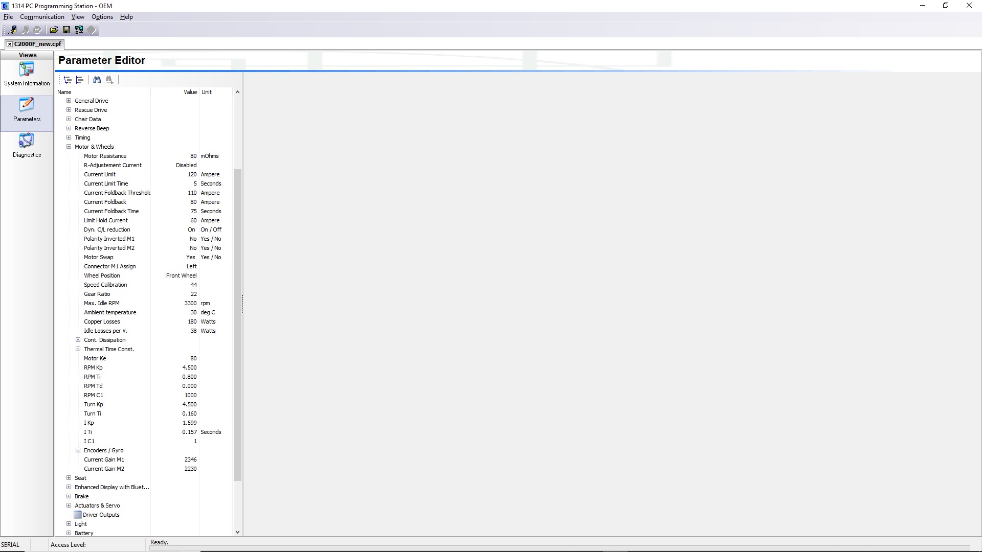

0.057 ohm, 57mOhm but you are then supposed to add some for cables, say 40mOhm, and then set .6 or .7 of that according to pg. Idealy you need a GOOD low impedance capable meter. I would still suggest the batteries.
Or possibly a global OEM level scaler as in the Dynamic software. In that theres a turn and forward and reverse scaler. Set to 25%. If you set it to 50% you double the acceleration that a user setting of 100 has. Maybe theres a similar thing available in the curtis instruments software. I would like to look throught the settings file here! Hopefully you are not refering to the one above? *** There are also settings fo smoothing speed change transitions that cause delays when you hit go! And additional settings that speed up or slow down initial starting and stopping.
Scrap most of that. It has very few settings! Just looked at the file above.
*** the one above has forward acceleration set very low, also has 20% deadband, also has 30% tremor damping... Just to begin with. Thats like pushing go and then waiting for a bus to turn up.

I have two motors and using both channels. I think the motors should be strong and low ohm.
It’s not my config file.
I have all Accel at 100%, Decel at 90%, Power at 100%
Deadband at 10%, Tremor at 0%
and 80mOhm
It Brakes twice as hard as it Accelerates. About 0,4g Acceleration und 0,8g Decel.
Yes it’s my problem that there are only very few settings shown. In the parameter file are much more. I think the other will need higher access level.
I’ll try if I can change some of this. (But it will take time to get the adapter)
From the technical data the controller is really good, but if there are no settings it’s a big problem.
I don’t know if it has combined or each channel 130A?

Thats what I was talking about. He doesent seem to have that, aparently, hence:
If thats REALLY a OEM level tool you have, then thats it. You dont have access and wont get access to anything better. Although I have seen Curtis instrument controllers with very in depth settings that went way further.
Above...

Postby woodygb » 20 Sep 2018, 09:00
Markus has discovered a way around altering the hidden parameters ..this is HIS modified file.
Note:-
There are 11 distinct valid access levels, many of which are copies with less access than the full level.

Where? The image? Or missing link?
There may be 11 levels. Some are between the 4 allowed by the software (user, dealer, service, oem) and there are some that are intended for curtis only, and that change stuff like servo/dual or single channel use, or that change controller scalersettings and a load of stuff that are beyond anyone but the curtiss electronics/programmer dude that was the designer...
Which we dont normally get access to. Probably a good thing if not used with much care!

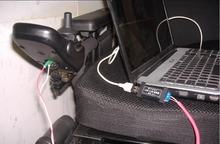

I am new to the world of Powered Wheelchairs. I have a wife that resently started to use one.
She has a OttoBock c2000 RWD and power servo on the front wheels. It is a bit tricky to steer, because it joystik is very sensitive.
I bought a cable of Ebay: https://www.ebay.co.uk/itm/154269663991 ... 4269663991 that is opto-isolated. The seller has tried to help me out, but i keep getting the error: Connection failed or a message with checksum error.
Its the new software 4402 that i have running. I also have 4401, but it is missing something, because it does not registrer the cable.
Do any of you know if it might be because of the cable og the version of software, that could be the reason. I saw Woodygbs post regarding the software versions and was also thinking if that could be the problem.
When you first run the later 4402 software it should define a specific USB cable called a Curtis 1309....the Ebay cable is more than likely a "clone" ( using the same VID and PID plus some added coding for the access level ) of the Genuine 1309.
Revert back to the 4401 and I'm fairly certain that the early software will now recognise the Ebay cable.
HOWEVER ...as Rover say's it is the wrong programming cable for the OTTOBOCK C200.
Read this thread from the first post.

Postby Larsen » 02 Jan 2021, 15:32
I was also expecting that it probably was a cable issue. I ordered the usb-can adaptor from Aliexpress this morning. The one Woody linked to.

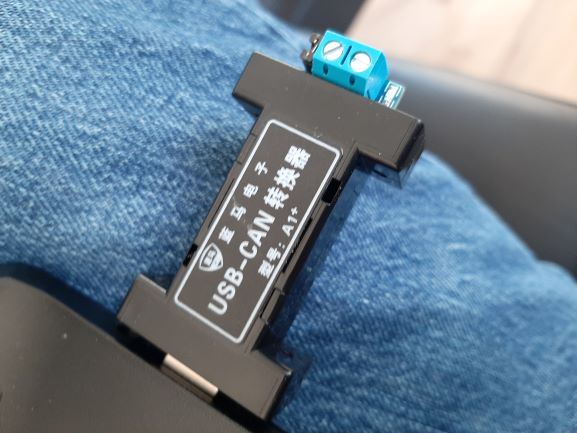

Now the USB-Can A1+ has arrived from China. It is a lmdz.

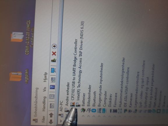

I have a problem with that windows does not generate a com port. It stays in other devices as: CP2101 USB to UART Bridge Controller.
I found a driver on Silicon Labs home page. It generated a Com port, but FT_Prog could not detect it.
Is there an other way of setting up the com port. Is there an other driver that i could try.

You seem to be a bit mixed up with the instructions and Com types.
FTProg is used to alter a FTDI USB cable to make it work with a Curtis control system that uses SERIAL communications and you need to invert the signals with FTProg.
The LMDZ A1 USB CAN requires just the modified files.
viewtopic.php?f=2&t=2757&p=87375&hilit=LM_USB.rar#p87375

This is the adaptor i got.

This is what shoves up in device manager. There is no Com port.

The driver has not installed correctly.
http://microzed.org/sites/default/files ... de_1_2.pdf
Unplug the A1 CAN ...UNINSTALL the driver using Device Manager.
Restart your computer
Download https://www.silabs.com/documents/public ... rivers.zip
Unzip and re-install the driver.
THEN plug in the A1 CAN.

This made the Com port to shove up.
But sadly it is still not possible to connect to the A1 adaptor with FT-prog. Is there a certain bitrate I have to set up, for the connection to work. Or any other settings that has to be set up.

Why do you want to use FT_Prog?
FT_Prog is not wanted or needed with the A1-CAN
Re: Programming Otto Bock C2000
Postby woodygb » 30 Jan 2021, 17:45
You download and install the files that I have linked to and put them in the correct places in the 1314 programming directory...
Then plug in the A1 CAN

Thank you very much Woodygb. :clap :worship
I had it completely mixed up with the way of setting up my other cable. Witch is Serial.
I failed to get the 4402 to work and did as you wrote and used the 4401 and pasted all the 3 files, where they should be.
It all works now. :dance :clap
