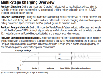

I always keep the charger plugged in as the manual says:
With your ProSport plugged in properly, it will automatically/ fully charge your batteries
while it conditions and extends the life of your batteries. Always leave your charger plugged
in to reduce sulfate build-up allowing your batteries to be fully charged and maintained
for your next fishing trip.
Anyway thanks for the tips and explain.

Here ProSport charging chart (from the manual):

So I have a question - is my charger really bad and killed the batteries?

Postby Burgerman » 12 Nov 2018, 22:19
If that chart is actually what is happening, then yes.
It should remain CONSTANT (meaning it should sit at EXACTLY) the correct voltage, until amps fall to a very low level. Almost no current. Then end. That isnt what it shows.
Why? Can be that you set it wrong? Long cables? Faulty charger, or firmware errors? Would need it here to know.
Its why I use the PL8. I can set the charger to do EXACTLY as the battery manufacturer specifies. To a few mV at CV.
My hobby chargers do an EXACT 2 stage charge, to 1000thC and or 8 hours CV at the correct voltage whichever is sooner.
The graphs look EXACTLY like this:
Posts: 69721
