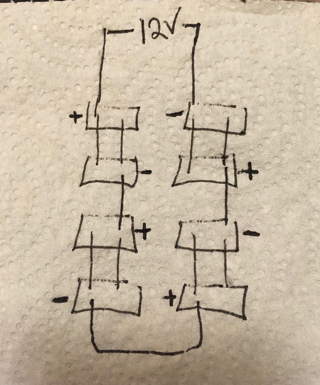

Out of curiosity if one was going to build two physically separated 12v lithium batteries with prismatic cells, is this how they'd be arranged? I've not drawn the balance cables yet as my learning hasn't yet reached that level. :geek:
EDIT: On hindsight if say the polarity of the 4 cells in the LH bank were reversed then it would allow for a shorter and neater end link cable, or something like that. I need some more kitchen roll to make another diagram. :problem:

Postby ex-Gooserider » 20 Nov 2018, 02:26
Hard to tell from the drawing - as drawn you would have major smoke and fire as there are multiple dead shorts between the cells and a larger short across the entire pack... :thumbdown:
The key thing to remember is that electrically there is NO difference between a single 24V pack, two 12V packs in series, or any other arrangement, the only difference is the cabling tying the cells together - length and what the material is.... In a pack the preference is generally for bus bars (metal strips) while going between packs we use heavier cables.... But electrons are stupid and can't tell the difference :) so the only difference is mechanical, the electrics are the same....
The quick and simple guide is that most packs will have groups of parallel cells that are connected in series.
In each group of parallel cells, you connect all the positive terminals together, and all the negatives together, but never connect a negative and positive. From an electrical standpoint, this combines all the cells in the group together into one big cell, with a single positive and negative terminal.
The parallel groups get tied together by connecting the negative terminal of one group to the positive of the next group to make a 'chain' tying the groups together so you have a single big collection with a positive and negative terminal that you connect to the scooter controller...
The balance wires simply go to the positive and negative outer terminals, and the point where each serial connection is made...
Scooterman wrote:Out of curiosity if one was going to build two physically separated 12v lithium batteries with prismatic cells, is this how they'd be arranged? I've not drawn the balance cables yet as my learning hasn't yet reached that level. :geek:
