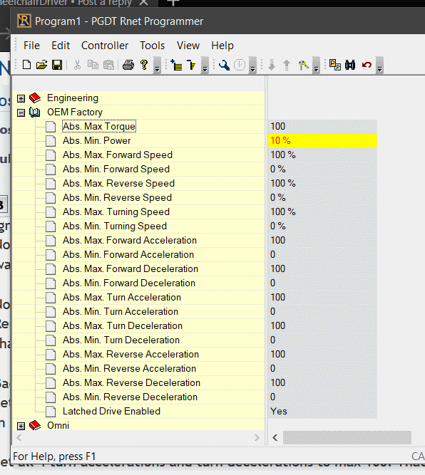

Postby Burgerman » 05 Mar 2019, 21:51
SETTING UP A CHAIR SO IT STEERS.
(DONT do this with a gyro or stability control chair, they are a different problem!!!)
Theres an important order to start with.
Set a single new test profile, if you wish, to these settings.
Set this new test profile's slowest speed (forwards and reverse) with speeds you are completely comfortable with. Probably 15 for indoors and 100 at full speed outdoors? Just copy those figures from your current favorite profile. Or test, ONLY speed achieved. Ignore acceleration and everything else!
Now do the same with FORWARD ACCELERATION, to whatever you are happy with, and set the rearward acceleration the same way. Usually needs to be set same or sometimes much higher.
Now...
Remove walls!!! That is in OEM settings. And set all the minimums allowed to 0. Set all the maximum allowed to 100. All of them that allow this. One may not, choose the lowest here.
So OEM/Factory ABS settings look like this:

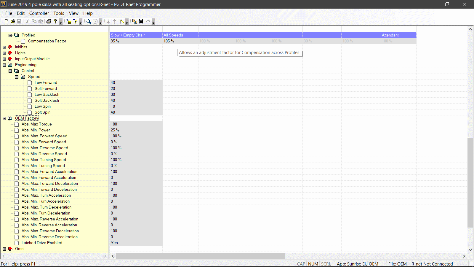

Postby Burgerman » 05 Jun 2019, 15:08
For anyone interested, this is my settings file.
This is for a 120 r-net, 4 pole, (using linix motors) 6mph salsa chair, with all possible seating options etc.
The same drive parameters are going to work for all. But the motor compensation is only correct for 4 pole linix or amt motors. This has a SLOW ONLY indoor/empty chair profile. And a 1mph to top speed profile. Only 1 is needed. It works perfectly indoors and out. Just change speed. All the turn speeds etc are proportional with the set speed so all balanced at every speed. Weeks of playing with settings to fine tune.
http://www.wheelchairdriver.com/program ... ions.R-net

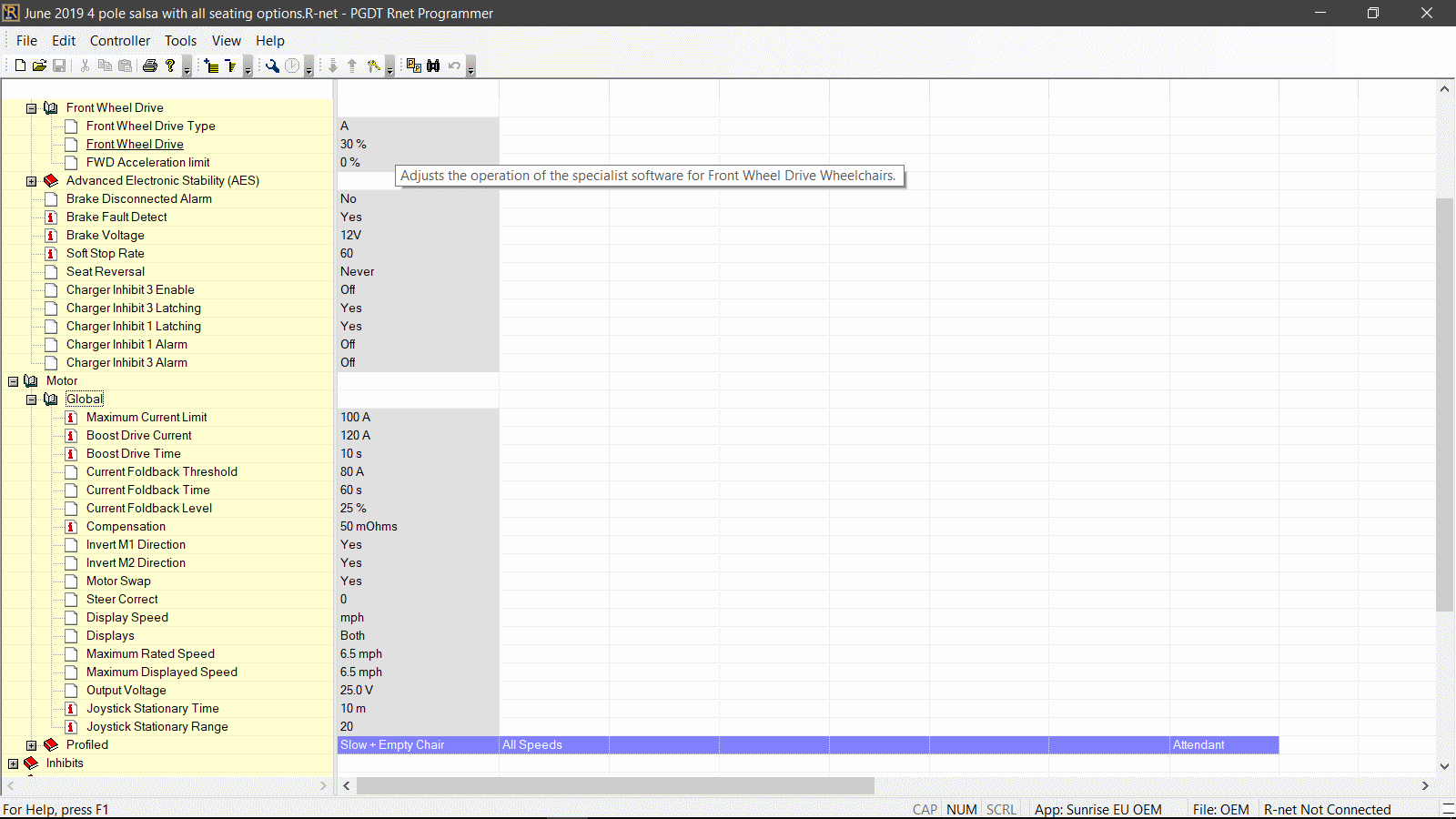

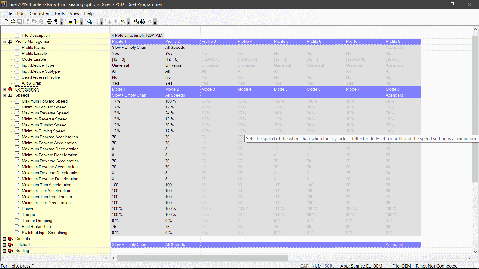

Postby Burgerman » 08 Jun 2019, 18:54
OK then
FULL PROFILE FOR OEM R-NET
Screenshots of the IMPORTANT parts only. These are the bits that make it steer and drive properly.
The seating and inhibit and alternative contols,and infra red/BT etc gyros, and all the rest not included. And these setting will not work if you have a front drive chair with gyro drive stability device installed Those will never drive right...
This will work on all mid, rear drive chairs, once you correct the MOTOR COMPENSATION to the correct value in the event that you are NOT using either Linix or AMT 4 pole motors. So you would change that 50mOhm to your setting. Maybe 70 or 100 or whatever.
NOTE that the empty chair has PROFILED compensation set to 95, and 105 for the all speed one. Thats because I am fat. In a mid drive chair you can set these to 95 and 100. If you are light, you can do the same on a rear drive chair.
Also note that the FRONT DRIVE RATE is set to 30% This is because setting it lower means too much steer control at speed making it hard to track straight in a relaxed way. And setting it higher means the thing needs too much left or right to aintain a straight line and becomes hard work.
Profile 1 is the same as profile 2. With the only difference being that it has ONLY got the lowest speed.
So... Profile 1 for empty chair while carers move it around if needed. Works if you sit in it too, but with lower compensation its less urgent...
And... Profile 2 is for ALL OTHER USES. You just need to set the speed to low for indoors. 2 works perfectly. And 5 for full speed outside.
And forward acceleration is set to 70. Mines actually set to max 100. I chose 70 to slow it down for other sane users. Some may still find this a little urgent! So set it lower if you want. Change the FORWARD ACCELERATION and MINIMUM FORWARD ACCELERATION to the SAME value, but a lower one like 50 or 40.
SET THESE FIRST!!! Or you cannot set the 'speeds' correctly. These are the WALLS!
Set front wheel drive rate to 30 as it offers the best balance of high and low speed control on a rear drive.
Set to 50 on a mid drive chair. Dont buy a front drive chair!
Set these exactly. Test.

I have a dongle and R-net Dealer Permobil software. Unfortunately, this program does not have access to the settings of the OEM-Factory section.
Please tell me where I can download the OEM version of the software?

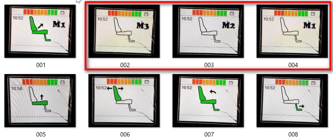

And more... I have on the joystick displays 3 empty mode (See photo). They very prevent. How to disable them?
Thanks.
AlexAGF
Posts: 21
Joined: 19 Jun 2019, 16:29
Location: Russia, Irkutsk
Postby Burgerman » 20 Jun 2019, 09:00
With a generic OEM verion software, you may or may not be able to program the chair. Permobil use a few non standard R-Net parts. They have their own stability/gyro modules. And their own seating modules. So just like pride, can be impossible to program unless you are Permobil. With stock R-Net seating modules etc, you can just turn off the 3 unused seating channels. With permobil you probably cant.
Also my settings above that will make a normal chair with R-Net steer properly will not work at all on a front drive chair with either the stock r-net gyro, or permobils one off arrangement. So avoiding permobil, and pride completely would seem very wise to me. See P.M.
