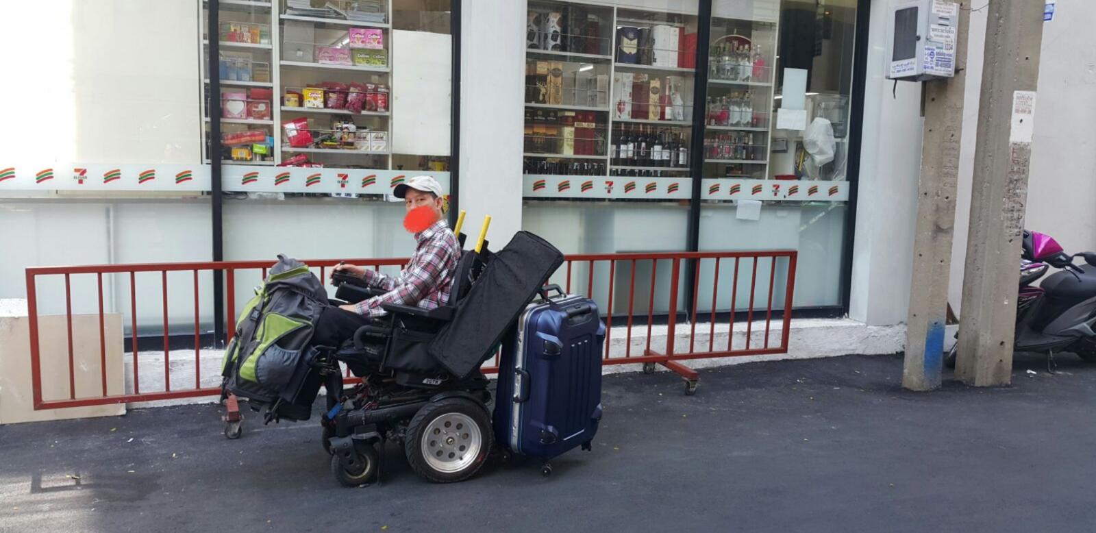

Postby shirley_hkg » 21 Dec 2018, 06:53
Loads of bags on back of wheelchair is norm .

Postby expresso » 21 Dec 2018, 21:05
whow thats alot of stuff on the chair - its normal for me to have a backpack so i am used to that - most people have one here also to carry stuff - mines cant be used for anything - its packed with lithium :)
Ok the 80ah pack is in the bag now and on the chair - this is how it will look - its just about right - even with the rear of the chair - i will adjust it a bit more and will sit a little closer to the seat back when i am done - nothing is connected - no wiring - thats all thats left now - cable to chair and charge cable for the pack -
