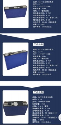

Li-ion cells will be used for higher energy density . The 50Ah cell below will be a good pick . cheers

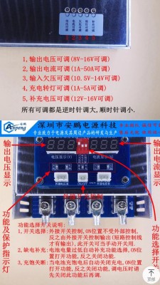

More likely , it's gonna be a cordless Step-Up / Step-Down, adjustable CC / CV power supply of Max 600W output with 1 KWh energy density (equivalent to a pair of G24 lead bricks ) of just 15 lbs.
Found this regulator module :
- input voltage 8V -- 60V
- output voltage 8V -- 32V adjustable
- output current 1A -- 50A adjustable (25A@28.2V max 600W)
- adjustable low battery input volt protection
- adjustable STOP/FULL residue current
- adjustable re-start to charge voltage
- displays of V / A
- remote ON /OFF .
Meant to connect via XLR charge port , current will be 12A max .
Photo below is a 12V version

7 of this 50Ah cells are £85.00 here. Why bother much ? They are expendables .
