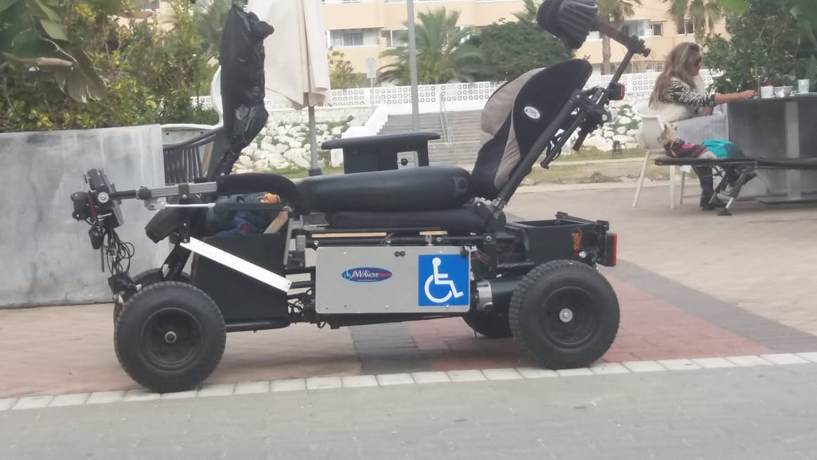

I am developing my own EV ATV Mobility Buggy. Eventually when I have the funds it will be powered by a LiFePo4 battery pack and have brushless motors.
For the moment I am using a 24v 75 Ah LiFePo battery pack and brushed motors. I will have funds in 2010 to do these upgrades.
Info: After charging the voltmeter shows 27.5v. This drops to 26.5v as soon as I use the vehicle.

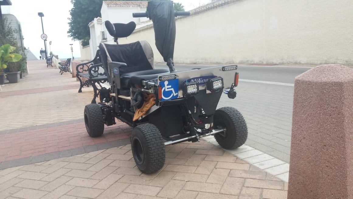

Postby grazy+1949 » 03 Jan 2019, 23:00
EV ATV Mobility Buggy 2x 600w brushed motors. 2x 25:1 reduction boxes. 24v 75Ah LiFePo battery pack.

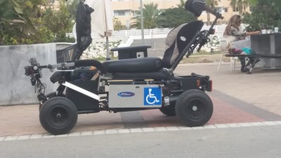

Postby grazy+1949 » 03 Jan 2019, 23:03

Just saw the pics. That thing looks like a car. A 75Ah lithium battery is around half whats required to make it work properly, and around 1/3rd what it really needs. Range off road where loads are very high, will still be quite limited.
The entire point of moving to lithium is that its more energy dense. It therefore allows you to fit more Ah into the same space. It actually demands that you do so because most LiFePO4 doesn't like large currents, and so its much better to install 150 to 200% more lithium than you had lead. Which you can. And once you do, a protective BMS becomes unnecessary. Its battery protection BMS system is only there for 2 reasons.
1. To charge cells and balance them. Depending on actual charger and bms setup, they can be spectacularly bad at this, or just bad. So good luck with that!
2. It protects the cells from people who think its OK to fit a pack into a machine that will draw too much current, and damage them. As it is doing now. In a properly implemented setup, where cell capacity and C rate is more than adequate to supply the controller at peak demand (Max Amps) the part of the BMS that pulls the plug is no longer required. So thats both bits redundant.
So get a real charger, and throw away the BMS and fit more Ah or/and C rate will likely be your only real solution.
Also you say 600w motors, but that only tells us they can survive 600w continuous. It tells us nothing useful electrically. What we need to know is how many Amps the motors and controller can suck out of the battery at full power? Is its controller, 200A or bigger? Single or double channel?

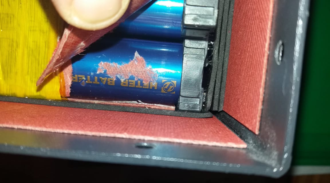

Today I took the lid off the Alu cased golf buggy battery pack. and discovered that it is built from 25 x 68mm. LiFePo cells. The only marking I can find on the cells which are all kind of glued into a pack within an alu box is: Heter Battery.
I do get your message guys and I can see that this golf buggy battery, is never going to get me 6 km up 20 and 30% inclines with reliability. I will put the pack back together and sell it to a single seater golf buggy owner, who is going to drive 200 m,let the battery pack rest, whack a ball, and repeat the process.

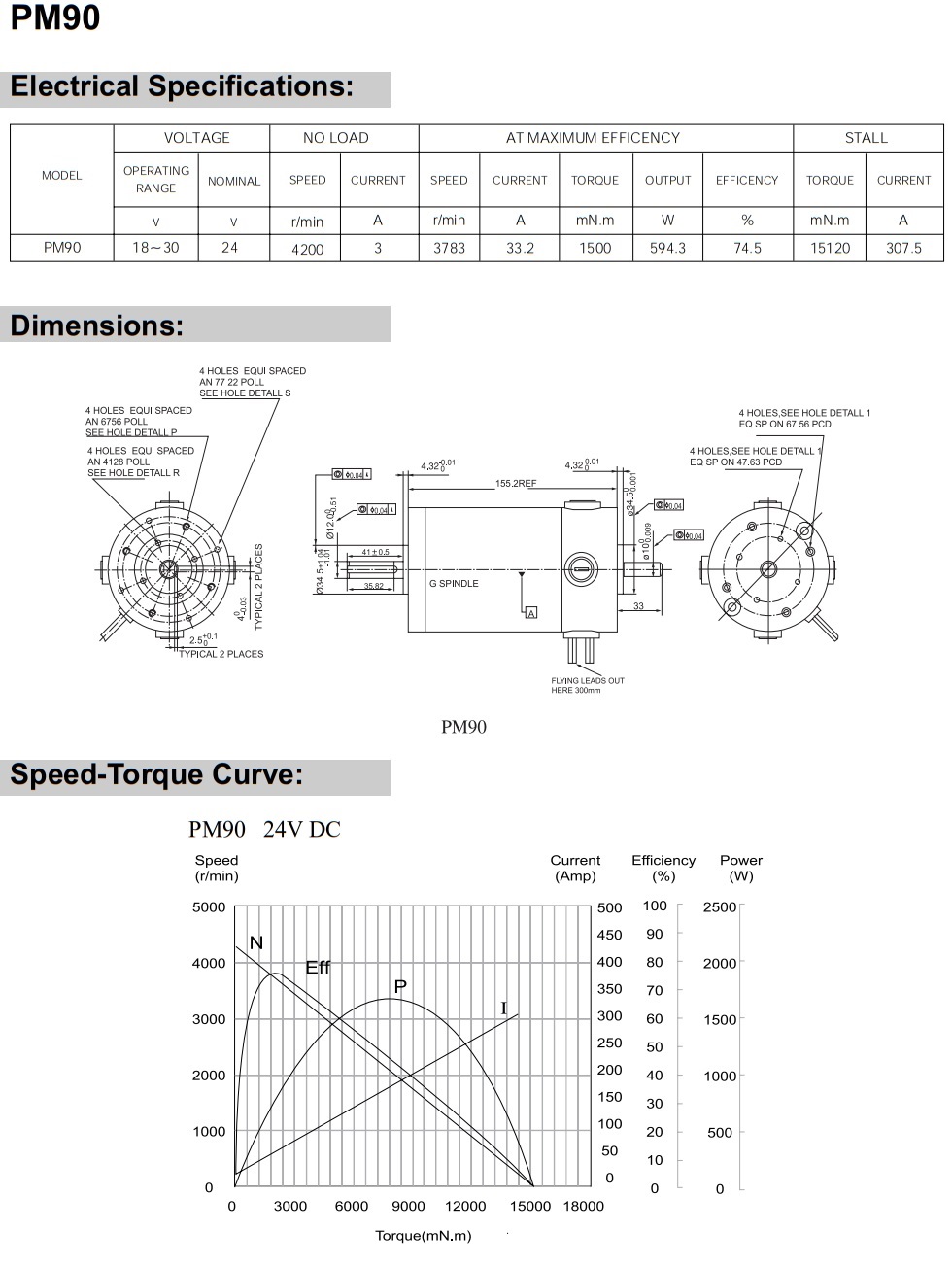

grazy+1949 wrote:I have looked at the http://www.parvalux.com website, but they don't mention the amperage that these PM90/150 24v motors draw.
Is this any use? pm90-data-sheet-10-10-2016.pdf

Thanks for digging that out, but the PM90 is a 4 pole mine are 2 pole PM90/150's. It's raised another question though.

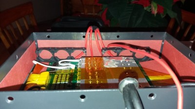

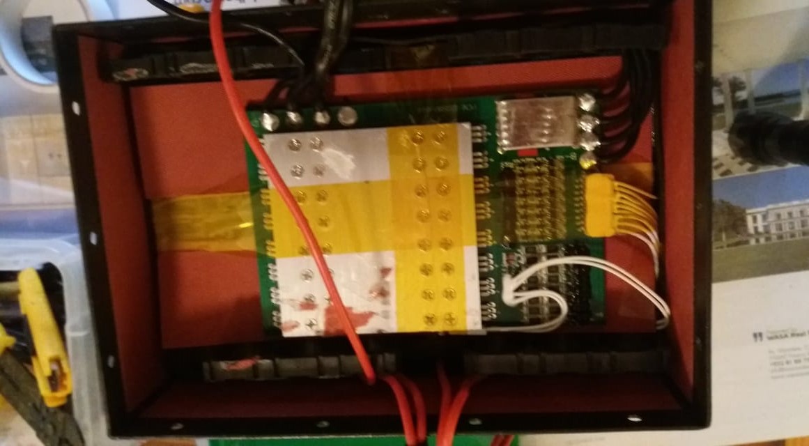

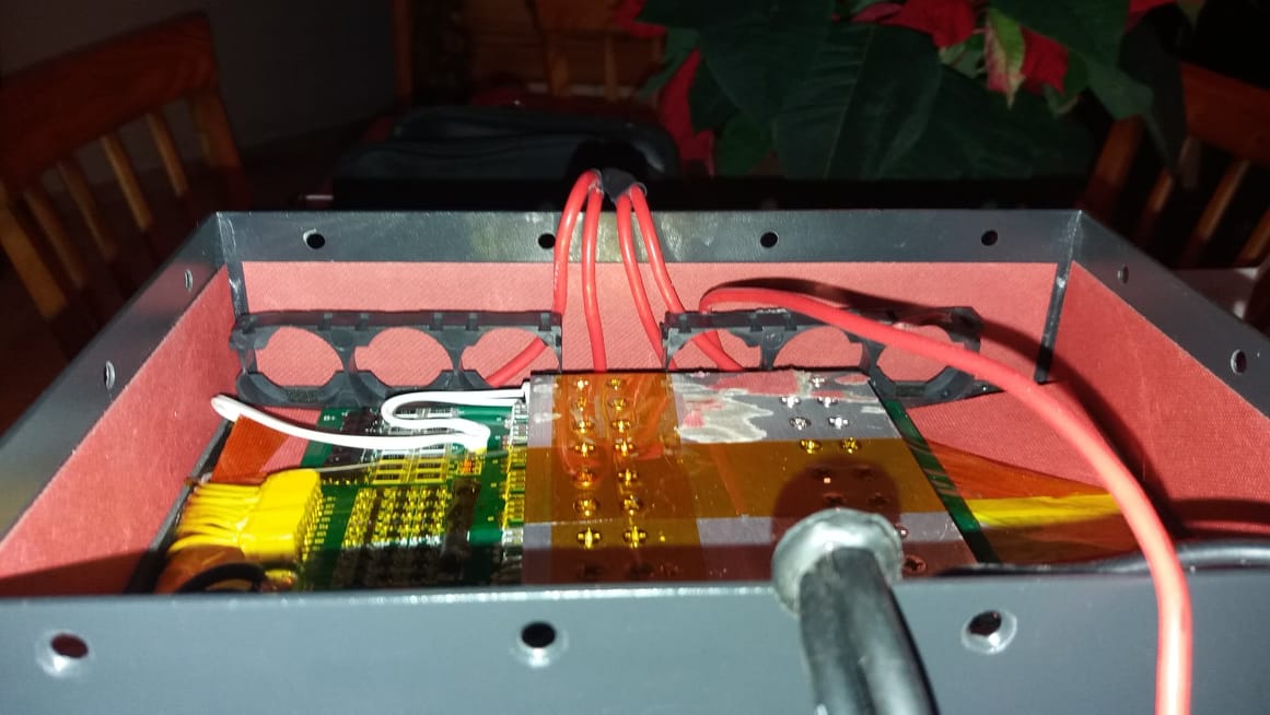

Here are some pics of the inside of my 75Ah LiFePo battery.
Q) Can I remove the BMS and rewire the leads and then charge it with a PL8v2 from Revolectrics , at least until I have the new LiFePo4 battery pack.

Postby Burgerman » 05 Jan 2019, 01:25
That battery if woodys link is correct, is made of many small 3C max cells. That means you should try and not exceed 1 C most of the time, and will be able to do 3C intermittently. So it will murder it to be doing 150A on those slopes. And I expect it will cause a large voltage drop, causing the BMS to cut power... As they do.
The reason you are getting cut outs is the battery isn't big enough and BMS are stupid so dont understand the difference between volt drop under load, and volt drop due discharge. Its trying to protect a too small battery from a too big load. Which will get at least twice as bad with the roboteq. Since it will be 2x 150A on your slopes.
Dumping the BMS will stop it cutting out. You will then ruin the cells. As they are inadequate for the job.
Posts: 69890

Inside my Golf buggy battery's Alu casing. There are 9 layers, each of 16, 26 mm x 65 mm LiFePo or LiFePo4 cells, I guess they are 3.2v 3000 ma cells, total cells 144.
I can't read any spec on them just Heter Battery. They look very difficult to remove from the alu case, as they are stuck in with strong sheets of double sided adhesive material. Also I suspect that they are spot welded in banks to form a pack. The neutral cables are accessible on the BMS, but there are 2 sets of red battery leads which are not accessible, as they are down the side of the pack between battery and case. In other words, I don't think that the cells can be removed from the alu case. and as I have no way of knowing whether they are LiFePo or LiFePo4 my Q. is as follows:

Q) Could I remove the BMS and charge this battery pack with a PL8v2 Revoelectrics charger.
[It does climb 30% gradients at the moment , even using a cheap 50€ charger. It's the BMS that is shutting the battery down, when the voltmeter is showing 23v]

grazy+1949 wrote:There are 9 layers, each of 16, 26 mm x 65 mm LiFePo or LiFePo4 cells, I guess they are 3.2v 3000 ma cells, total cells 144.
cheers
Your 26650@3000mAh cells are good , but low C-rate .
Not only could you, its pretty much essential. BMS is always problematic.
Its safety features will always cause problems, reliability issues. But in this case its trying to protect the far to low C rate pack. How do I know its far too low? You say its dropping to 23V! That will damage the cells regardless. So battery isnt capable of making adequate Amps. Because its too low C rate, and way too small for the job. It wont last long doing that to it. But removing the BMS will stop all that cutting out. And allow the battery to die fast as you are overworking it.
Thats what its meant to do. A BMS is there to stop people damaging the battery by fitting it into a situation that it cant cope with. But if you happen to know what you are doing, you would PLAN things correctly, and would have already figured out that the battery isnt suitable. In a properly thought out system a BMS never actually does anything. Other than help charge very badly. So the best place to put that thing is in the bin.
The problem is that your battery is also too small, to low C rate to do the job you intended.

Postby LROBBINS » 05 Jan 2019, 10:05
I'll just note three things:
(1) That buggy weighs all of 120kg - lighter than your Salsa, and grazy doesn't have your heft either.
(2) It is tiller steer so doesn't have the load of differential-steer turn in place.
(3) The Roboteq that grazy has is already an "S" model - single channel. The only scripting needed might be motor compensation, but even that is probably not critical for how he''d be using it. Scooterman already has an untested "draft" of a script I've modified for scooter use that also includes some other not-really-needed niceties.

grazy+1949 wrote:My Last Q for tonight.
cheers BM said : Knowledge is power .
144 cells will make a 8S/18P pack . @3000mAh cell, that's 24V 54Ah. drunk2
I ues 26650@3000mAh cell too , but 8S/72P , so 216Ah.

Postby Burgerman » 05 Jan 2019, 12:36
I was going by the photos and it looks huge? Like a small car. Or one of those large road going scooters.
If its 120kg, with 6mph gearing, then it would likely be OK with the same 1C Cont. 2C peak 176 Ah cells I was planning to use. As long as it wasn't going to spend a lot of time stalled or climbing steep slopes off road. But it is? So if theres the space for more Ah, thats still wise. My salsa for e.g. will not climb the pub ramp at 15 degrees (not percent!), as its too heavy (185kg) it just stalls the motors. With 6mph/4 pole and 2x120A. While I am trying to climb that ramp, and still moving, both motor channels are maxed out at 2x 120A. So thats ok just about. 240A for 2 to 3 secs. The rest of the time its less. unless zero turning. But thats at stall speeds or close so battery amps are lower than motor amps are. If he was running up a steep hill slope off-road, then max Amps AND full pulse-width will coincide at about half max speed. (his motors are 3.5A stall, 5A free running). Meaning that with roboteq, max 150A controller Amps x2 = battery amps.
For off road use the 2x 150A roboteq will still be an advantage. And I would still prefer to see say 200Ah or so if it will fit. Or some 3C cont / 5C pulse cells. As it is, he is dropping an almost fully charged pack down to 23V or just under 2.8x volts per cell under load. The BMS sees the low volts and cuts off power to save the battery. And those are 3C. (75Ah x 3 = 225A supposedly)
True. But that occurs at stall speeds, or very slow speeds. So the 100 or 150 limits is at small pulsewidth. (with 305A motor stall, at around 50% pulsewidth, so 2x 150A motors pull only 150 total from the battery. Under 1C.
But driving up a slope off road at half speed, at 100% pulsewidth, under load of a steep slope, means 300A at battery. And thats his intention? So regular 2C at the (pulse) limit.
Thats perfect.

Shirley bought 26650 cells and built a pack from it. For a wheelchair.
There are MANY 26650 cells available, some are what it says on the tin. Some are much lower capacity than claimed, some are much higher resistance (impedance) than claimed meaning lower C rate. Greater voltage drop.
It will be much easier to build a pack using the large prismatic cells such as you were already looking at.
26650 just means, 26mm diameter. And 65mm long. They can be lithium ion and 7S (bad idea unless you like fire) lithium polymer (same problem) or LiFePO4 which is safe and requIres 8S but is a lower energy density.
After 10 trips up the mountain, my LiFePo4 24v 74 Ah battery pack with BMS has become weaker, to the extent that the voltmeter shows 23v when climbing 30% measuring from the battery leads.
Someone did the maths and it actually added up to 54Ah? Rather than 74. But either way inadequate on a mountain!
Reasons it could become "weaker" are:
Too many amps removed from the cells, (too much current) so damaging the cells. Thats very likely.
BMS has let the pack become unbalanced so when the BMS/Charger tells you its charged only some cell groups actually are. One cell group goes low a short time into your trip since its already lower than the rest. This will actually damage it too making it get worse as you use it. Another reason to throw away a BMS.
BMS is cutting power earlier as it is going high resistance as its mosfets begin to fail.
Without testing each cell, and throwing away the BMS, and properly charging the pack, its not possible to know.
Q). If I remove the BMS and charge it with a Pl8v2, will it recover at all. I am planning to redeploy it for use in another EV on much flatter roads
If its a balance problem, it will properly balance the pack.
If cells are damaged, it cant help.
If the pack is simply too low C rate, or too low capacity, it cant help.
It can show you if the pack is charged, balanced and ready to go.
It can then test the pack, measure the Ah, show you if any group out of the 8 is lower capacity than the rest.
It can test each cell individually for Ah.
And can graph and monitor all of this in future.
And it allows you to chose the charge rate up to 40A, and charge voltage, and many other details that keep your expensive pack correctly charged so it has a long service life. And it allows you to SEE this is happening.

In the current 74Ah lead acid golf buggy replacement LiFePo4 pack , they have soldered or spot welded the cells together.
Q). Can I test cells in this type of pack or do I need to separate each cell?
Didnt someone say that this was only 54Ah?
You can take out and unwrap the pack so you can access the cells in the parallel groups. remove the Battery Murdering System, (BMS).
There is 8 groups of cells, each connected in parallel to give either 54 or 75Ah depending on the actual correct figure, at 3.2 volts. Give or take a little dep on state of charge.
