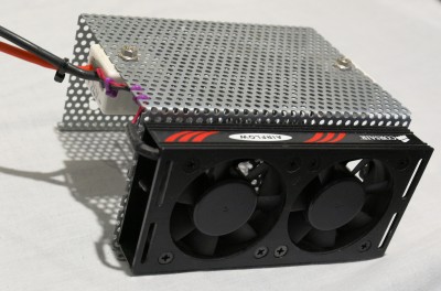

Or you can add a dummy load... This takes 20A at 12V and 40A at 24V. So you can plug this into your supply battery as you discharge with the PL8 so that you dont need to have a huge battery or an empty one...
