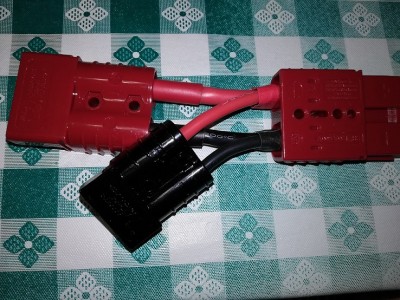

SB 120 - used one 6 AWG and 8 AWG together in one end - - 8 AWG going to the SB 50 - i need to make the last Cable going from this SB 50 end to the pack end - and then the charge cable SubD - for the pack -

thanks - that cable was a bit of a pain to make and i had one shot at it - i didnt buy any extra - - but i took my time today with Quickie helping me - going from a 8 AWG wire to 6 AWG - is a huge difference - even looking at them - looks like its double the size - will use 8 AWG for the rest of the wire to the pack - and try for the first time to solder 8 AWG to an XT 90 connector - so the next cable will be SB50 end going from this cable to XT90 end going to the pack - that will be it for this and i can use it connected all together from then on - too bad its cold - i would love to go test this thing outside - will have to wait -

turns out i made my cable a bit too long - the Black SB 50 i used was too long - so i managed to fix that - i had to cut up some heatshrink that was too long coming out of the SB 120 end with both cables - it didnt look as nice after - so i wrapped just a small bit of graphing Tape at the ends -
would that be a problem leaving the graphing tape when its being used ? or should i remove it - i had to cut up some heatshrink - i wasnt able to get a nice clean cut all around - so i added the tape just to look nicer - it wont be seen either way -
would it be OK to leave it there ?
i have to learn to use less heatshrink from now on - i had too much going over both the cables and then i couldnt angle the black SB50 because of the heatshrink - so i had to cut some off to give the wire more room to flex and angle - i didnt realize how long it was overall -

this is before - even the SB120 - fits but just about - i can redo it - but this works and it fits - i was worried if too short the cable would be hard to snap in the shells being so close together - i should have double checked this before making it -
but the SB 50 was way too long - had to fix that - you can see the back pack with the ADD ON inside - all done etc, - its dosnt go past the rear - it sits flush even with the rear of the chair - i like how this one worked out - size of the pack - compactness - and looks neat from the outside - look just like a normal backpack -
Charge Cable is made and installed on the pack - all thats left to do is make the connecting cable from the chair to my pack - and volt meter will make also

This is very nicely done expresso. It’s not easy terminating short thick cables. Especially having to fit 2-pair of cables into one connector :thumbup:

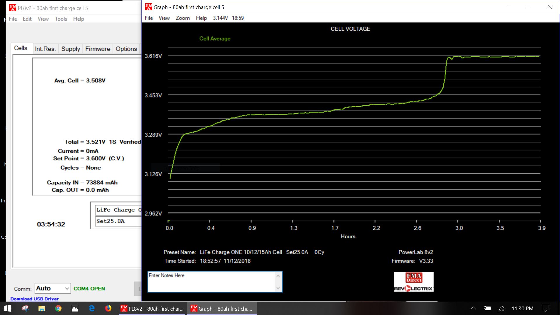

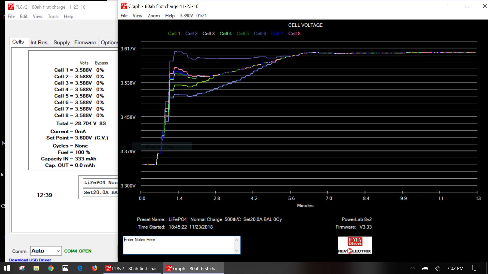

Puzzled? :problem:
The single cell graph makes sense to me when CC charging. As the cell soaks up the current it's voltage slowly rises, then shoots up vertically when charged. (A characteristic of lithium)
And after about 2.5 hrs the cell is still at about 3.4v.
BUT when charging 8 cells the per cell voltage of all 8 nearly hit 3.6v in minutes, and yet they are obviously a long way off from being charged, they now balancing.
The question is why ONE cell 3.4v after 2.5hrs.
Yet 8 cells are at ~3.5...v after only minutes?

Postby Burgerman » 04 Feb 2019, 10:47
Because your cells have
a: resistance.
b: different lengths of time sat at CV.
So lets say the highest cell its 3.6V at 8am. Its now reducing in current sat soaked at 3.6V or whatever you set. Its NOT FULL, its sat at that voltage only vecause the charger is pushing its voltage high which is can do due to its internal resistance. But its the MOST full cell.
2 hours later all the other cells reach CV. But only just, and are nowhwere near full yet. But that cell above has been sat at CV for 3 hours already waiting for the rest. That one cell is REALLY full. And drawing no current. The rest are not YET full. But have reached the chargers chosen CV termination current. So reduce it. So that all the cells stay at 3.6v for longer. But its very hard to do that realistically on the tiny cells you bought. So charge ends with some cells at 99.7, 99.8. 99.9% full, and one cell or so at 100%
Posts: 71095

Postby Scooterman » 04 Feb 2019, 10:59
Sorry BM I should have made myself clear. The graphs are for espresso’s 80Ah cells.
But I’ve noted what you said regarding my tiny cells.
I’m not bothering with my 600mAh cells anymore, as you say I bought the wrong ones. But I might have one last go with them in a 4p2s arrangement
Re: 80Ah ADD ON build
Postby Burgerman » 04 Feb 2019, 11:28
It is just the same no matter what size cells though. But with larger cells, you can set a lower TERMINATION point giving a longer CV so all end up fuully charged. Then they all will all drop at a similar rate afterwards. But remamber that not all cells drop at the same rate. That depends on self discharge rate. 3.4V is still full though..

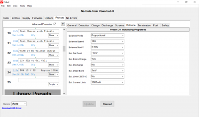

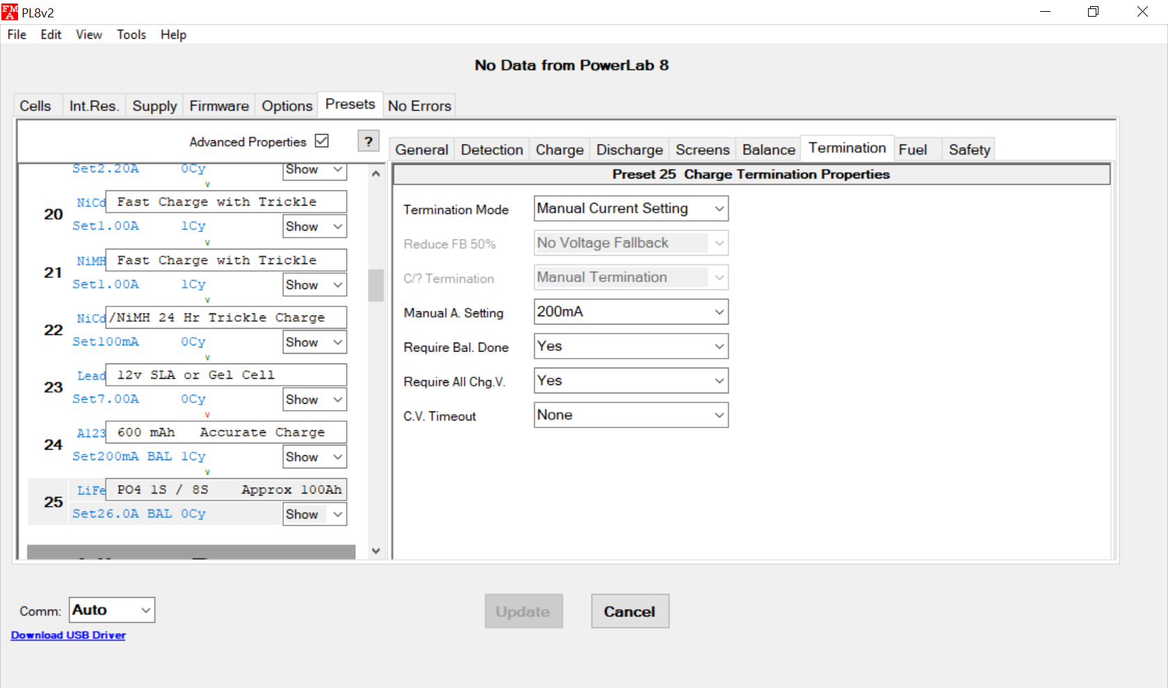

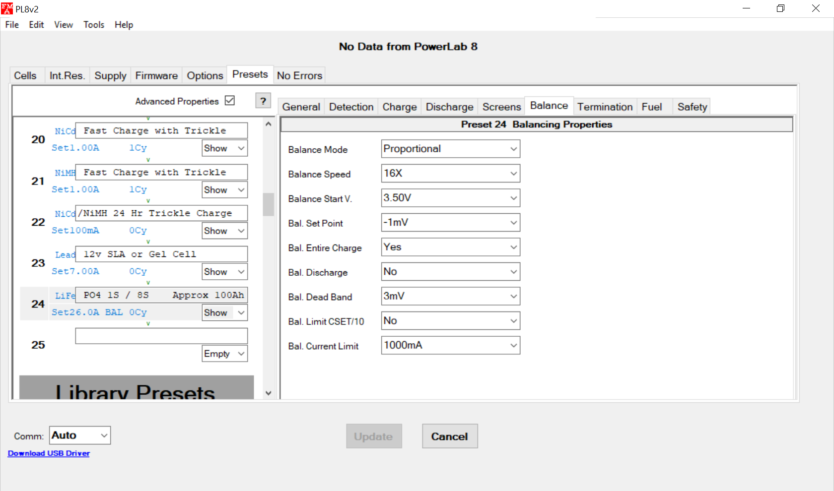

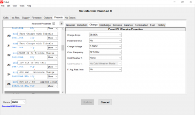

This is your 100Ah preset.
So the charger is initially putting out 3.6V and a CC of 26A.
The cells start balancing when the first cell reaches 3.5V. Then the charger switches from CC to CV, and the cells continue to balance.
The PL8 output is CV = 3.6V and variable current.
Then when the charge current drops to 200mA the charge terminates and the PL8 switches off, or does a cycle if required.
This must be really tedious for you but can you just say
YES or NO if I've understood this correctly.
Thanks.

I've just been comparing your lifepo4 presets.
So as a starting point for 90Ah in a 2P8S arrangement
Charge would be 40A
and Termination would be 360mA
Everything else remains the same.
Postby Burgerman » 04 Feb 2019, 13:15
I usually charge at around 1/4 the capacity. So 25A for a 100Ah pack. If you want faster, feel free. But within reason. LiFePO4 is happier charged at around the 3 to 4 hour rate long term. If you charge slower than this then thats not much of a problem, but it means more time and its not necassary to charge this slow.
Termination current. If the pack is high C rate, and well balanced, then a 300th or 330th termination poing works well. So that would be say 300mA on a 100Ah pack. If the thing takes a long time to balance, and to hold voltage evenly after charge, then reduce that to 500th or 750th of capacity. So it stays at CV longer. A 4 hour CV timer is OK on a pack that balances easily. An 8 hour limit is too long, but may be needed to balance an out of balance pack, or much longer. So initially this should be set to off or never ending on a new built pack.
Theres no correct settings, only the best at the time. Like once the pack is in service and balanced well, then reducing charge votage to 3.550V will extend service life a bit.
Postby Scooterman » 04 Feb 2019, 18:08
Burgerman wrote:I usually charge at around 1/4 the capacity. So 25A for a 100Ah pack. If you want faster, feel free. But within reason. LiFePO4 is happier charged at around the 3 to 4 hour rate long term. If you charge slower than this then thats not much of a problem, but it means more time and its not necassary to charge this slow.
I understand thank you for that :thumbup:
Re your lifepo4 presets. The read me text says the preset settings are for 1S-8S only.
With say a 16 x 100Ah cell pack in a 2P8S arrangement, which preset would one use. The 100Ah presnt and select 2P parallel packs in PL8.
OR just use the 200Ah preset?

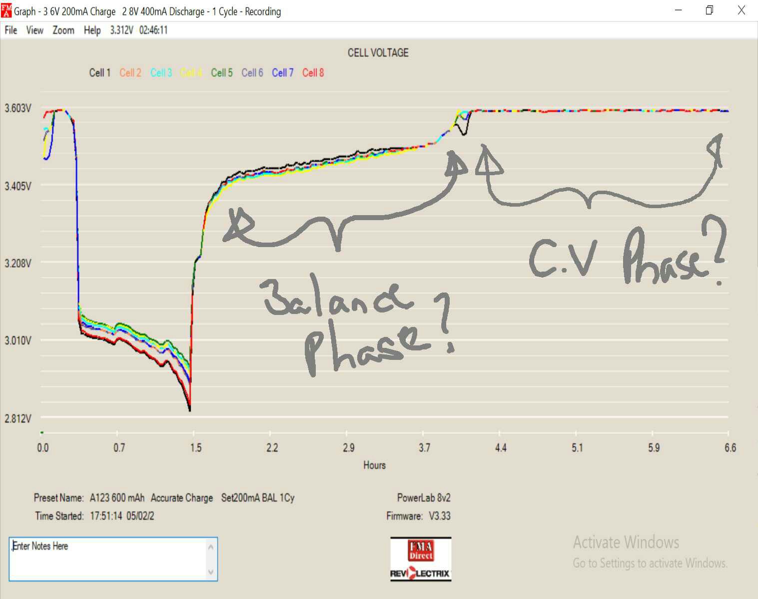

BM - Have I marked the correct stages on this graph?
Postby Burgerman » 06 Feb 2019, 10:54
The bit marked balance is the CC stage where voltage is rising. Balance starts about 3.5V and continues to the end.

Burgerman wrote:The bit marked balance is the CC stage where voltage is rising. Balance starts about 3.5V and continues to the end.
Yes of course! Thank you for that.

We usually set Balance Start V at 3.5, so balance starts here and till the end .
Charge is still going with full throttle .
When voltage keep rising and reaches Charge Voltage eg. 3.58V , PL8 will keep no cell beyond this by manipulating the charge current . It leaves the CC stage and enters CV stage now .
Absorption period may vary . It depends .
CV timeout or Terminal current will end the charge , whichever comes first .
