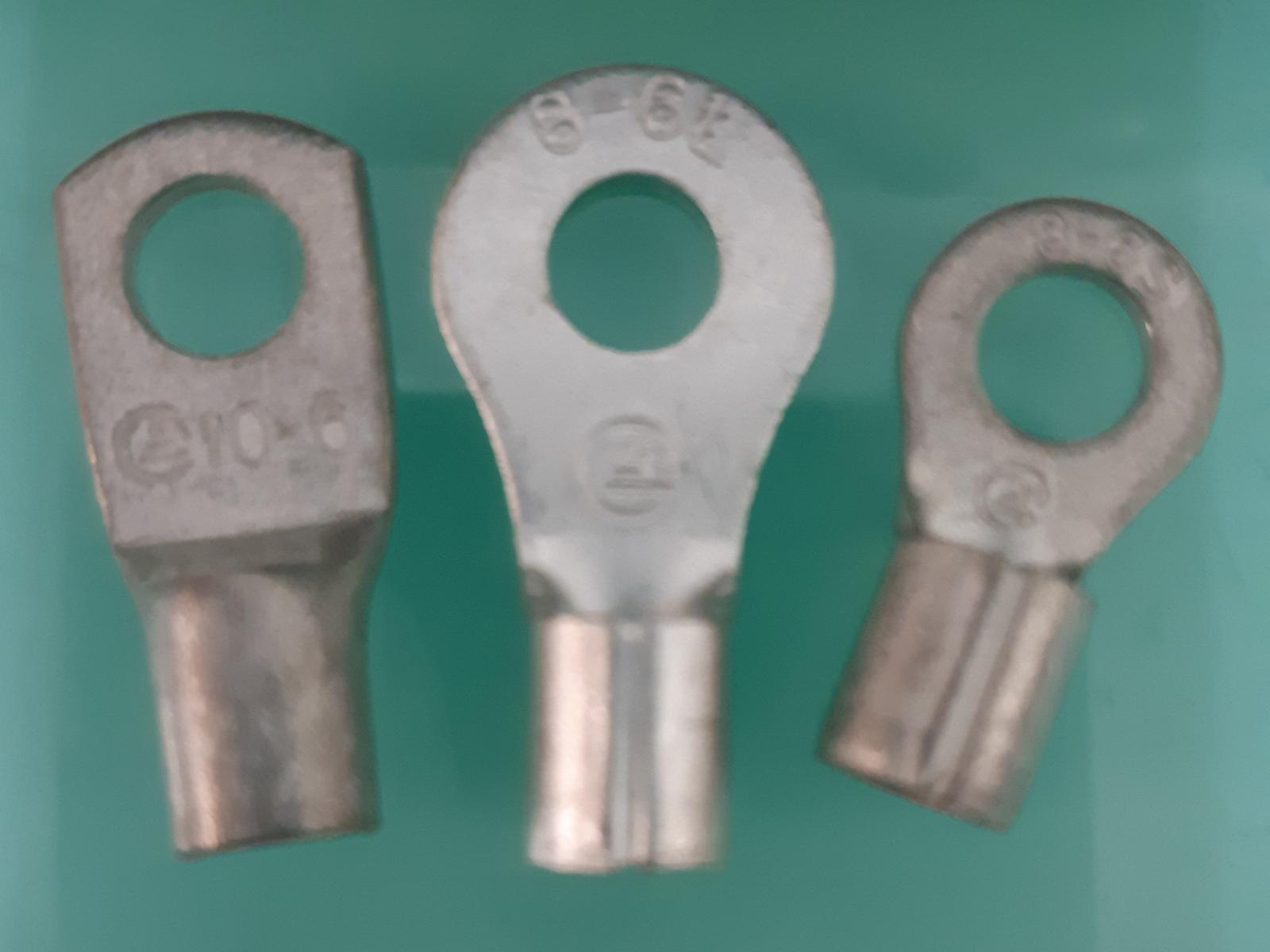

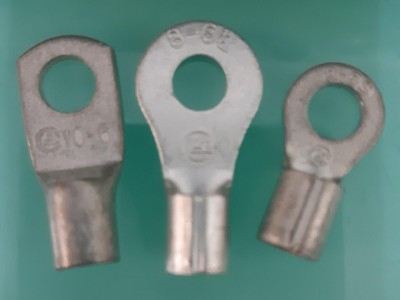

Postby shirley_hkg » 19 Feb 2019, 11:46
Bought this big round M6 ring terminals , to increase contact area as large as possible. cheers
Posts: 4653
Postby Scooterman » 19 Feb 2019, 12:42
shirley_hkg wrote: Bought this big round M6 ring terminals , to increase contact area as large as possible. cheers
