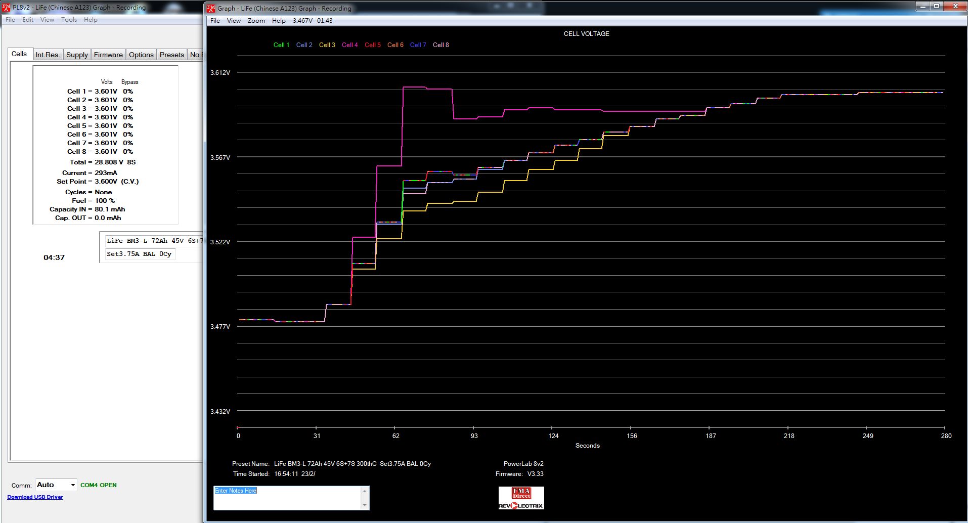

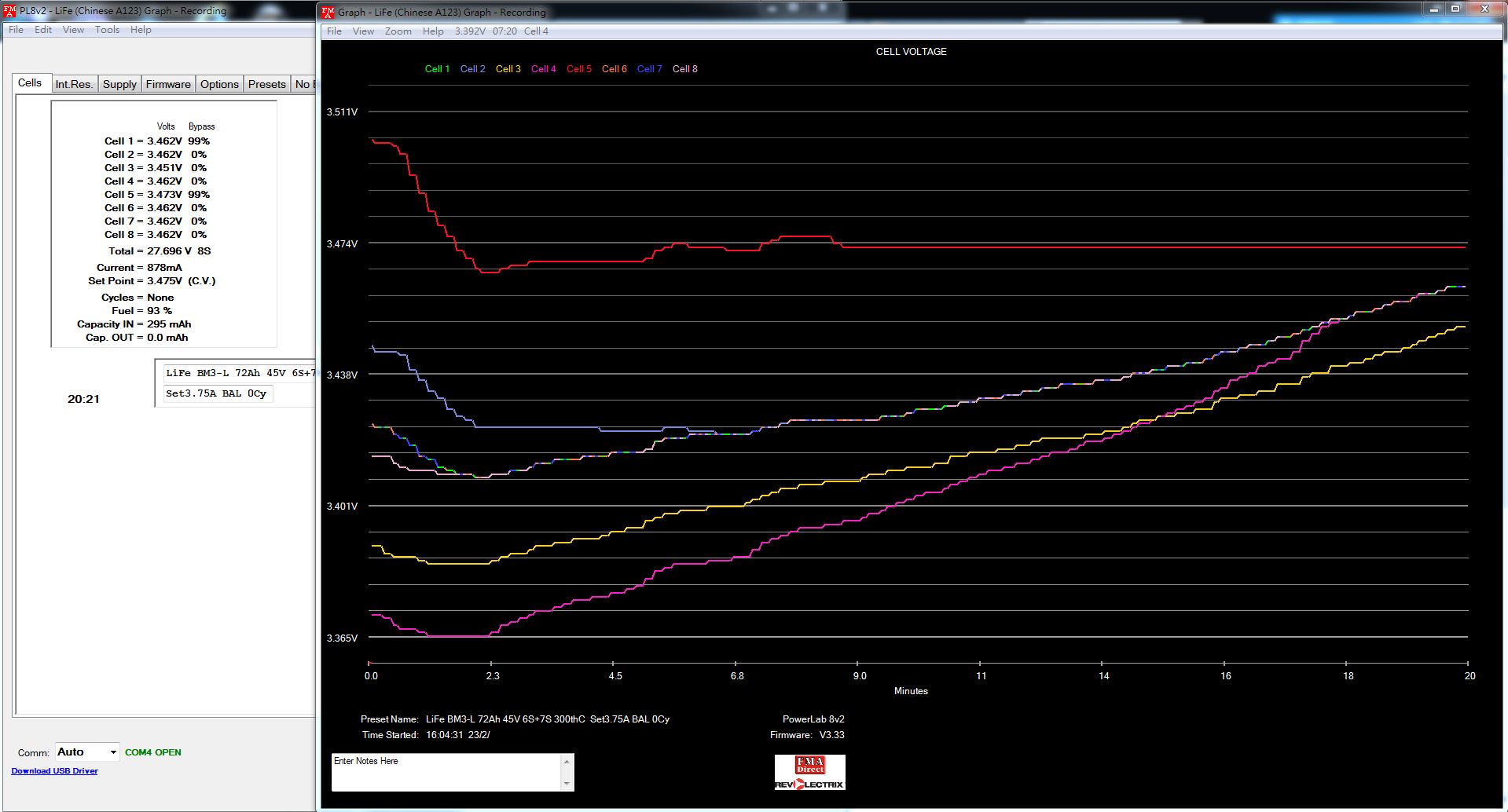

Postby shirley_hkg » 23 Feb 2019, 09:25
PL8 is fun .
I'm balancing some newly bought 25h cells ; below 3.5v.
Charge volt set at 3.475V .
Will bring it up at 3.6V afterwards.

Postby shirley_hkg » 23 Feb 2019, 10:02
shirley_hkg wrote:PL8 is fun .
Then, they all reach 3.6V in seconds . cheers
