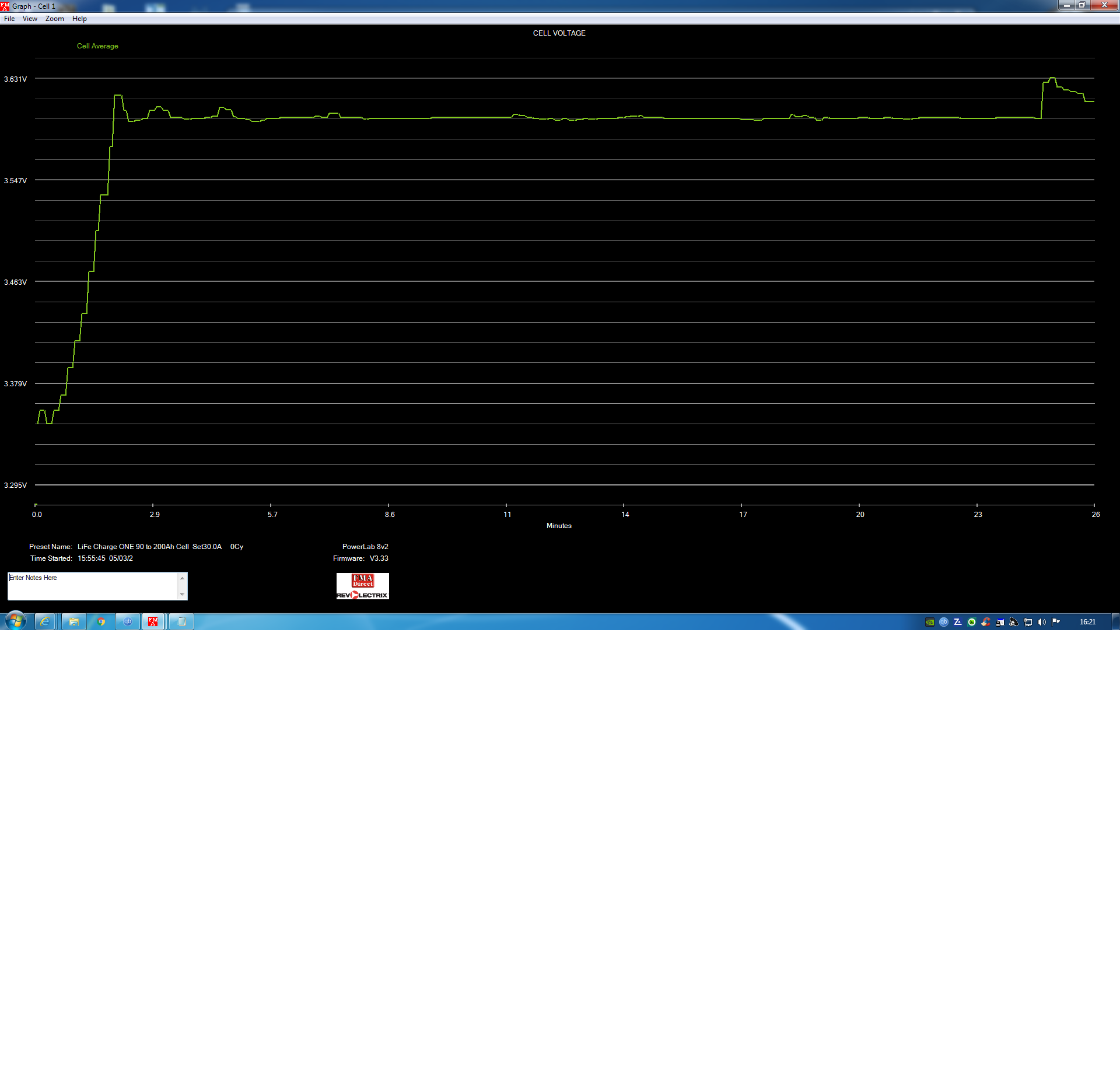

Connect the PL8 to the computer. Dont press any buttons on the charger, now or at all.
Open the PL8 CCS software. Set the comm port to AUTO and wait. It will load all the stock presets.
Select position 1 and add my preset to it. (will upload it here later).
Once you have it in position 1 on the CCS software click UPDATE. It will load tgat preset to the PL8.
Connect a cell, and charge it. Control it with the CCS including charge amps etc, but also check the supply tab settings, and the other tabs... First!
And questions ask!
Be sure 3.33 firmware. Be sure advanced box ticked.

Burgerman wrote:Heres 2 presets.
One for 1 cell. Or 2 in parallel if in a hurry.
One for all 8, with balance wires etc.

Thats the power supply. The charger is set to 3.600V per cell, and 30A and it will do that whatever the power supply is set to.
In the supply tab, set AMPS to the same or a little less than your supply can do.
Burgerman wrote:I wouldnt bother. The used ones did well. So those will be better still. Take say 20Ah out of each one since they shouldnt be stored full. Then assemble the pack.
To do that, connect, choose discharge, and watch the mah counter on screen. when it hits 20,000mAh or 40,000mAh press stop. Make sure you do each the same give or take a tin=y bit. Or it will take an age to balance after you assemble the pack.
