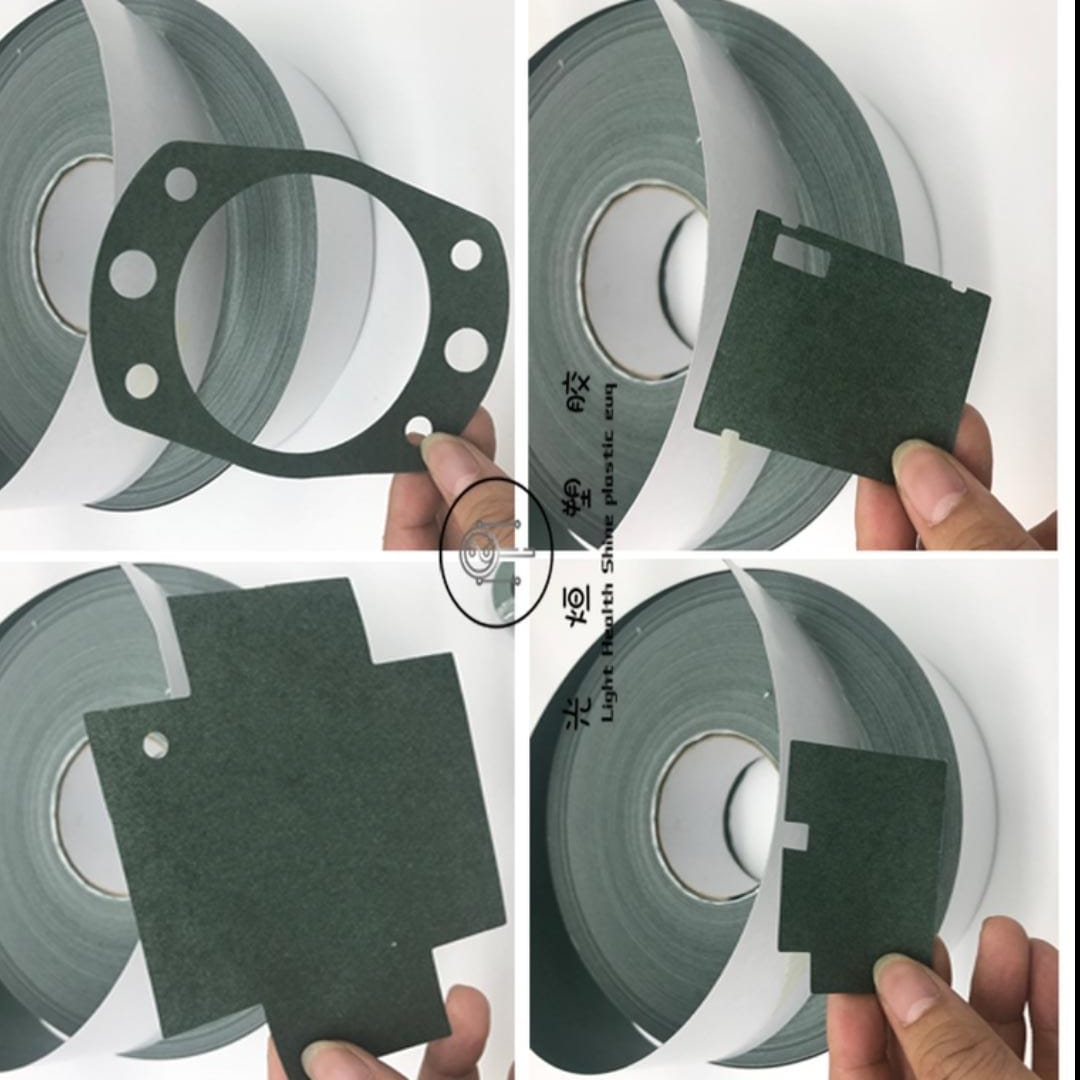

Postby shirley_hkg » 06 Mar 2019, 02:10
Working on a 1P7S 70Ah power bank, I begin to love this self-adhesive "fish paper"
very much . :dance cheers

Postby Burgerman » 06 Mar 2019, 02:17
What is fish paper? :eh:

Postby shirley_hkg » 06 Mar 2019, 02:33
Burgerman wrote:What is fish paper? :eh:
I use the 1mm thick ones .

Postby Burgerman » 06 Mar 2019, 02:35
Fish?
Do you mean gasket paper?
What is it made of? Dont say fish... :clap

Burgerman wrote:Fish?
viewtopic.php?f=2&t=1813&p=133204&hilit=Fish+paper#p133204
Um *,gasket paper . :clap
