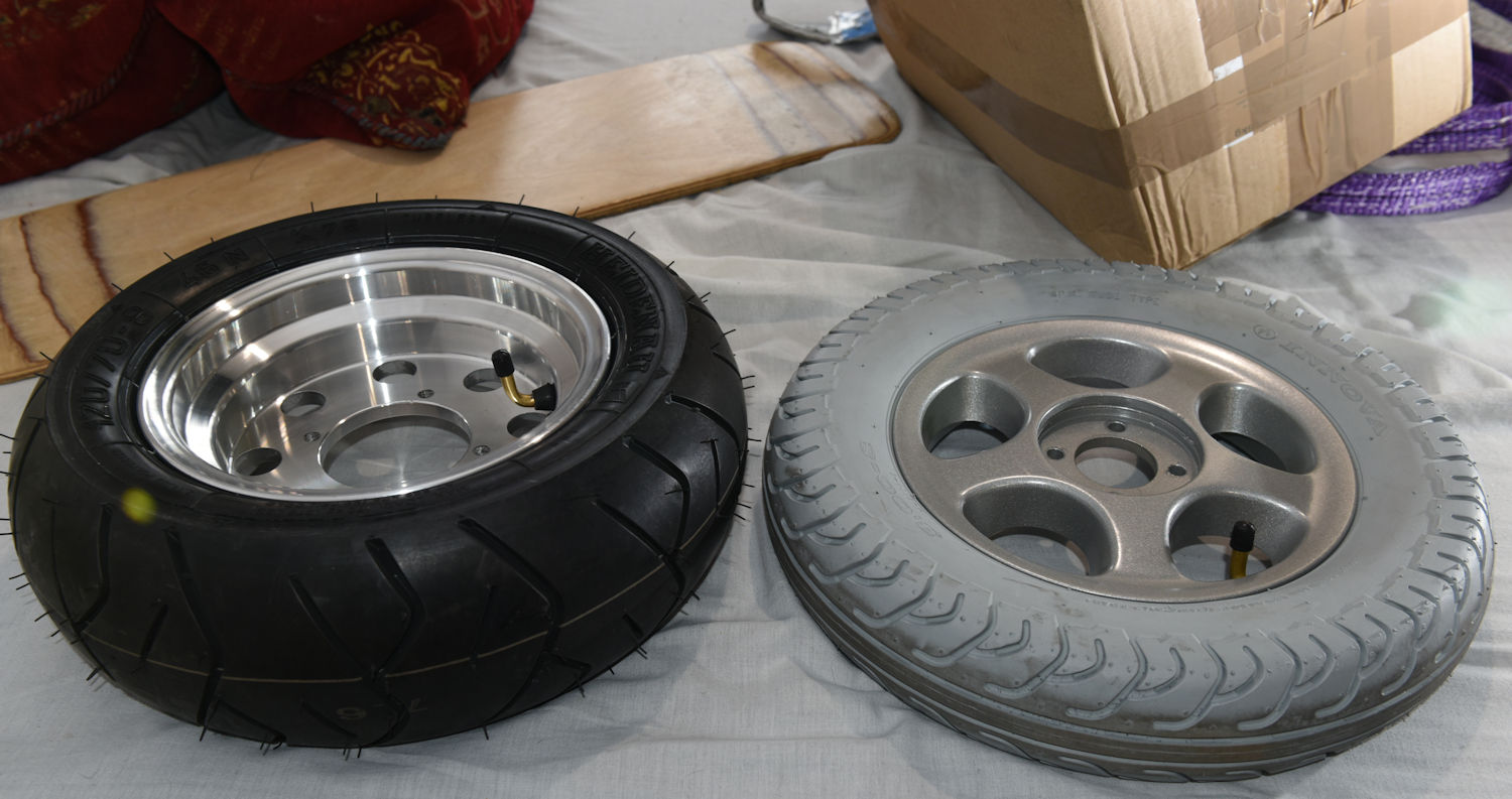

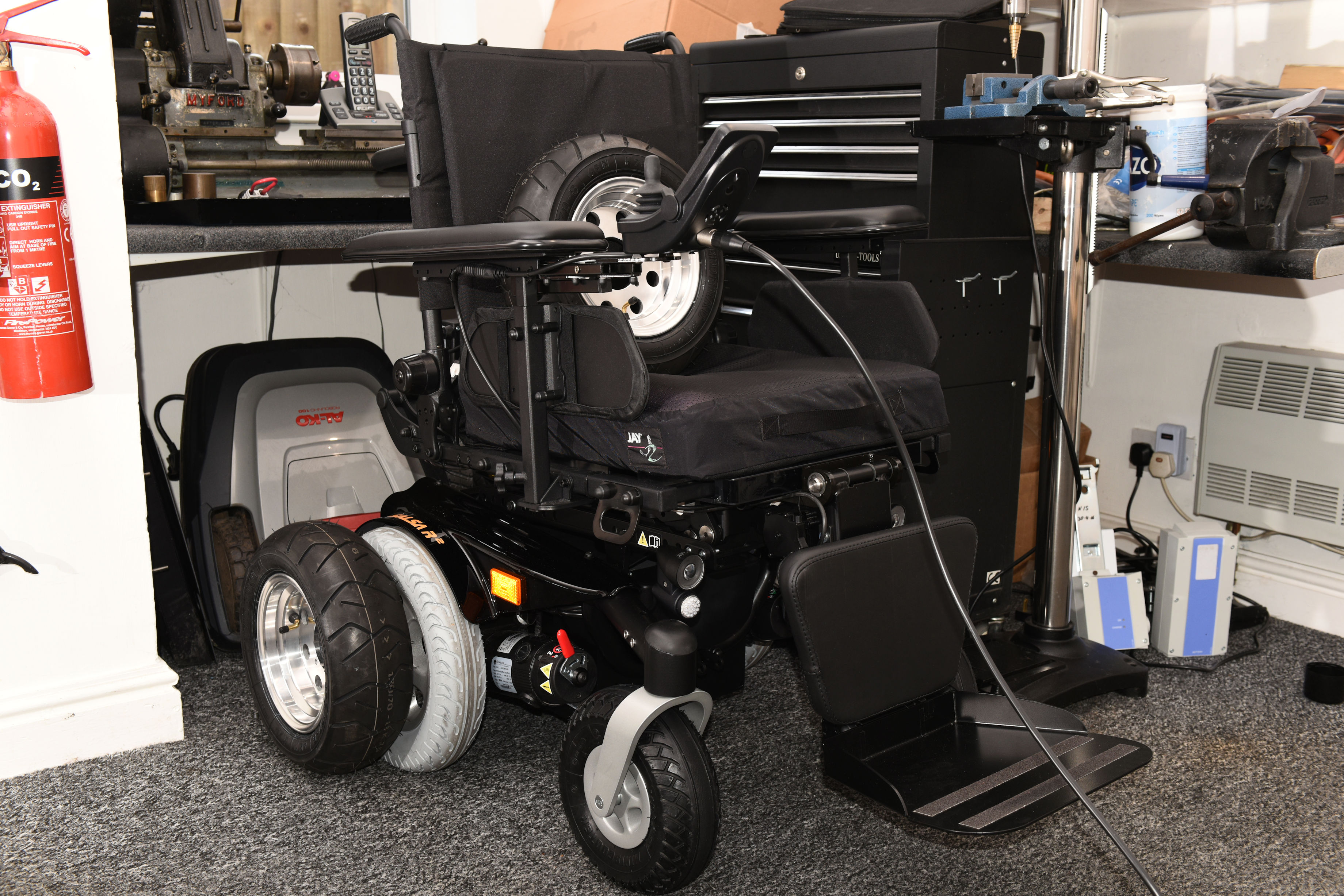

120/70 - 8 and stock 3.00 - 8 tyre size compared download/file.php?id=7639&mode=view
Again on the bed download/file.php?id=7646&mode=view

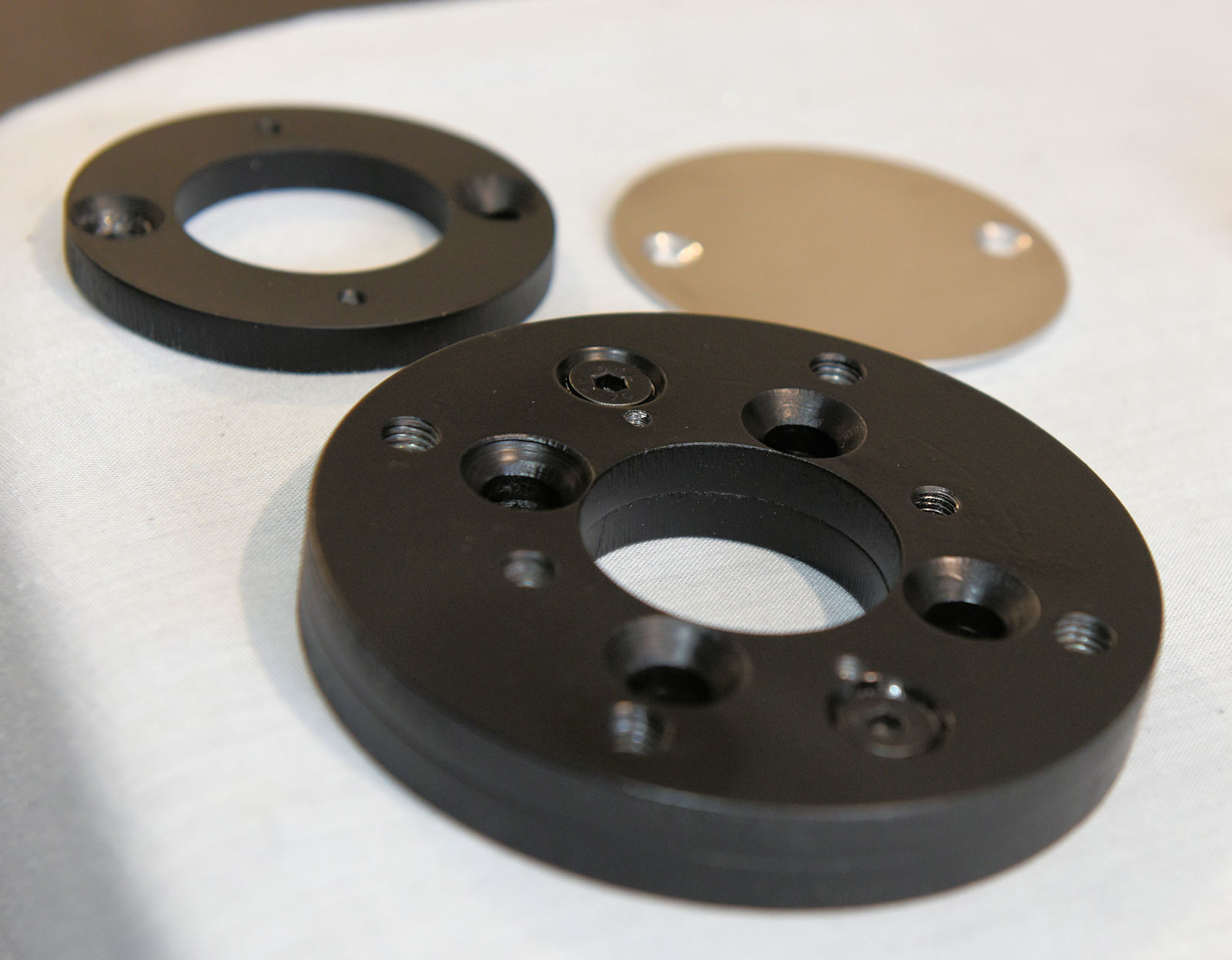

How to make the spacers and adapter. Only a drill needed. The rest was ordered online from a lazer cutting service...
viewtopic.php?f=2&t=7455&start=120
and viewtopic.php?f=2&t=7455&start=150
Remember that I made these spacers/adapters in my bedroom wth a drill. After some careful measuring and ordering the blank undrilled discs lazer cut online. download/file.php?id=7688&mode=view

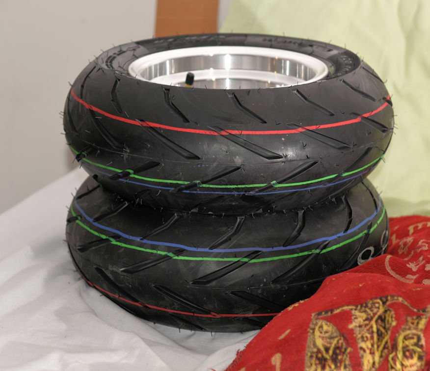

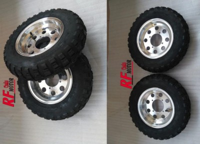

Another tyre make. These are hard to find but prefered. They are also 120/70 - 8 tubeless. download/file.php?id=7755&mode=view

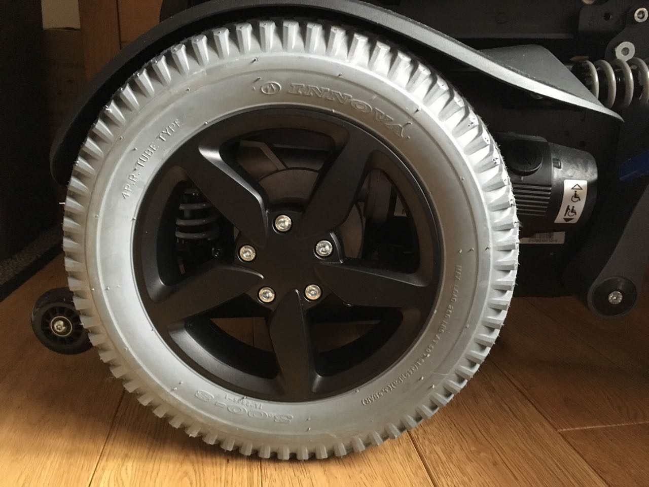

Postby wheelie junkie » 05 Mar 2019, 11:51
more to confuse me, wheels are 5 bolt not 4 so i guess that this is the what i need to find. Mudguard looks like it is coming off as well.

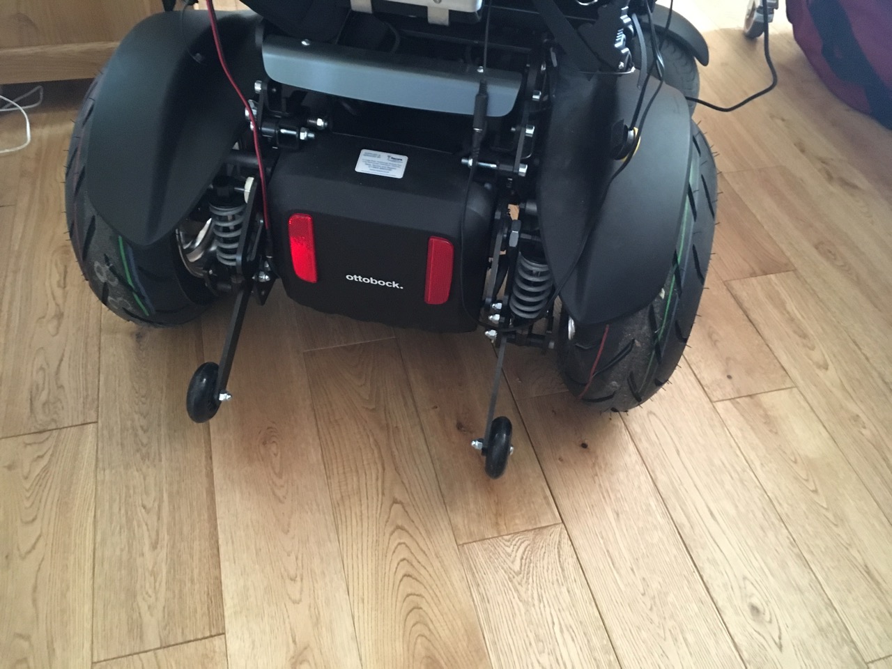

The 110/80 is about 14mm taller.
I used the 120s because they look better and because they are fatter so sink less on soft ground. And because I am 20 stone and so with wide arm tops, and a 18 or 20 inch cushion they are no wider than the chair is.
Like sad mobility pram...
Stock wheels and tyres look stupid...
Now with a bit more attitude!
Pimped...
And the mudguard fits, with 6mm washers under the bolts
Tyres fit stock bodywork, raised by 6mm.
to raise them a touch.

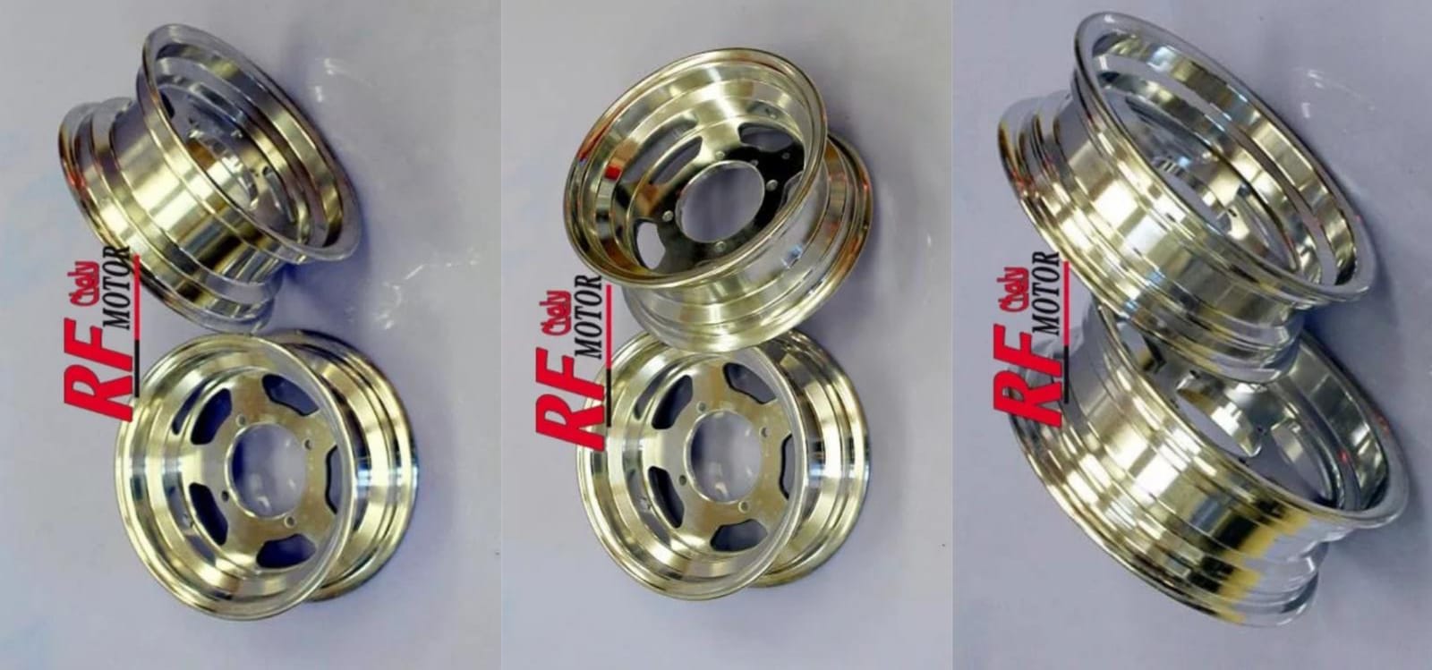

No use for tubeless. Ask shirley, or use a monkeybike parts supplier and get one bit alloy rims.

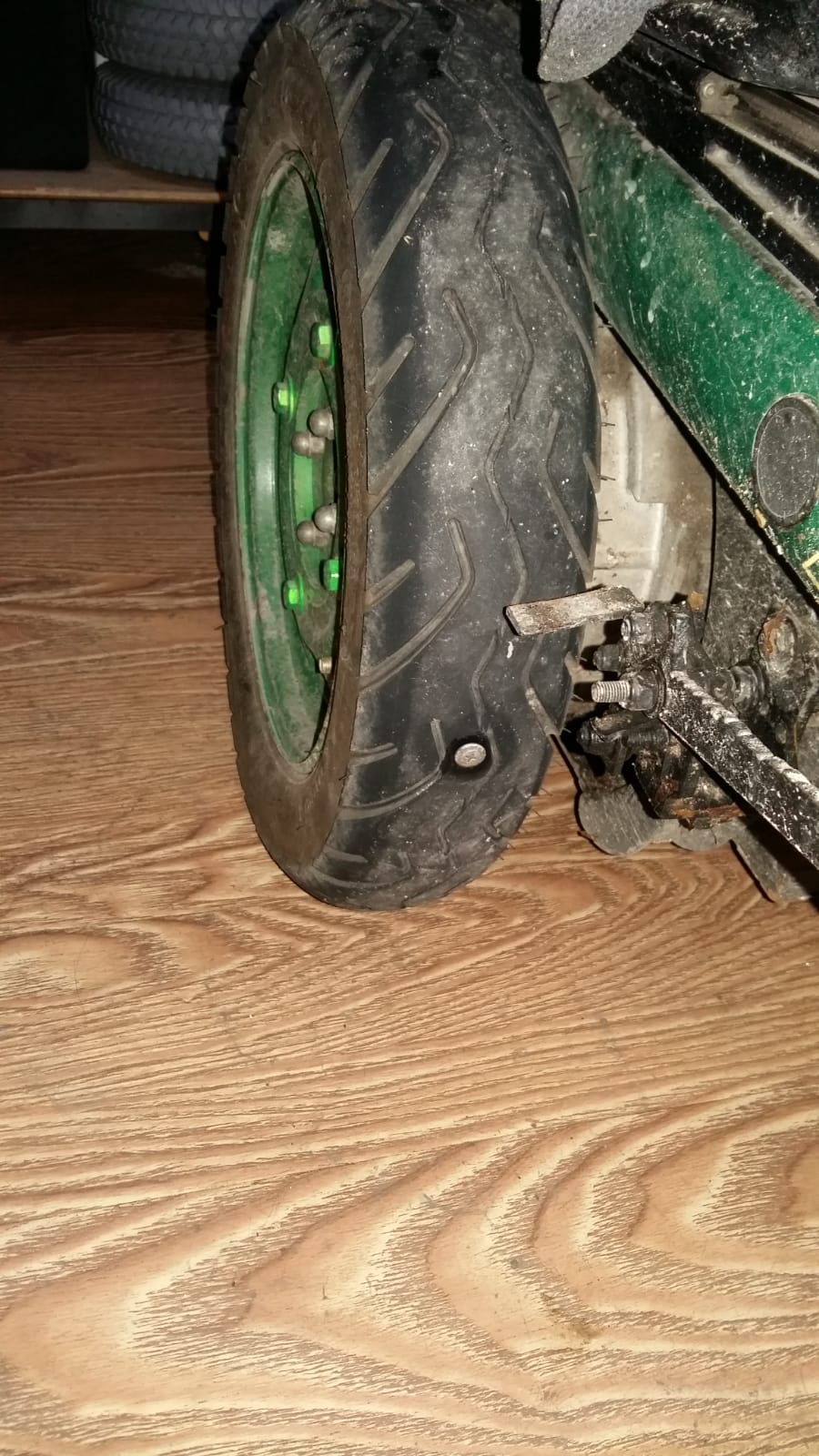

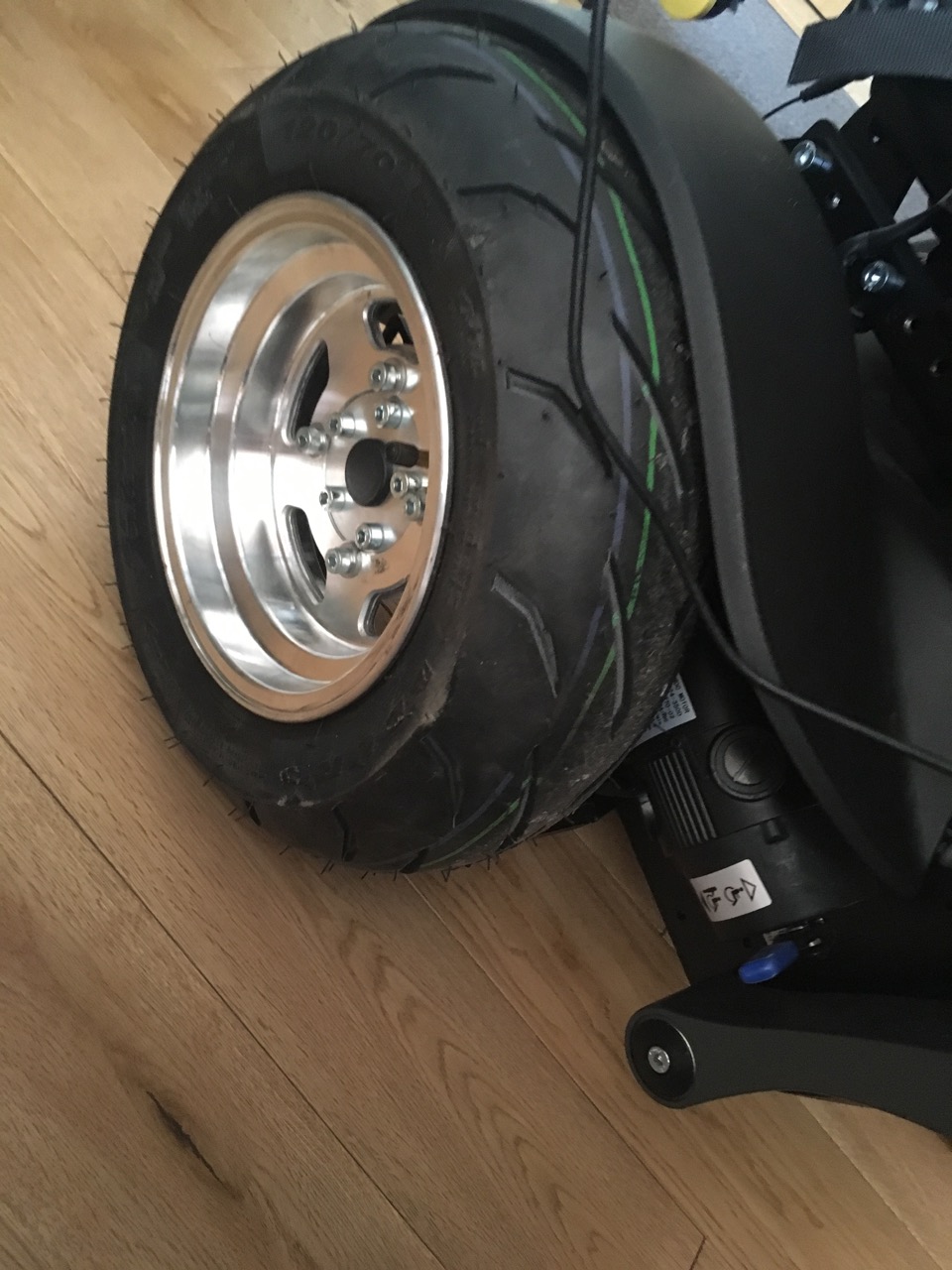

Postby wheelie junkie » 19 Apr 2019, 17:46
Got them fitted, with 5mm clearance to motor 70cm wide, armrests are 68cm so not too big a difference. Just got to get this pressure sore healed to try them!

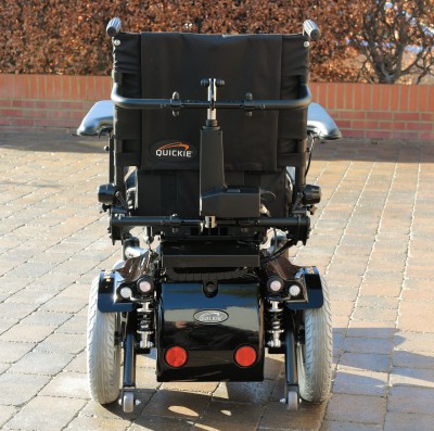

Picture of full chair and model would be nice!

Still got to swap the fronts, that is my night shift support workers job tonight. Black, tubed tyres to replace grey stock ones. More work to do before photos, trying to get a central footplate, don't know how much shorter it'll be as the casters touch my heels now if tilt is level.
Is 70cm a reasonable width? Really looking forward to getting outdoors in it.
