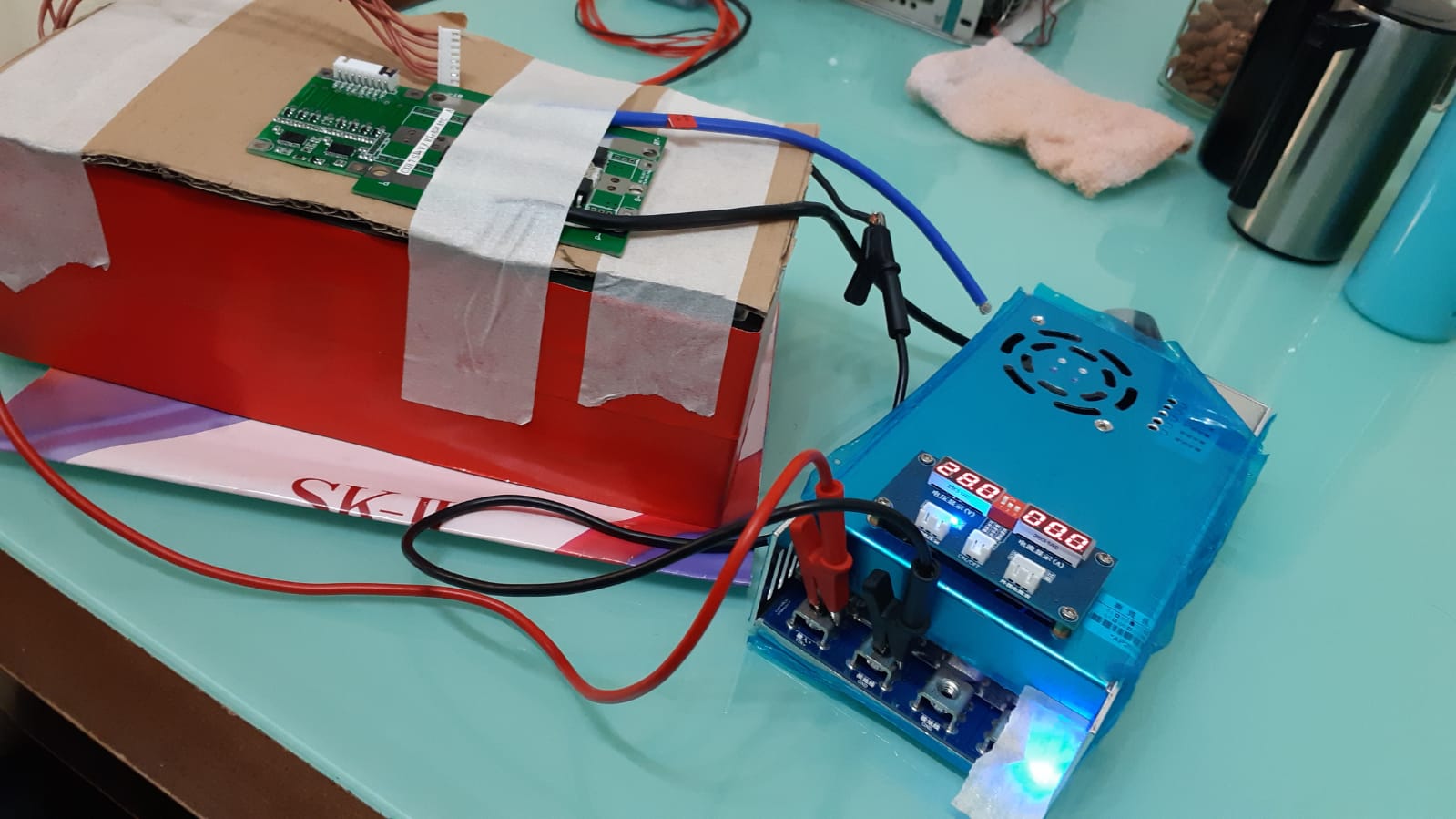

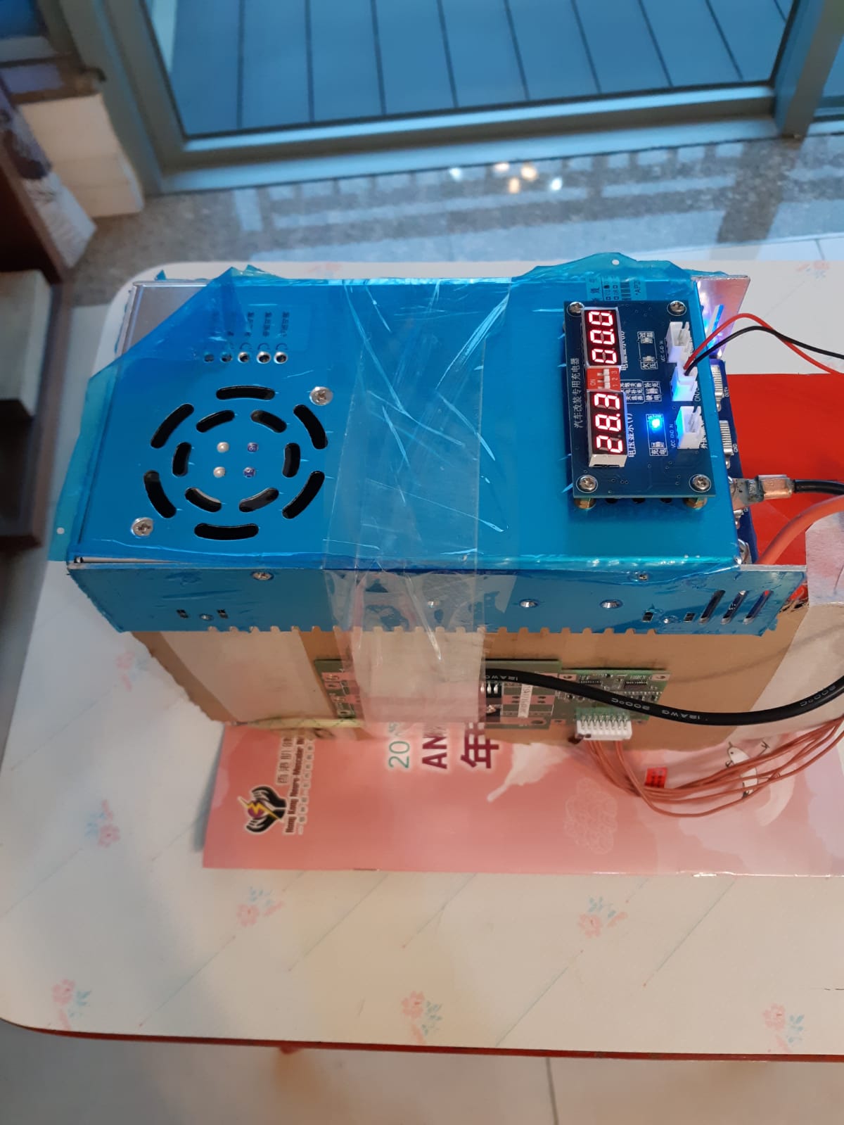

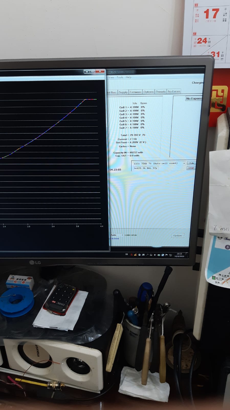

Postby shirley_hkg » 13 Mar 2019, 02:56
Got started on this project, finally .
Postby shirley_hkg » 13 Mar 2019, 03:13

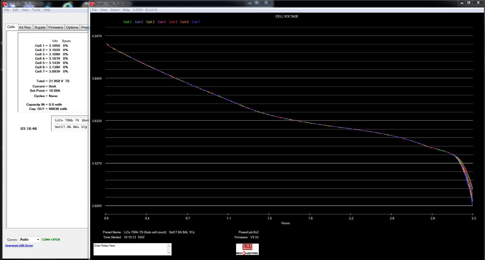

7 cells cost £117. :fencing
Delivered : 66836 + 445 = 67,281mah. (96.1% as capacity claimed) . :clap:
Put back : 69237 + 538 = 70,775 mah .
Note all lines stayed together . Balanced only in minutes . cheers

shirley_hkg wrote: Got started on this project, finally .
Cardboard has good fire resistance properties :thumbup: :ambulance
shirley_hkg wrote: 7 cells cost £117. :fencing
Nice graphs :thumbup:

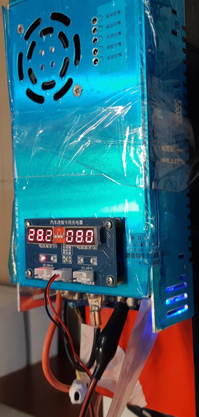

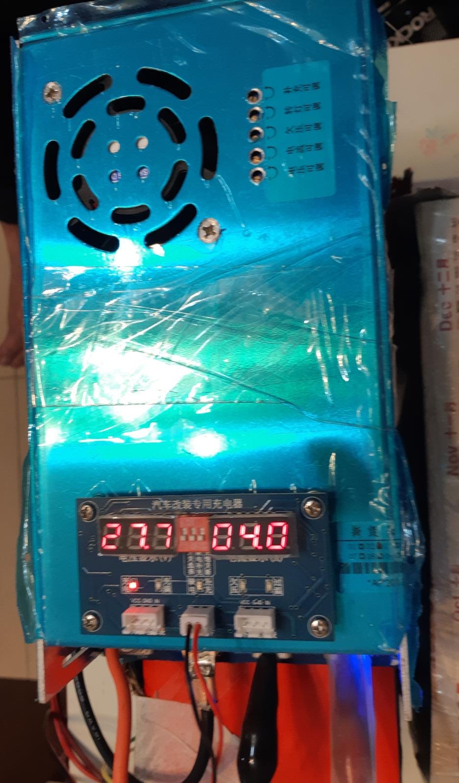

Postby shirley_hkg » 21 Mar 2019, 03:00
Testing various charge rates .

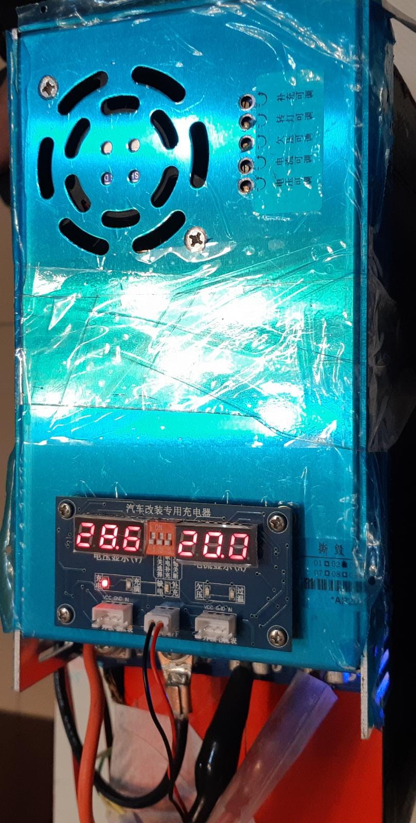

Postby shirley_hkg » 21 Mar 2019, 03:04
:wave:

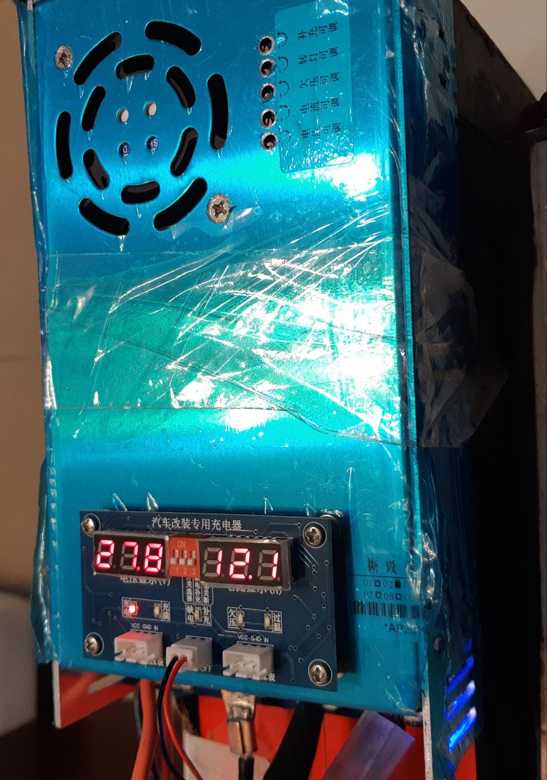

Postby shirley_hkg » 03 Apr 2019, 14:58
It's another adjustable CC /CV 3-stage charger … module , only that it is powered by 20-30V dc.
Postby ex-Gooserider » 10 Apr 2019, 08:18
Wouldn't it cool better if you peeled the blue plastic film off the fan holes?
